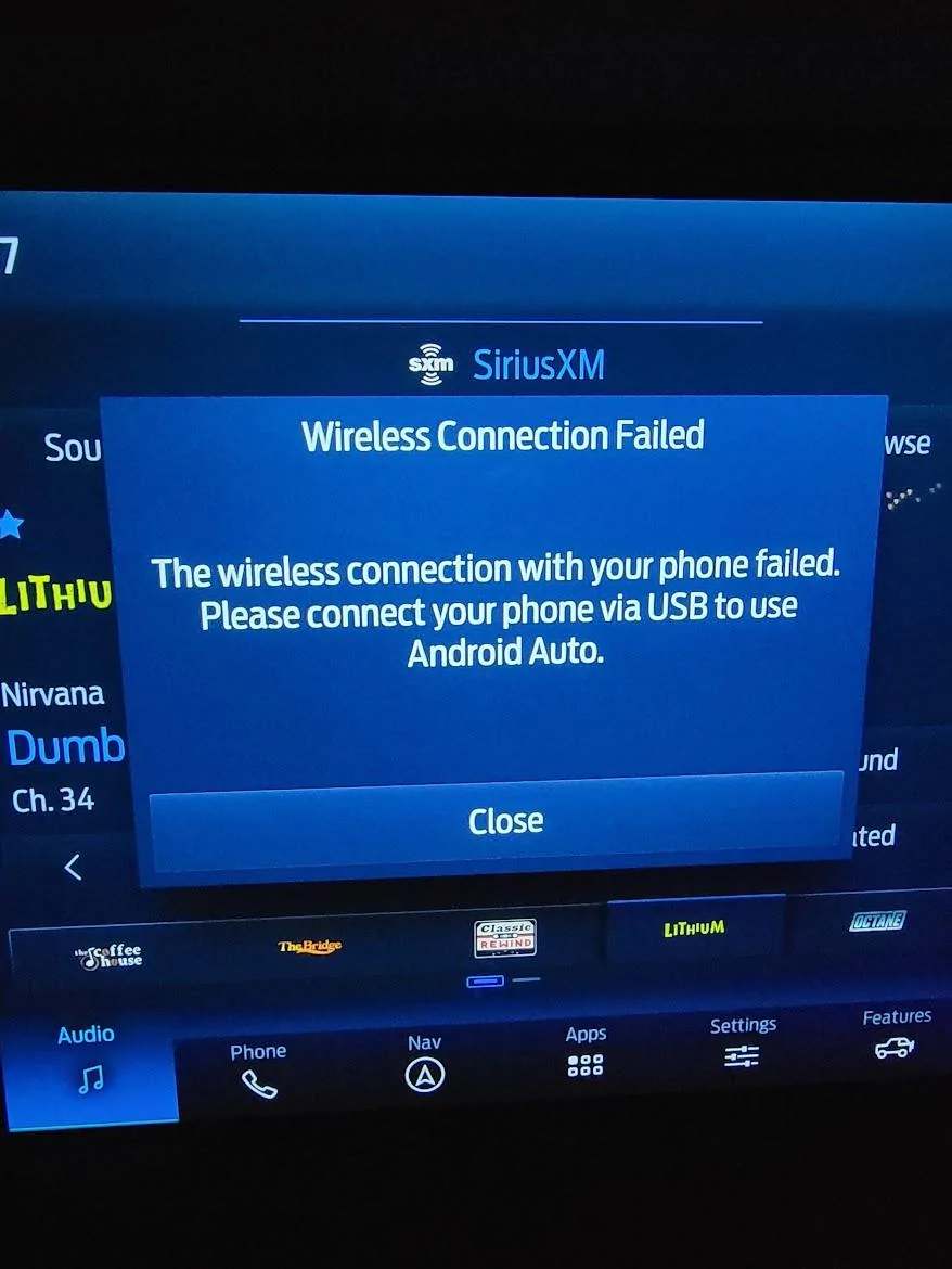

I just bought my '23 Bronco yesterday, trying to use wireless Android Auto with my Galaxy S21 Ultra, and I'm already seeing the following error roughly 50% of the time when I start up the truck. I have to play with the AA settings and reboot everything on both sides of the connection to eventually get it to work.
The other 50% of the time works without any issues whatsoever. No obvious cause or difference.
Lame af.

Had to change my selection. Had no issues until today. Carplay wont connect, wired nor wirelessly. 12” screen. Same message as shown above but for carplay.
