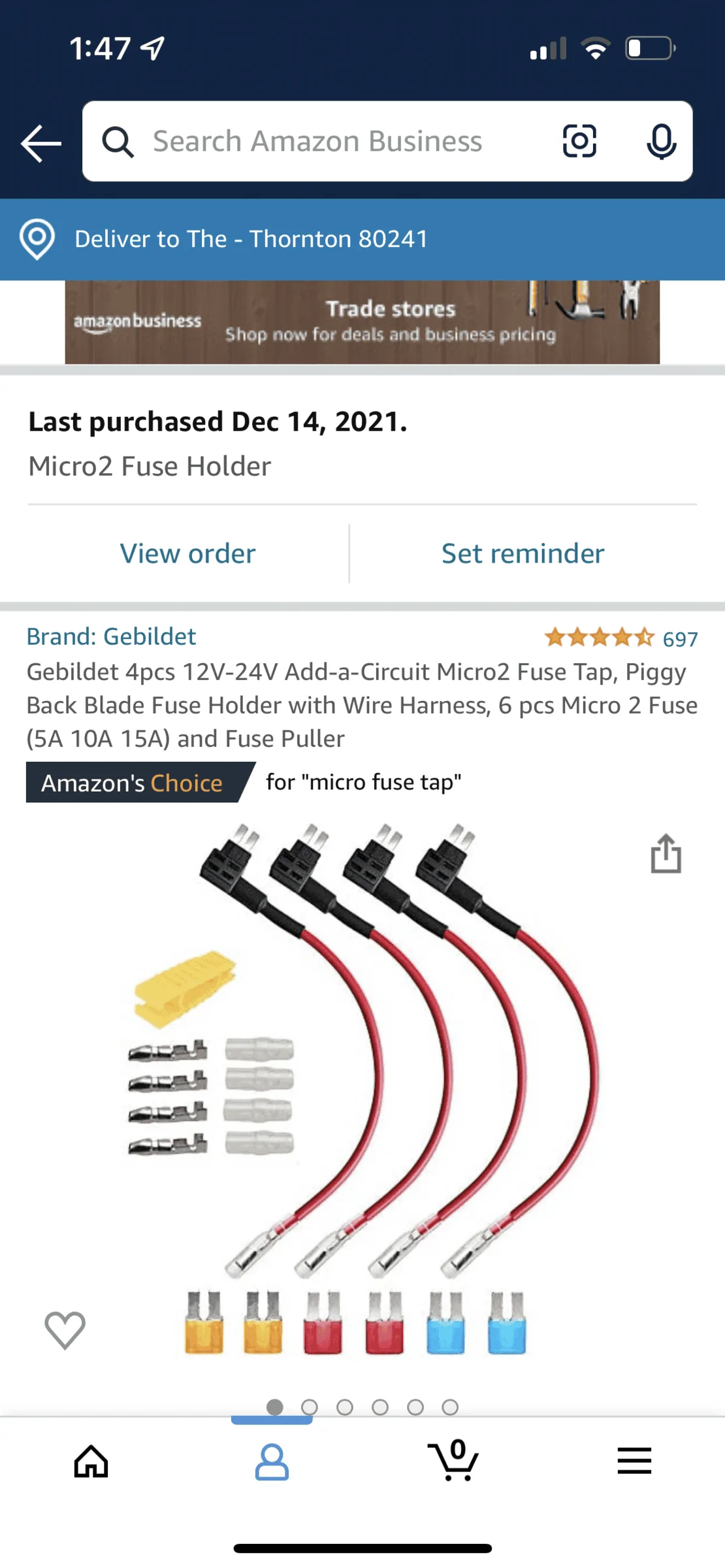

Can you add a link to the 'add a fuse' you used? I've bought two sets off of Amazon, Micro 2 & 3 and they do NOT fit into the fuse box.
Ford service, and Napa couldn't help us out, either. They say it's brand new
Really? I am sure I used Micro-2.
These are the ones I referenced in my post above.

Help please! I’m trying to hardwire my dash cam (Rex 3) to the fuse panel under the steering wheel.
why on earth did Ford have to make such impossible to deal with or find fuses!?
I can’t find an adapter or something to work.
I am a newbie at this and appreciate all the help.
I posted a thread all about it -- I can link the add-a-fuse tap I found on amazon if you'd like?
https://www.bronco6g.com/forum/thre...-interior-fuse-box-with-add-a-fuse-tap.32486/
edit: @2Jeeps&PatriotX1 already did so above 😛
