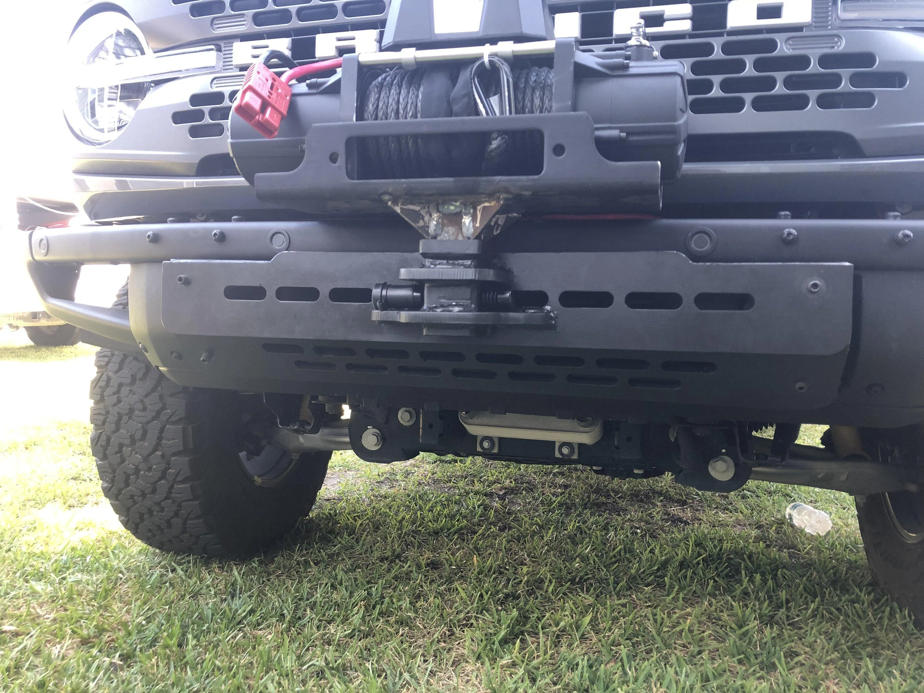

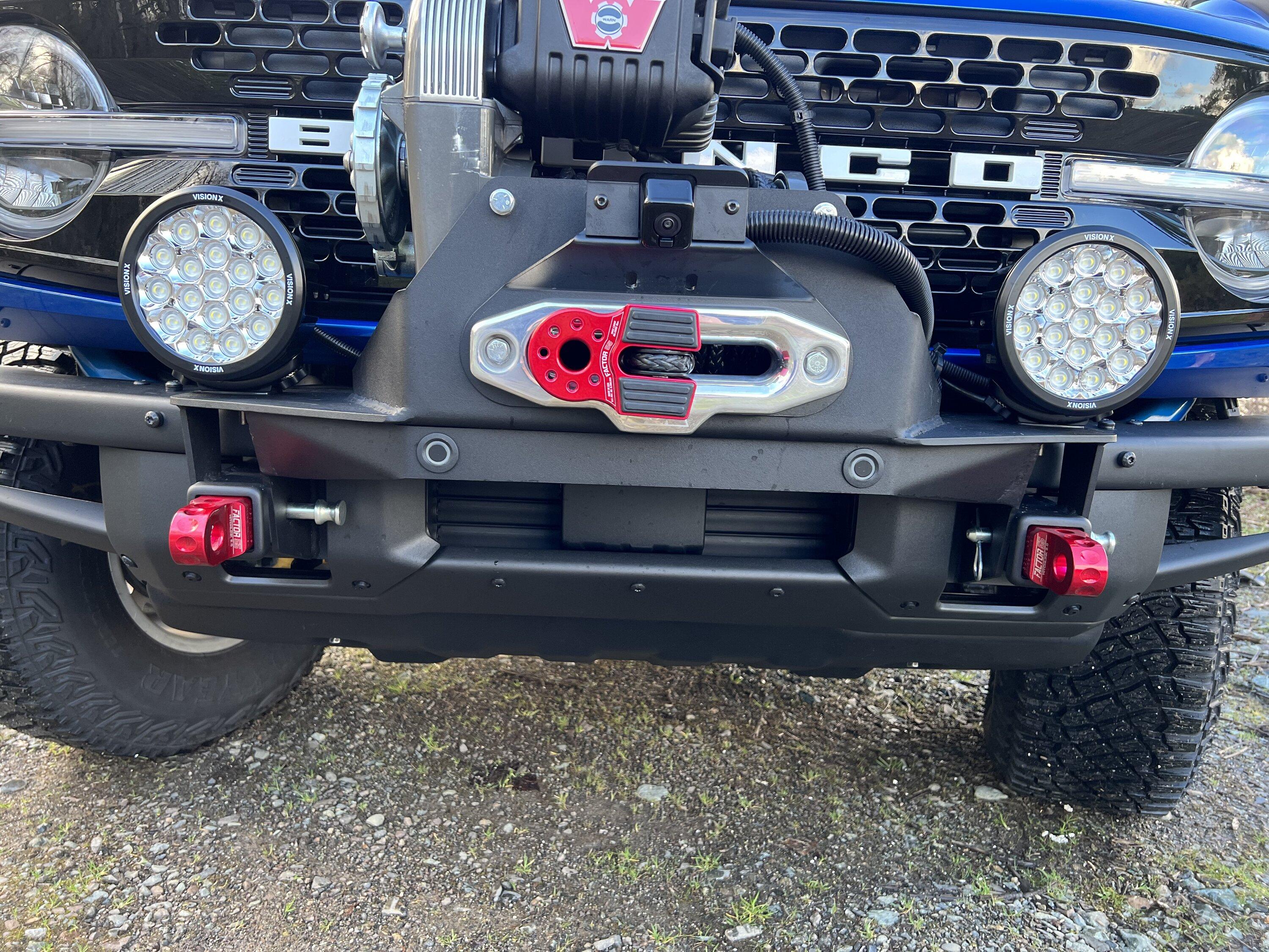

Yep, my custom winch mount has two 2" receivers, Factor 55 shackle mounts or a ball mount fit. Lots of reinforcement behind the frame horns.
You could forgo the winch on top and build a double receiver removable winch plate. This would be a lot stronger for side loads than a single mount

I would LOVE for someone to make a 2” hitch that is a direct replacement from the front shackle mounts on the modular bumper.

This is a great setup. I would like to have a winch part time not full time. I wish someone would sell something similar. I think that there would be a market for it. Keeping the stock bumper is a big plus too.

I had a crazy idea and I found a crazy enough fabricator to make it into metal. Not inexpensive, but not another one like it.

Great design and execution. Looks professional. If I ever get a Bronco I may eventually look into something like this.

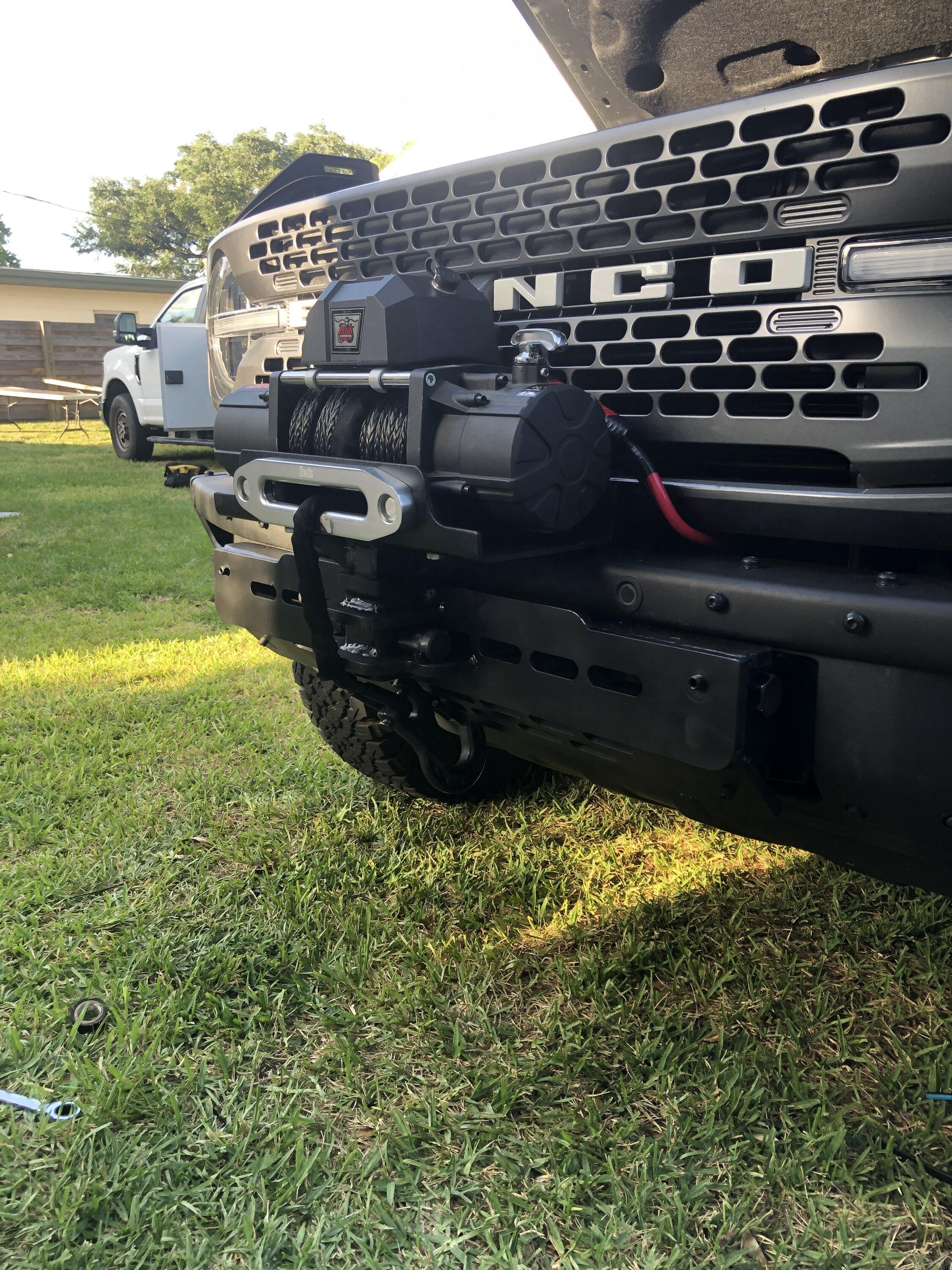

I had one fabricated with a vertical 2” receiver to hold my winch. Bolts on to the steel bumper recovery points.
Ford Bronco Anyone Installed a Front Mount Trailer Hitch Receiver? 7DA1C39E-0178-4FDE-80B5-5E1D4E8711AA
Looks great. I would worry about my airflow to the lower intercooler and I have that ADD thing down there, can’t block bottom.
