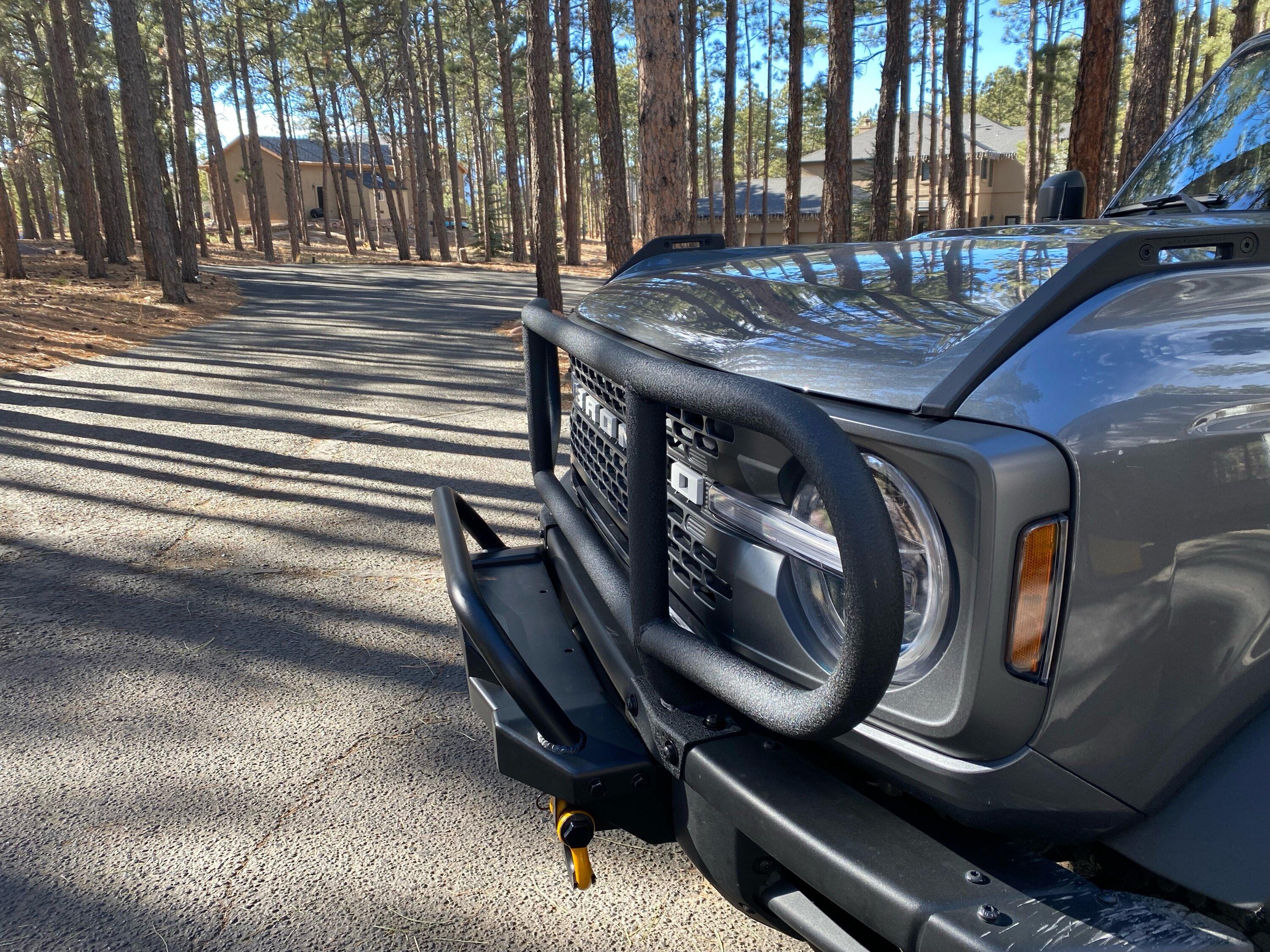

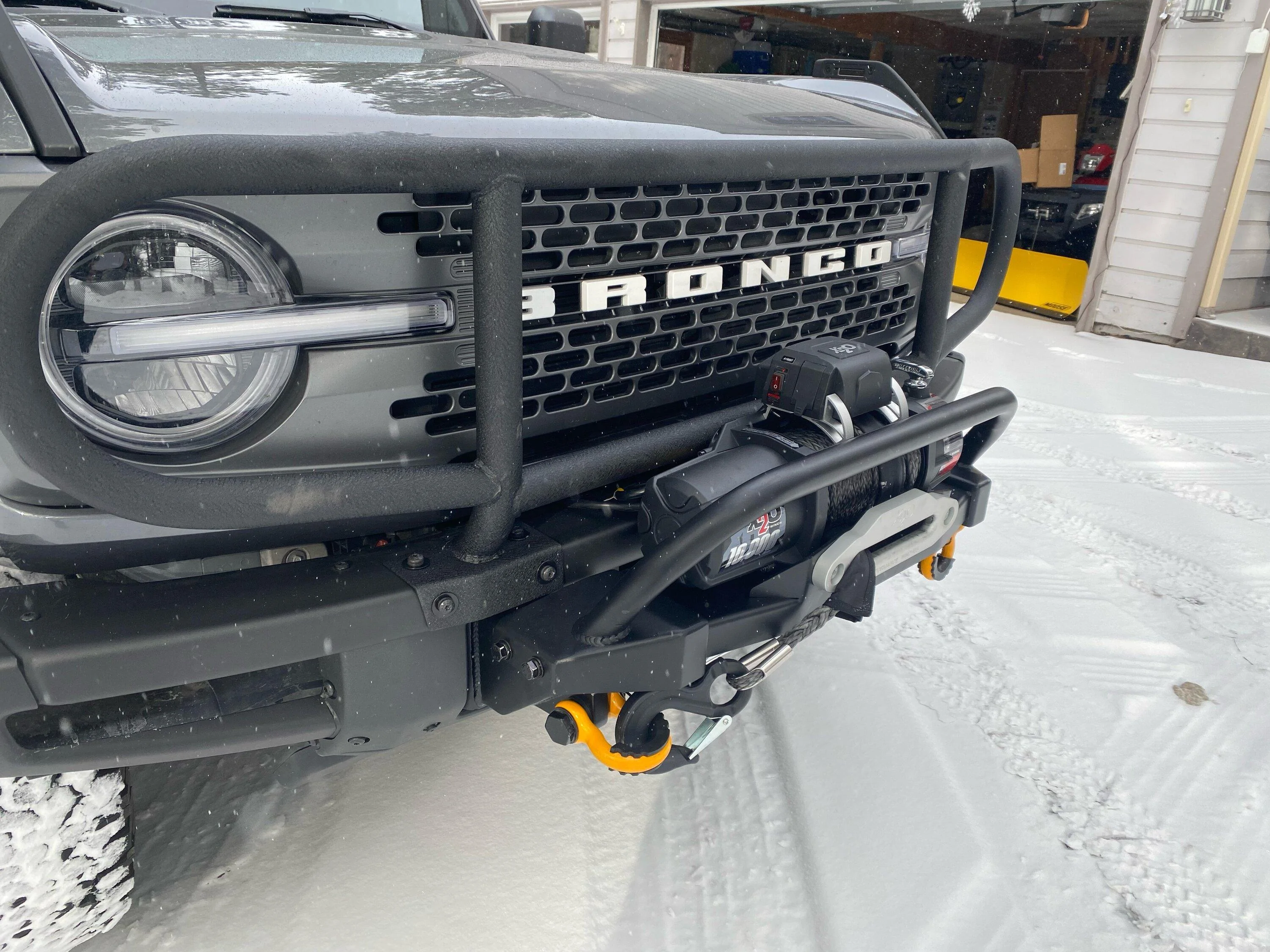

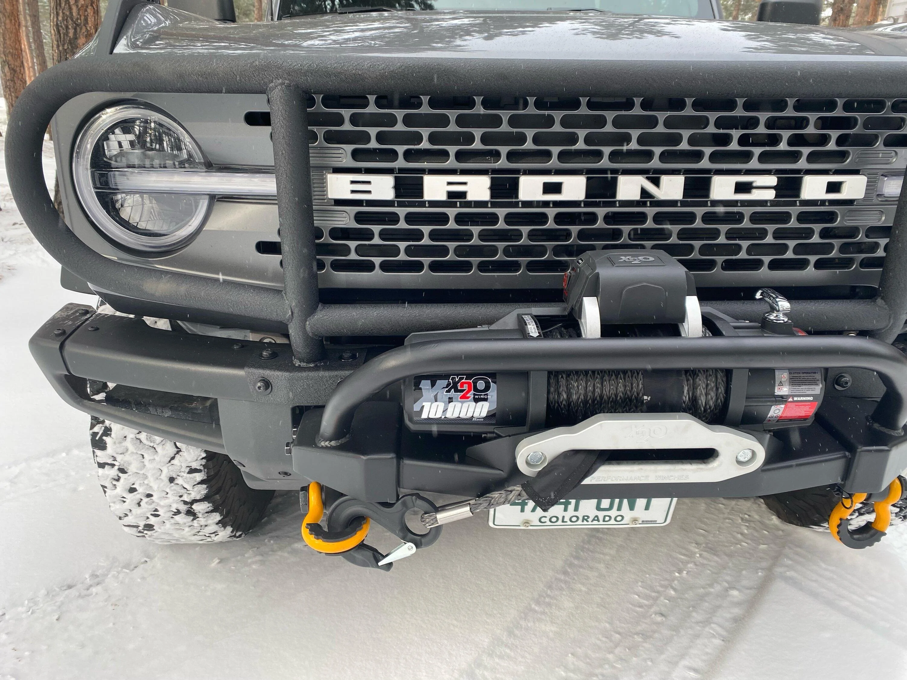

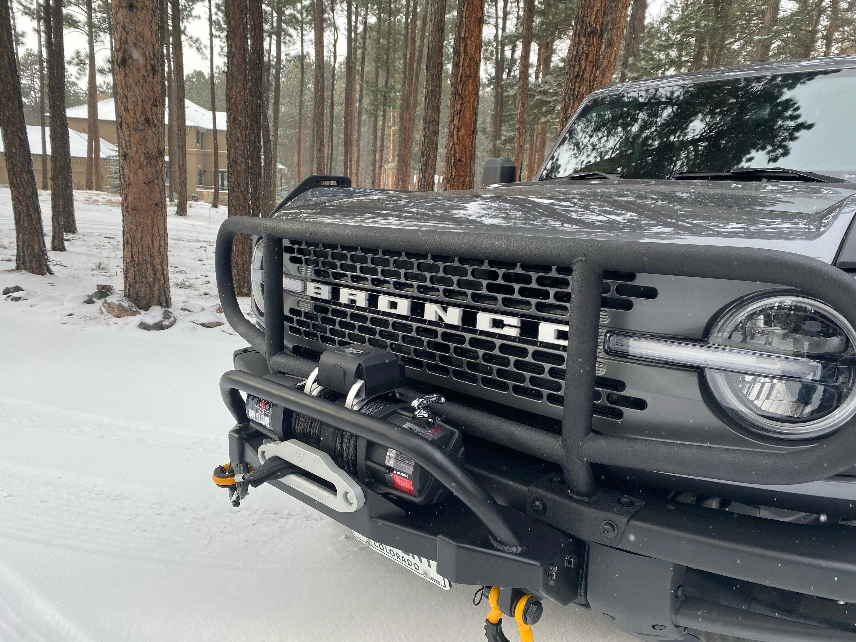

Love mine so far. No complaints, and my Smittybilt winch fit like a glove.
I have the mid package, so I didn't have to worry about ACC or a front cam.
The first winch plate IAG sent me was damaged, but they quickly replaced it and sent me a shipping label to return the first one. Only set-back was one week.

It looks to be better quality than the rough country ones I see. Although lower a bit. Would you take a picture low and to the side so I can see the approach angle? Thanks!

@Silver&Black_Bronco that looks great man! I am feeling better and better about going this route. I think the biggest unknown for me is if the BADLAND fairlead will mount right up to the IAG holes. I couldnā€™t find the IAG dimensions, oh well Iā€™ll figure it out.
