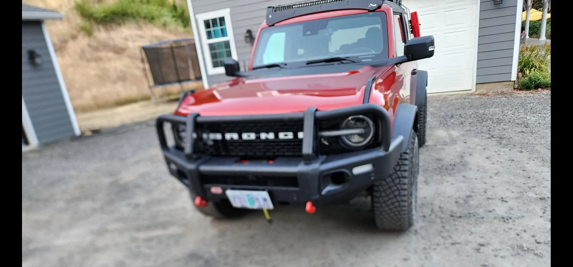

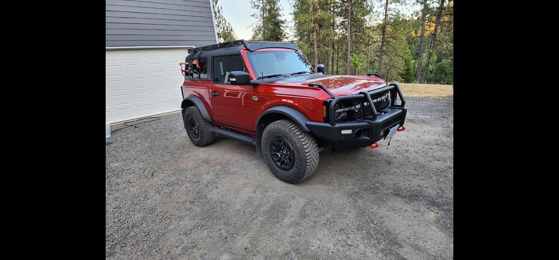

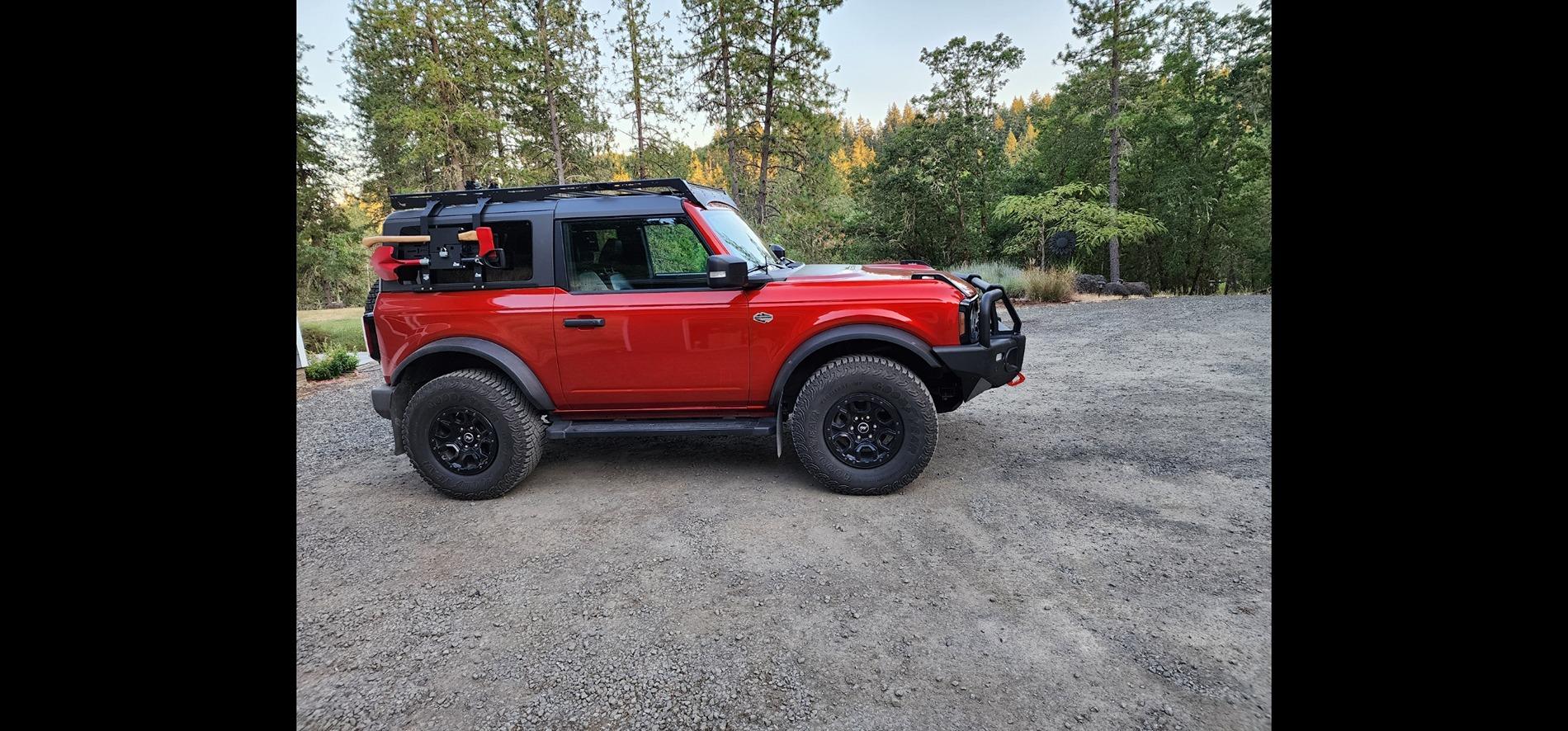

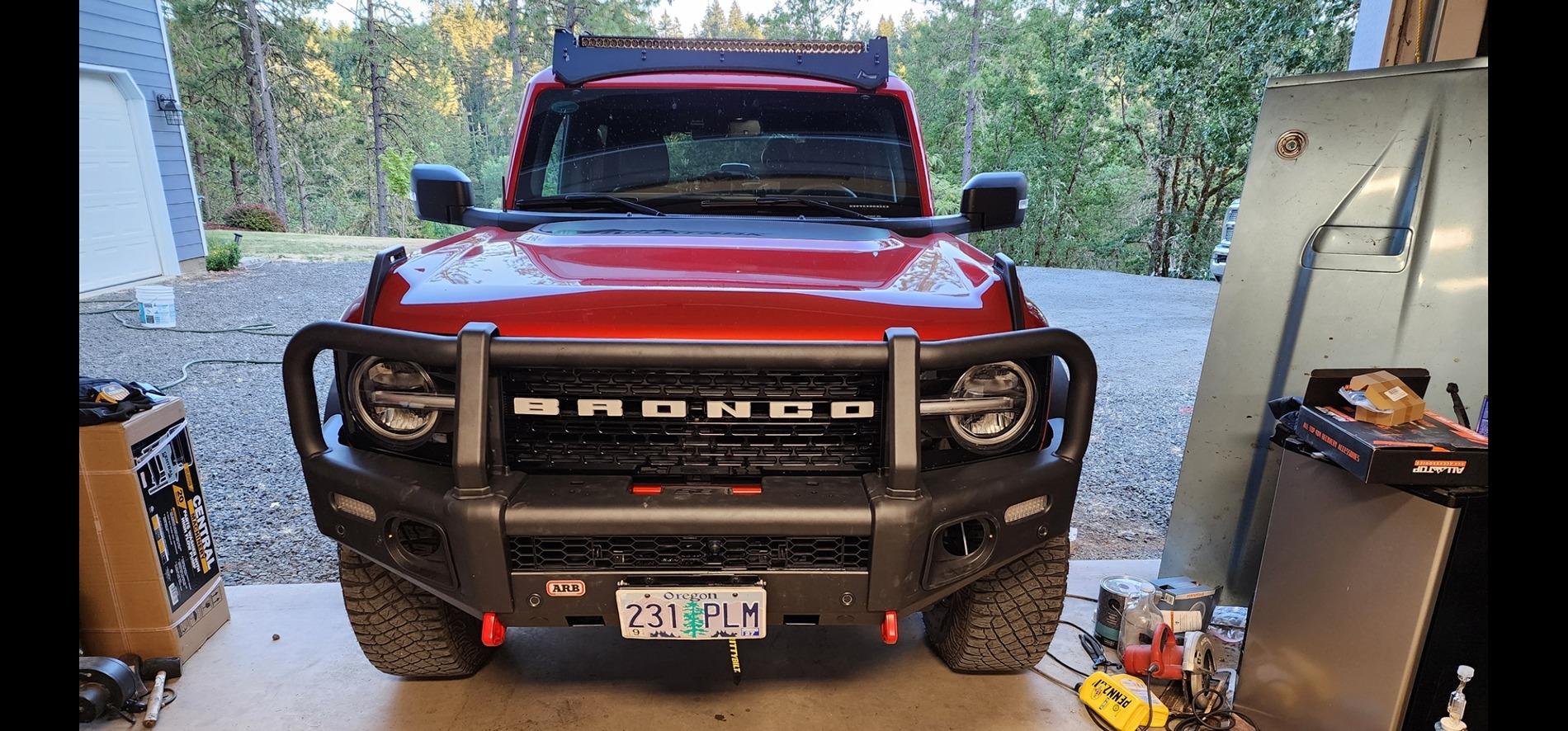

Well I'm done. Finally.
Not sure I would go with arb again. Given the directions, wrong parts, and general pain in the butt that was the install.
There is definitely some steps in the directions that need to be explained more thoroughly. As well as in different order. (Fairlead after winch install)
I also had a few missteps that would take a long time to rectify. For example, I dropped one of the plastic caps for the bumper hole behind the bumper. It ended up in the intercooler shutter. Luckily I have a fiber optic camera that I was able to see where it went.
Now I need fog lights.

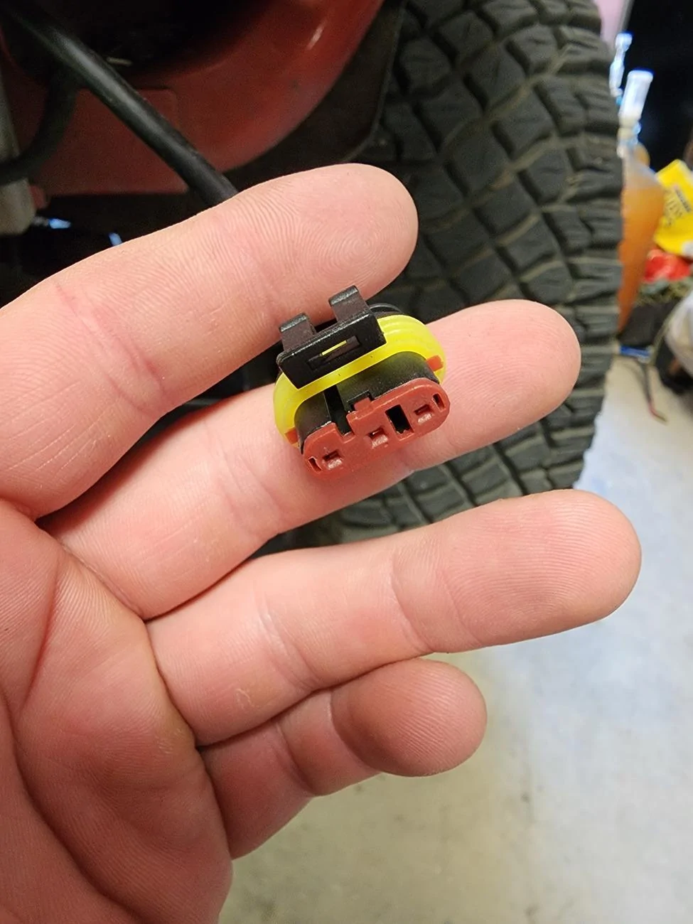

This install is never ending. The drivers side turn signal on the bumper is not working.
I suspect there might be a bent pin. The plug had a red piece of plastic that came off in the plug. I used. Needle nose pliers to pop it out.
Also, the factory tubing for the front camera washer needs to stay intact. There must be a checkball in one of the fittings. I took them all off and it pretty much flowed non stop.
I though the camera broke. Since it had a wierd distortion on it. Turns out it was just the washer fluid flowing over it.

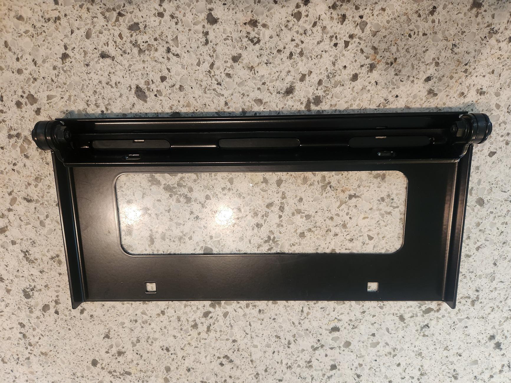

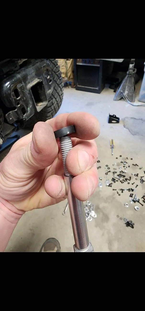

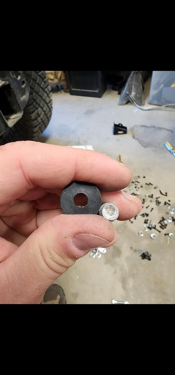

Figured out that I have 4 washers that are 1mm less than the rest.
Now I'm trying to figure out how the 6mm nylon packer is supposed to fit onto the m10 bolt.

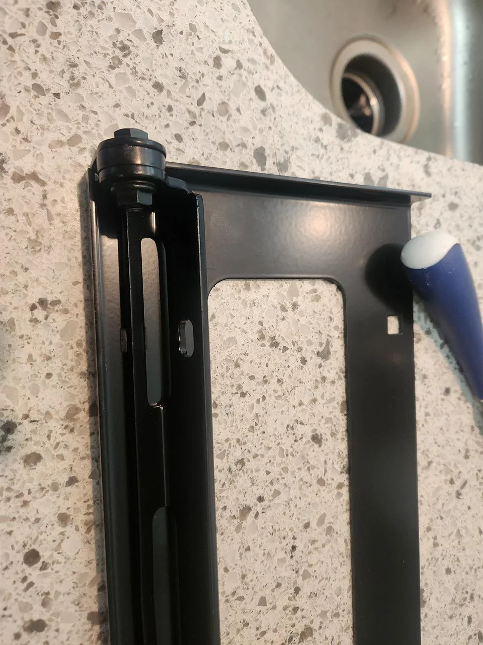

I am going through and sorting out all the hardware before my install tomorrow and I remembered seeing this. Here is what I think is going on:
The black M6 nylon packers (Part#5848302) you have pictured above are to be used in step #48 between the large and small license plate brackets. (pics below)
The M10X 6MM "packers" are not labled as such in the directions. I think they are refering to "WASHER FLAT M10x24x6" (Part #4584394). Could not find anywhere where it said that the M10 X 6MM packers were made of Nylon (the M6's are. ) Those washers are M10 and are 6MM thick so that is the only thing that makes sense to me.
Yep, I think I figured it out on page 2 or 3.
They were they only item listed on the inventory as "packers"
Which was utterly confusing. Since packers is not a term I had heard before.
Spacers, or washers would have been more helpful.
Eta, when I called arb tech support. Based on my description of a m6 nylon packer. They told me it was the wrong part and to go ahead and drill them to fit m10.
Pretty sure he just wanted me off the phone. And pro tip. Do not do the install right before a holiday. They closed on Friday and no answer on Monday. I spent a couple of hours on hold.
