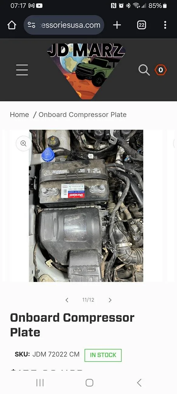

Thank you everybody for the suggestions. It gives me a lot to think about. When I go out on one of my adventures, it is anywhere from two to four weeks and resupplying is not always convenient. I am used to running with a 02 Supercab Ranger with a 6 foot bed. The refrigerator is up front behind the seat on a platform I built along with the non-refrigerated food. Now, I have a 6 foot space that is narrower. It will need to hold everything that I need including the refrigerator and food. I am going to need to change how I pack and camp, so space is going to be precious.
Having 2 batteries is my last option at this point but is still a possibility. I want an onboard compressor so that space is going to be occupied. Putting one in the side panels is a good possibility.

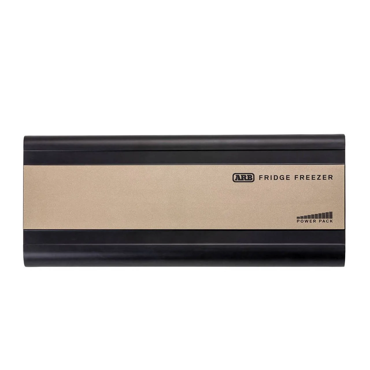

It's pretty expensive for what it is, but I was able to pick one of these up for dirt cheap when a local business was closing down. It works surprisingly well, with 18 hours of power, and takes up next to no room as it just attaches via magnets to the side of the fridge. I keep my ARB Zero fridge plugged into the accessory outlet on the daily, but switch to this battery when I need the fridge powered for any length of time when the vehicle isn't running.
ARB Fridge Power Pack

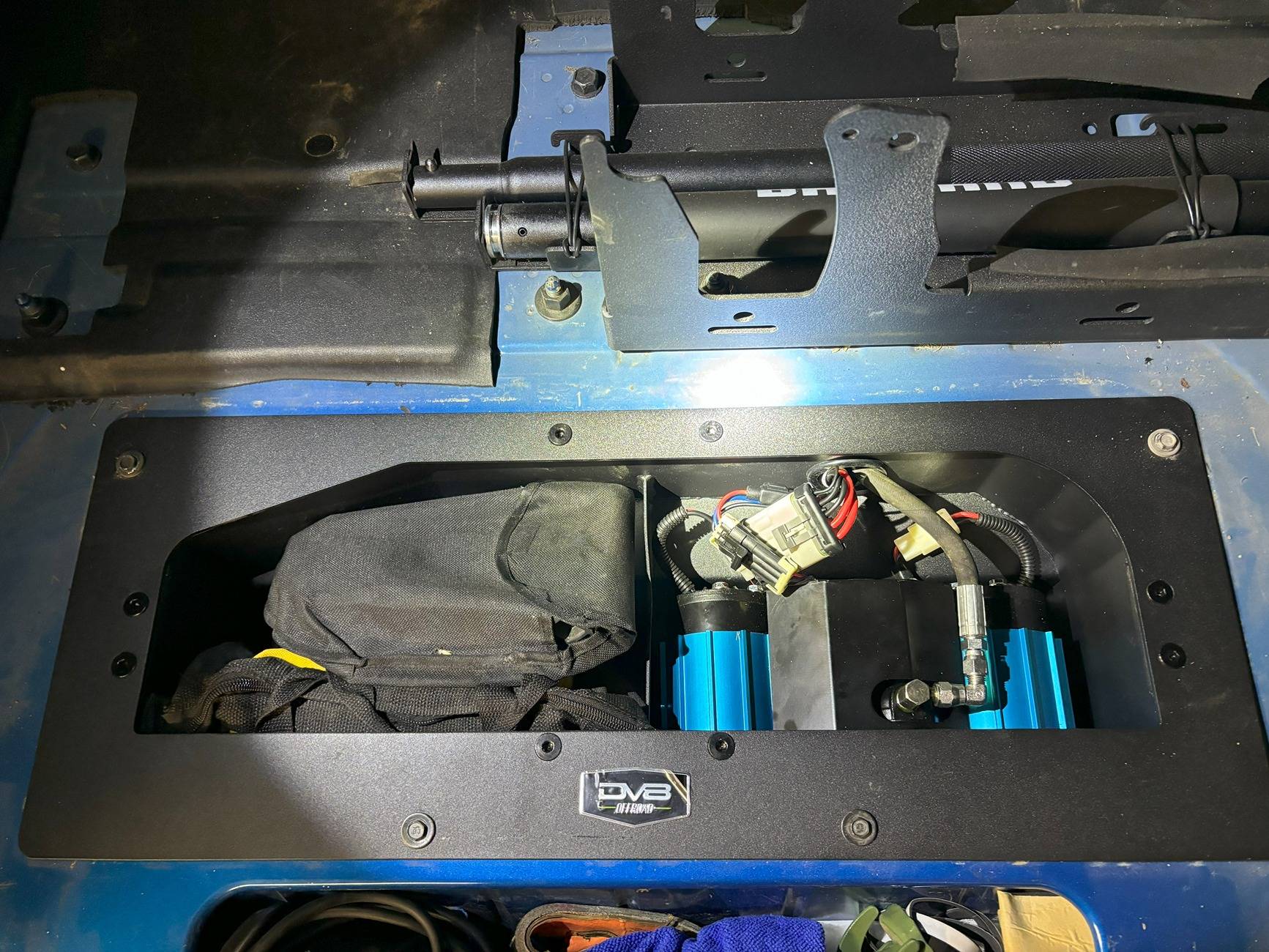

There is the DV8 option to replace the little plastic ice chest below the rear floor and install a basket that mounts the ARB twin compressor. You can then run the wires up and around to mount somewhere on the interior and run air lines to the exterior. You never need to lift the lid to have a compressor available. It could allow you to utilize the room under the hood for a second battery. 🤷‍♂️
