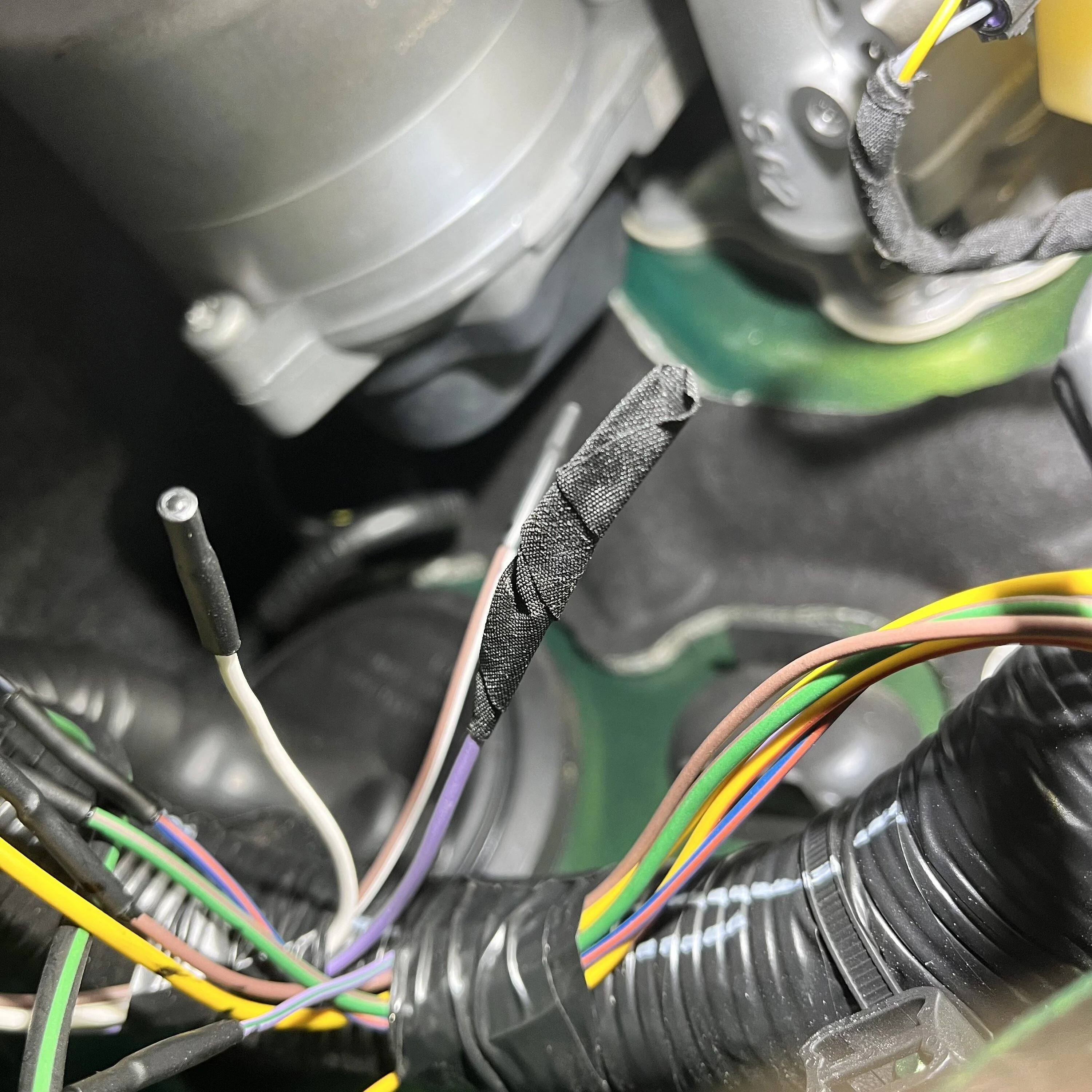

Ironically I can’t get my switch to work.
I installed my ditch lights. To make sure the lights work I tested against the battery. They work.
I want to use Switch Three which I understand to be the Violet/Green wire (taped up here) located driver side cowl.
Ford Bronco Auxiliary Switch Issue 39B9E29E-481D-4435-A398-FA3B4E476666
If I ground the ground wire (black) from the light and connect the power wire (red) from the light to the violet/green wire nothing happens when the “key on” or engine running when I flip Switch Three (or and switch).
What am i doing wrong?

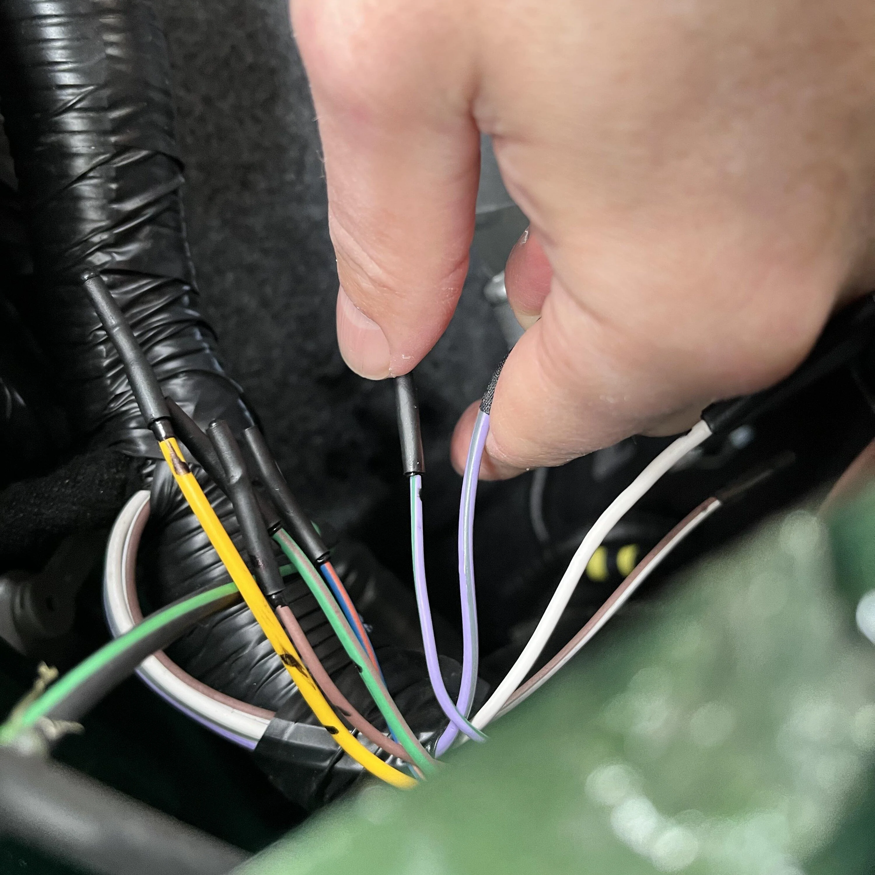

Are you sure you have the right wire? Violet/ gray is the wire going to the grill vs violet /green.
You know, I don't know if I have the right wire. Grey and green look similar.

Ford Bronco Auxiliary Switch Issue 85BE893E-4A05-4807-9C2E-8271D605CB15
See if you can pick out the violet/grey vs. violet/green.
Anyways, that was it. Now in the light I can see the auxiliary wire routing better and won’t make the same mistake next time. Probably. Maybe. We’ll see…
