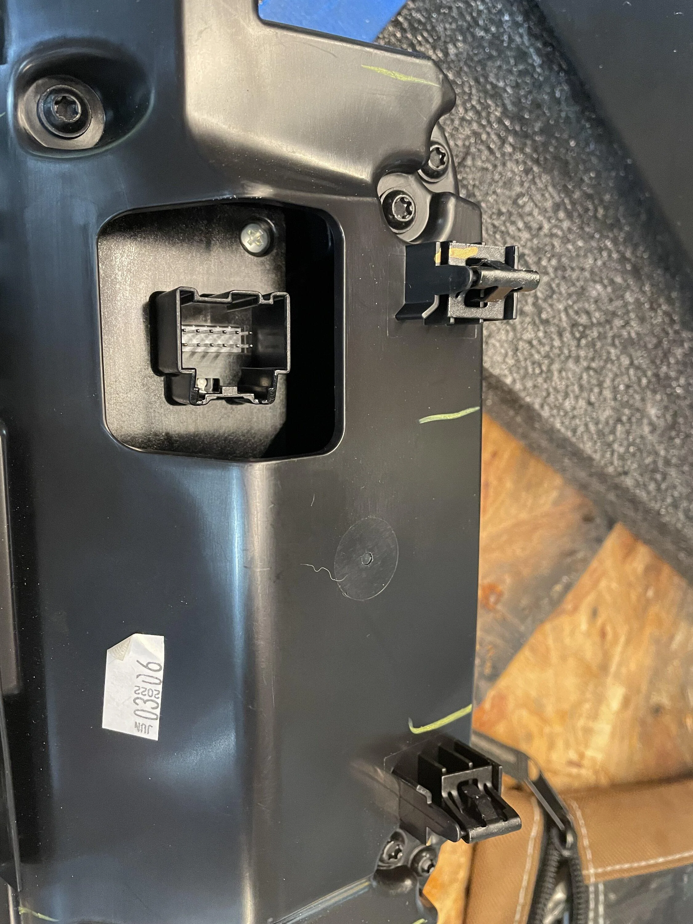

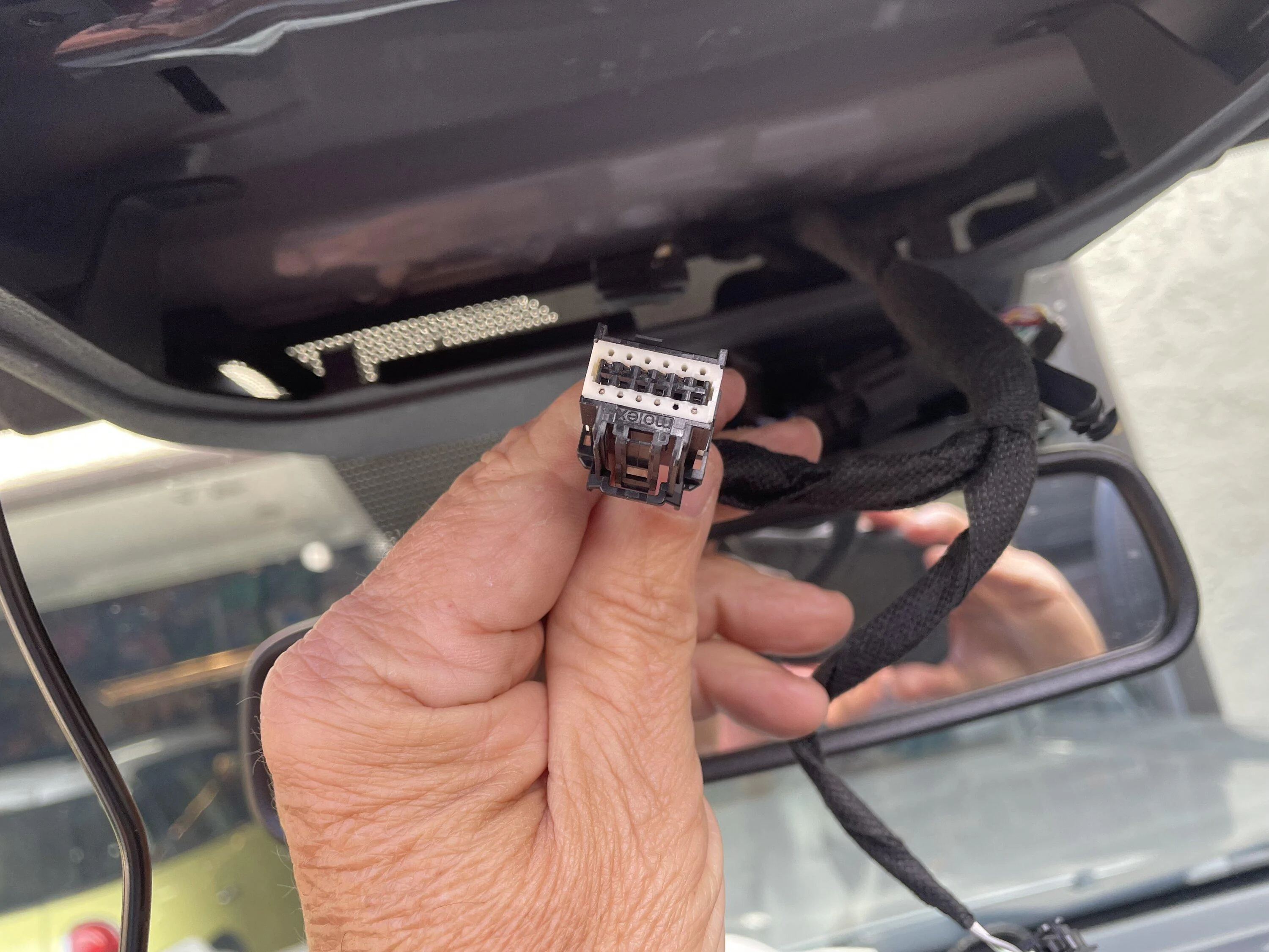

Anyone have the Auxiliary Switch plug pinout at the switch box itself?
Ford Bronco DIY- Auxiliary Switch plug pinout ? IMG_1813
Ford Bronco DIY- Auxiliary Switch plug pinout ? IMG_1812

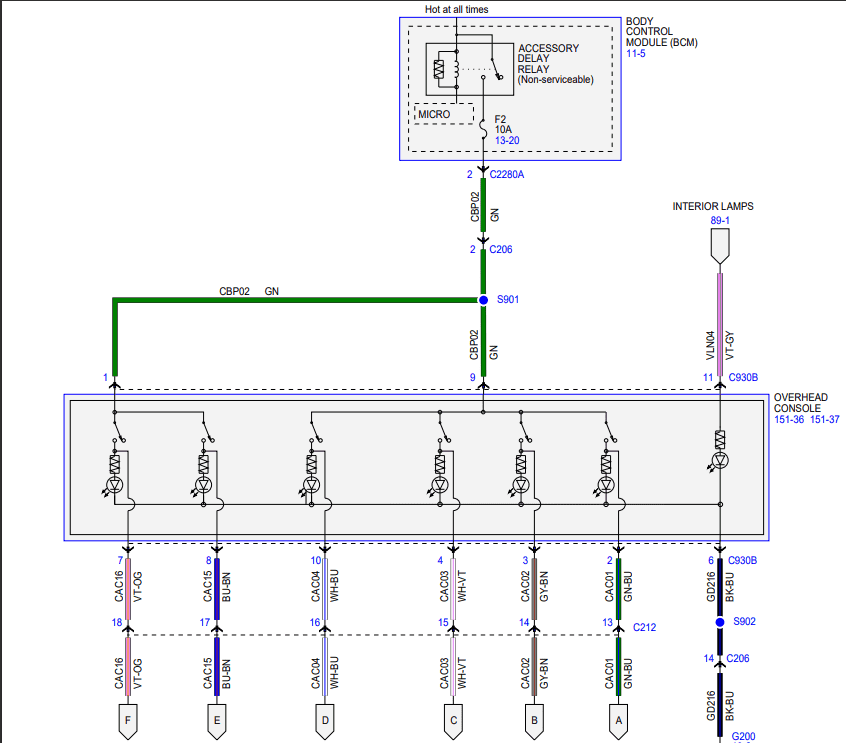

Try this. There's a copy of the factory service manual floating around this forum, though it's incomplete. Unfortunately whoever created it used the page titles as filenames and a good portion of it went beyond the 256-character filename limit so the files are empty -- including the one specific page I needed.
Ford Bronco DIY- Auxiliary Switch plug pinout ? SIMA
Someday I'll pay for 72-hour access to get the missing files. They'll need to be renamed because the current archive out there, you end up with filename+path like
C:\Users\user\Desktop\Bronco\Service Manual\4- Electrical\15- Information and Entertainment Systems\415-00 Information and Entertainment System - General Information\Description and Operation\Information and Entertainment System - System Operation and Component Description G2225614.pdf which is way too long and explains why a bunch of files didn't save properly.

Ah, perfect. That confirms what I have seen using my fluke. The green being main power which behaves the same as the accessory function.
