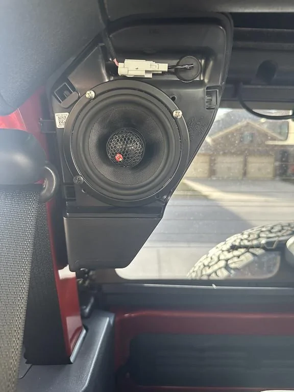

I finished upgrading all of the speakers, except the subwoofer, in my B&O system. I used Hertz 100.3 4” coaxials in the dash corners and rear pods. I used Hertz 165L 6.5” midbass in the kick panels and a PRV 4” midrange for the center.

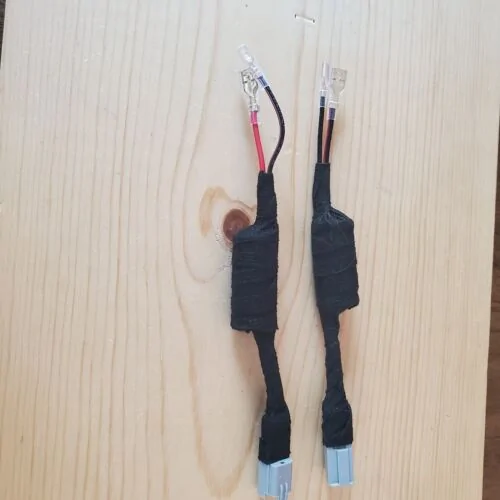

I got harness adapters for all 7 speakers from eBay seller FastDaddy. I went with 300hz bass blockers for all 5 of the 4” speakers. Note: These specific Hertz 4” speakers have large terminals for both positive and negative, so I did have to modify the harnesses with a larger terminal adapter for the negative wire.
Ford Bronco B&O Speakers Upgraded in 2022 Bronco 1676436478493
The result is better than I expected. I would highly recommend this speaker combination. The B&O amp seems to provide sufficient power and drives the new speakers just fine. The volume levels are slightly louder than stock/B&O but with much better sound quality.
I learned so much from the other speaker upgrade threads here on B6G. Special shout out to @Ksjrb03 and @cmcbronco for their detailed and informational threads.
I used a generous amount kilmat in all of the speaker locations. I used polyfill behind the speakers in the dash and rear pods. For the kick panels, I used silicone baffles and no polyfill.
Ford Bronco B&O Speakers Upgraded in 2022 Bronco 1676436859717
Now, I need to fix the rattle in the sub. I will eventually upgrade the sub (possibly JL Stealthbox), but for now I will be happy if I can fix the rattle.

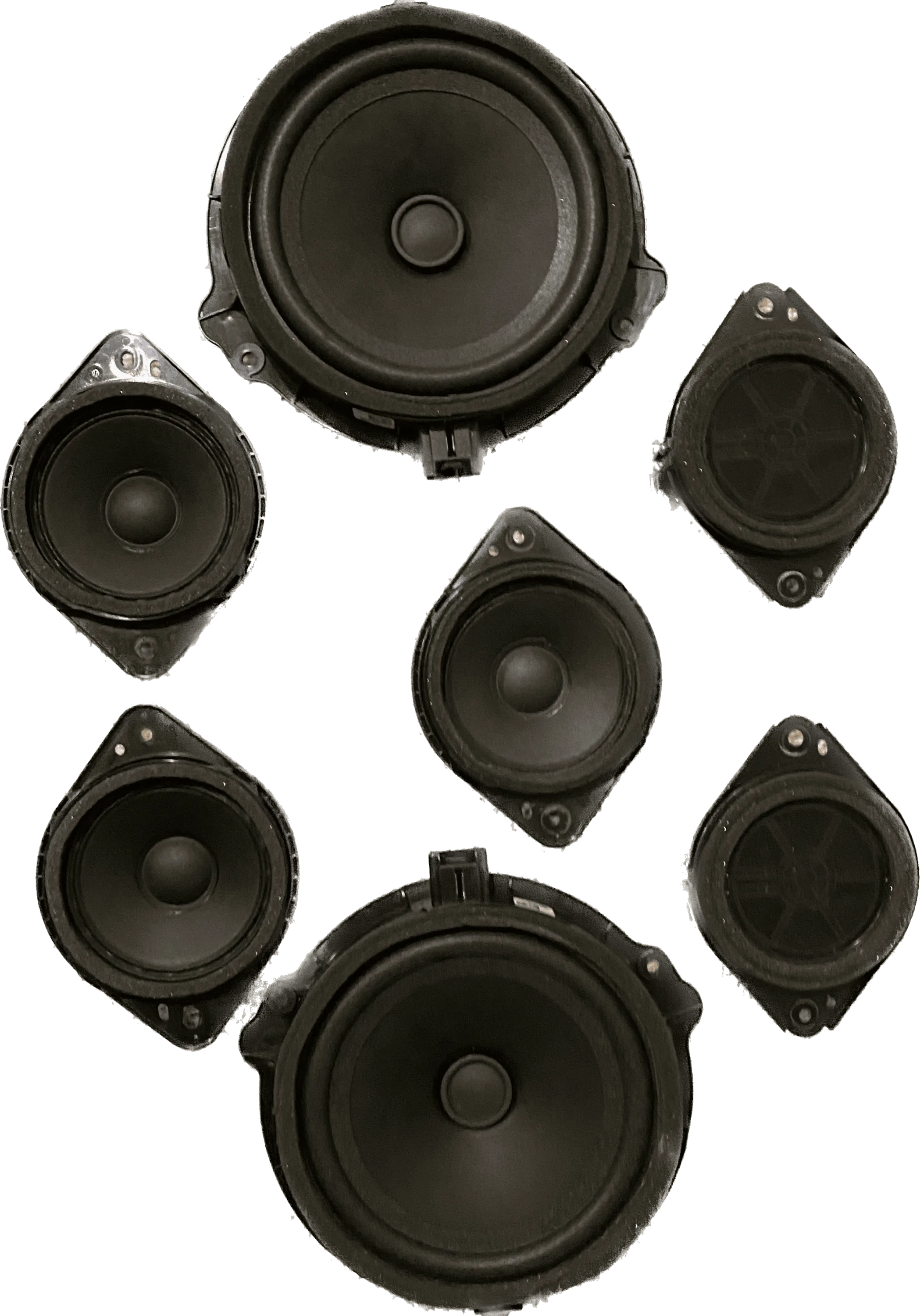

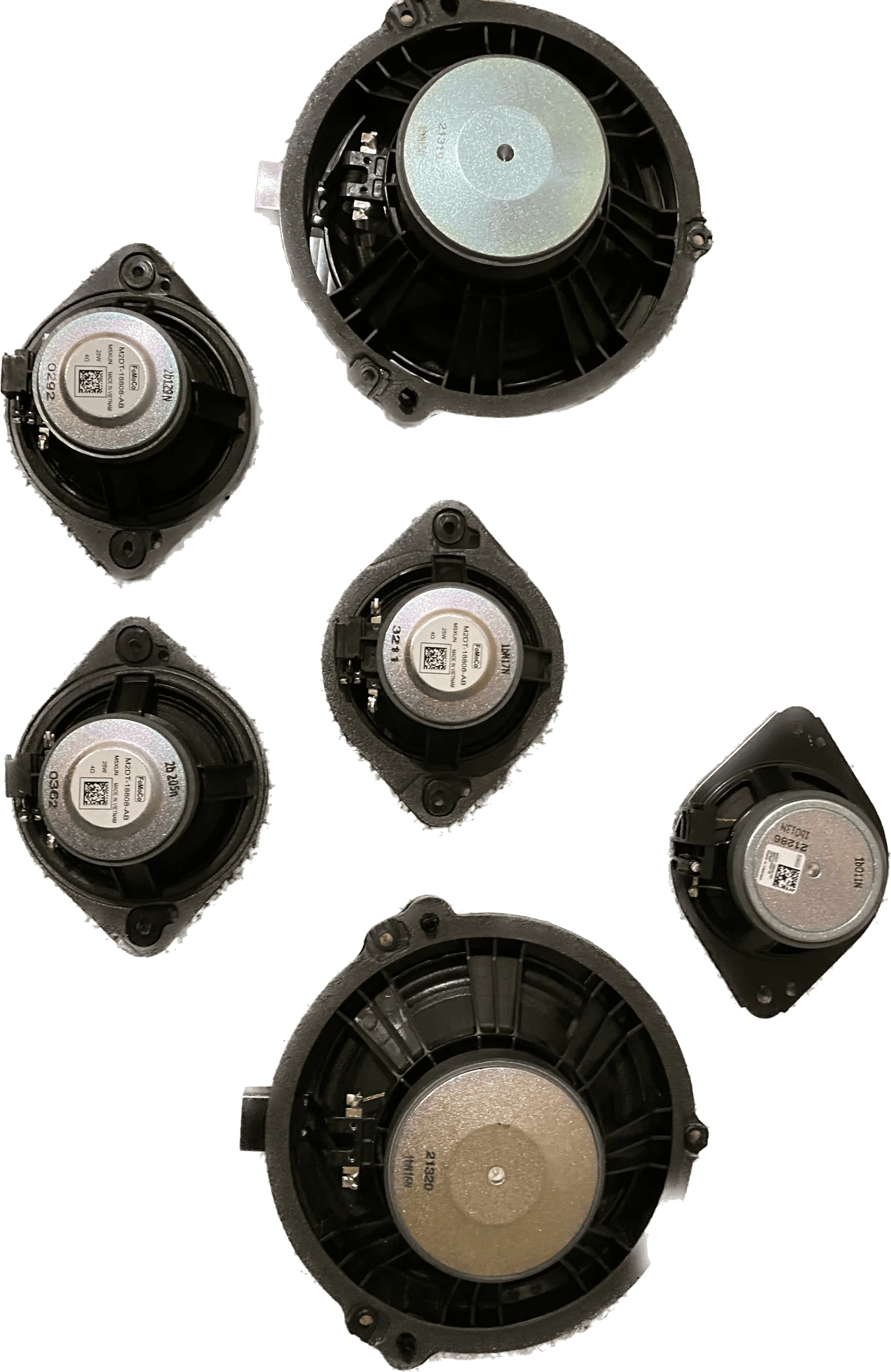

Here is a picture of the factory B&O 7 speaker set that came out of my rig. If anybody is interested, they’re now for sale.

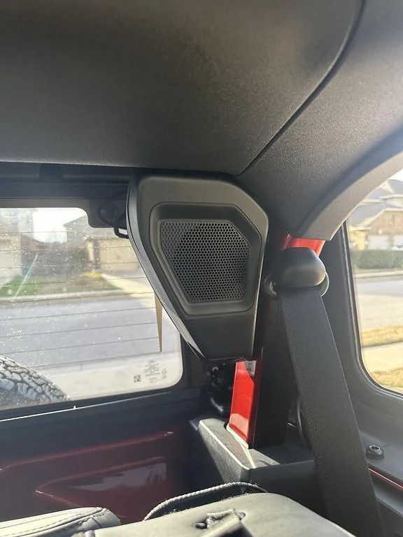

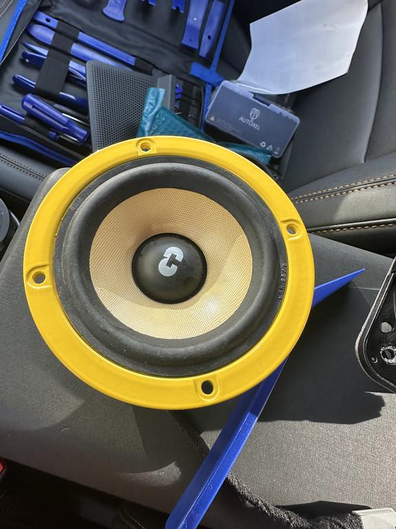

I just tried to install my CDT ES-E4X coaxial speakers in the dash and they don't fit. The difference is they are actually 4" speakers and full round metal mounting, so no tabs, like the newer speakers. I would also have to move the wiring harness that sits at the bottom of the dash speaker openings.
I was successful in getting them mounting in the rear pods on the door. The only thing I needed to do was drill 4 new holes in the plastic to attach them.
And the covers went back on with little problem.
The MTI dash adapters, say they can do a 4" coaxial, might see if they can do one for my 4" separate and I'll just mount the tweeter in the A-pillar or right next to the dash speaker inline. But $450.00 for the adapters seems a little steep.

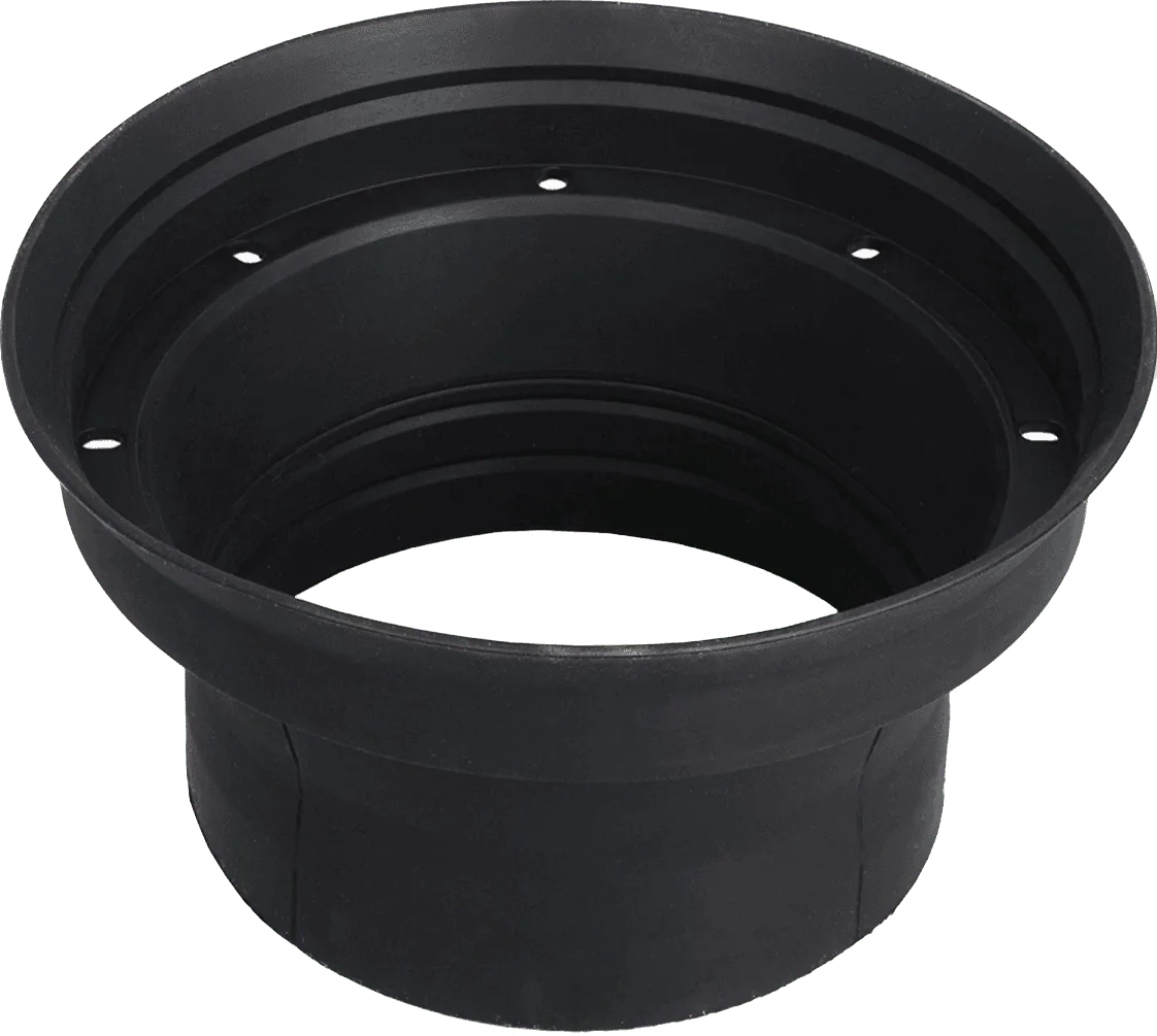

I went to install the Audison APS8D sub today. It does not fit in the B&O enclosure. The sub would not seat in the opening due to the raised sections surrounding the opening on the enclosure. The sub is not easily modifiable. The rubber speaker surround material on the Audison sub stretches out almost the full diameter. Rather than hacking up a perfectly good sub, I have decided to switch gears and go with the Kicker 48CWR84 which others have successfully fitted in the B&O enclosure.
I am hitting the pause button on the install and will resume when the Kicker subwoofer arrives from Crutchfield. (On sale right now for $79.99).

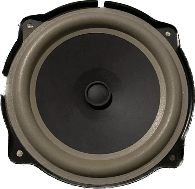

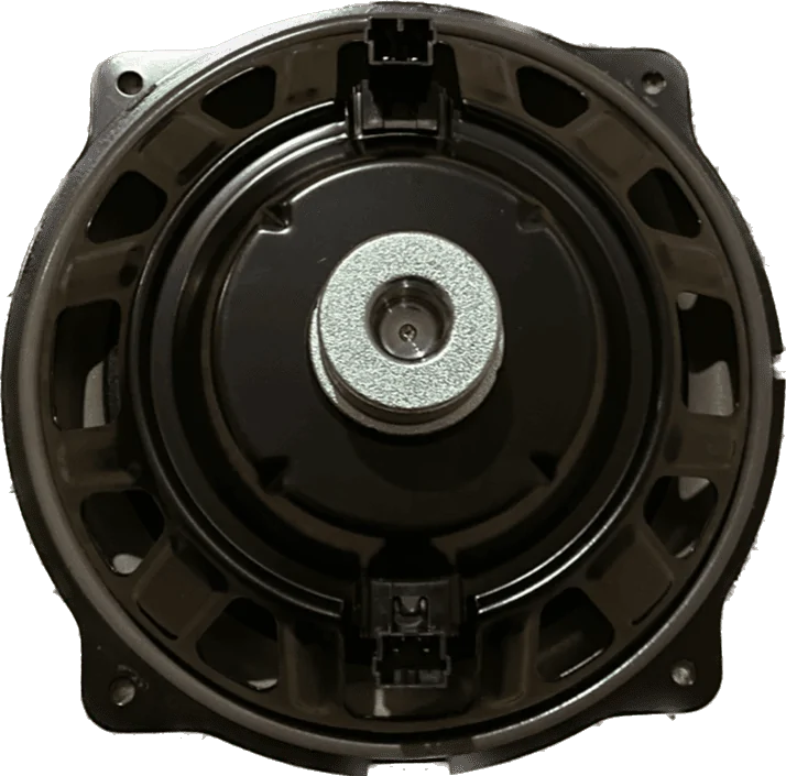

Here are pictures of the uninstalled factory B&O sub. The magnet is tiny and extremely weak. The magnet is not even strong enough for a small screw to stick to it.
Ford Bronco B&O Speakers Upgraded in 2022 Bronco 1677546193639
Ford Bronco B&O Speakers Upgraded in 2022 Bronco 1677546244410
NJNMDoc
Dec 29, 2022
386
261
Southwest
Bronco Wildtrak
Wow- this is incredibly helpful! I have been waiting for someone to sort this all out. All I have been told over and over is that you cannot get around doing a DSP for the B&O system. If you sort out the Sub issue I think I'm in!
And what a bunch of cheap shit these stock speakers are... thank you for posting the pics you have. It just goes to show how bad the quality is.
