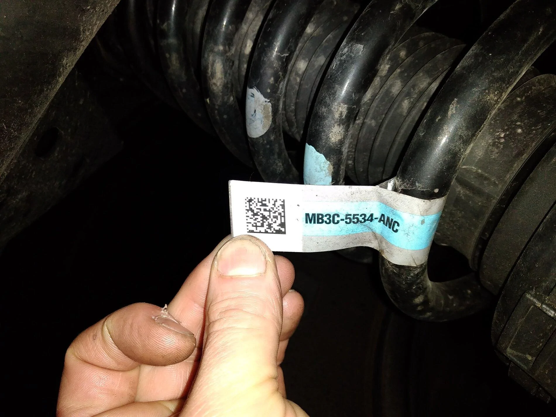

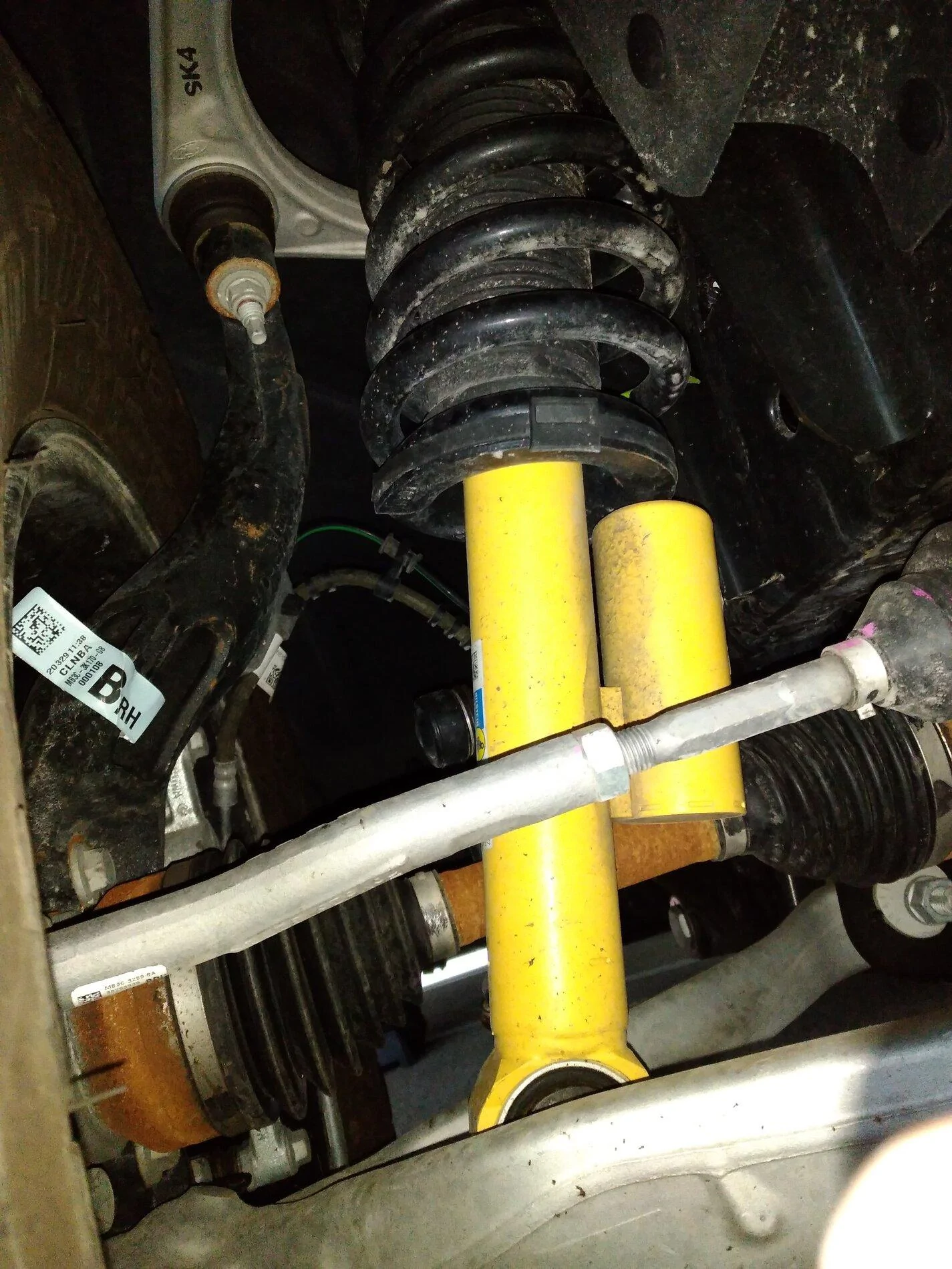

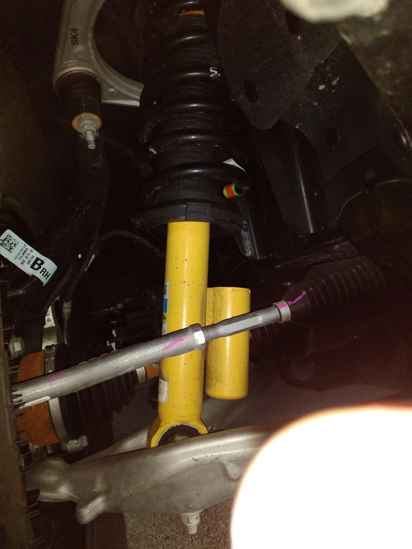

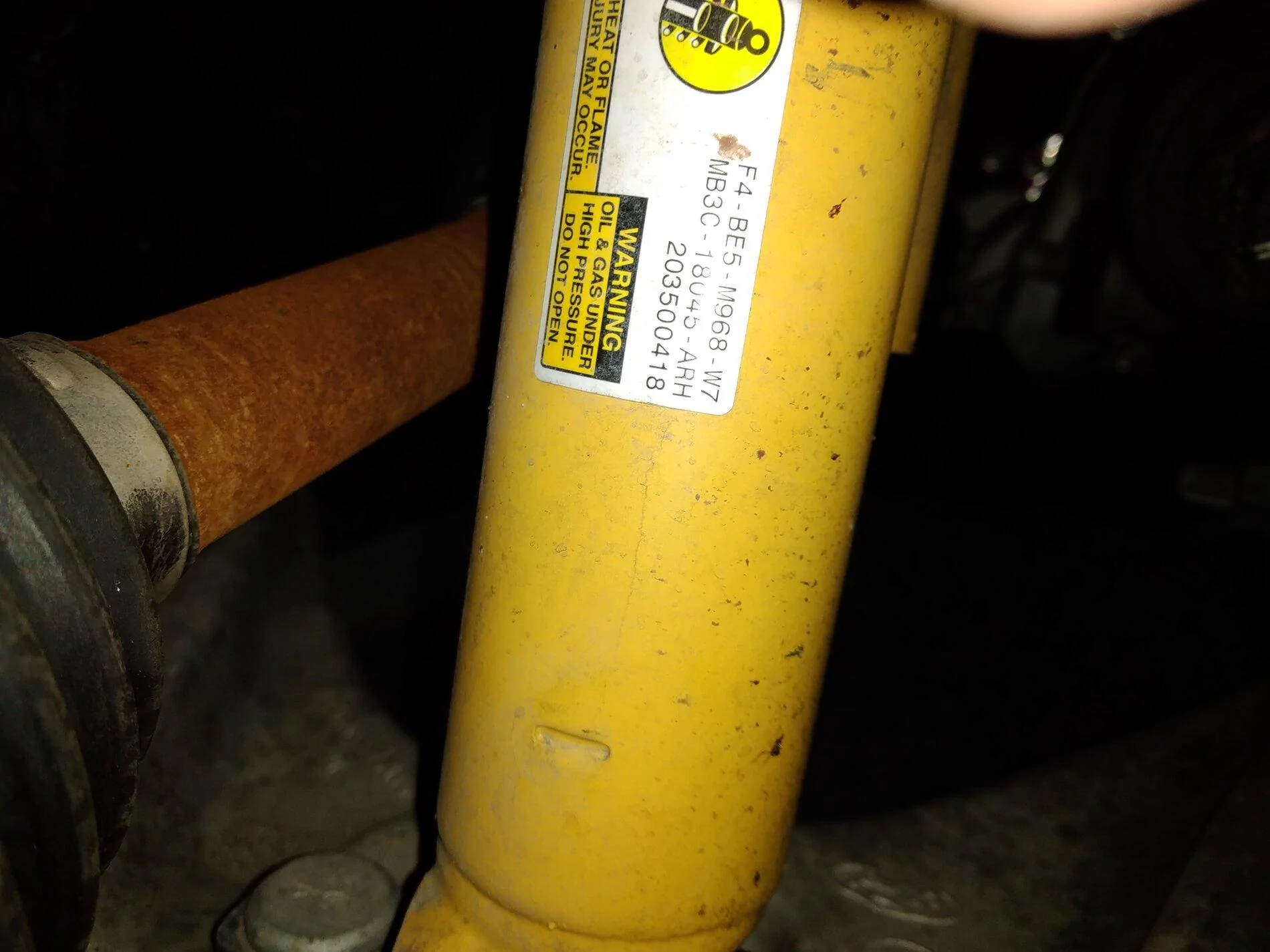

I can confirm the entire front strut is different between a 33 tire Badlands and a Sasquatch. The part numbers are different the spring perches are mounted at a different height, the reservoirs are flipped. rear shocks are not as drastically different visually however might be. I got part number pictures, ill try to get those posed on the ESCV thread.
