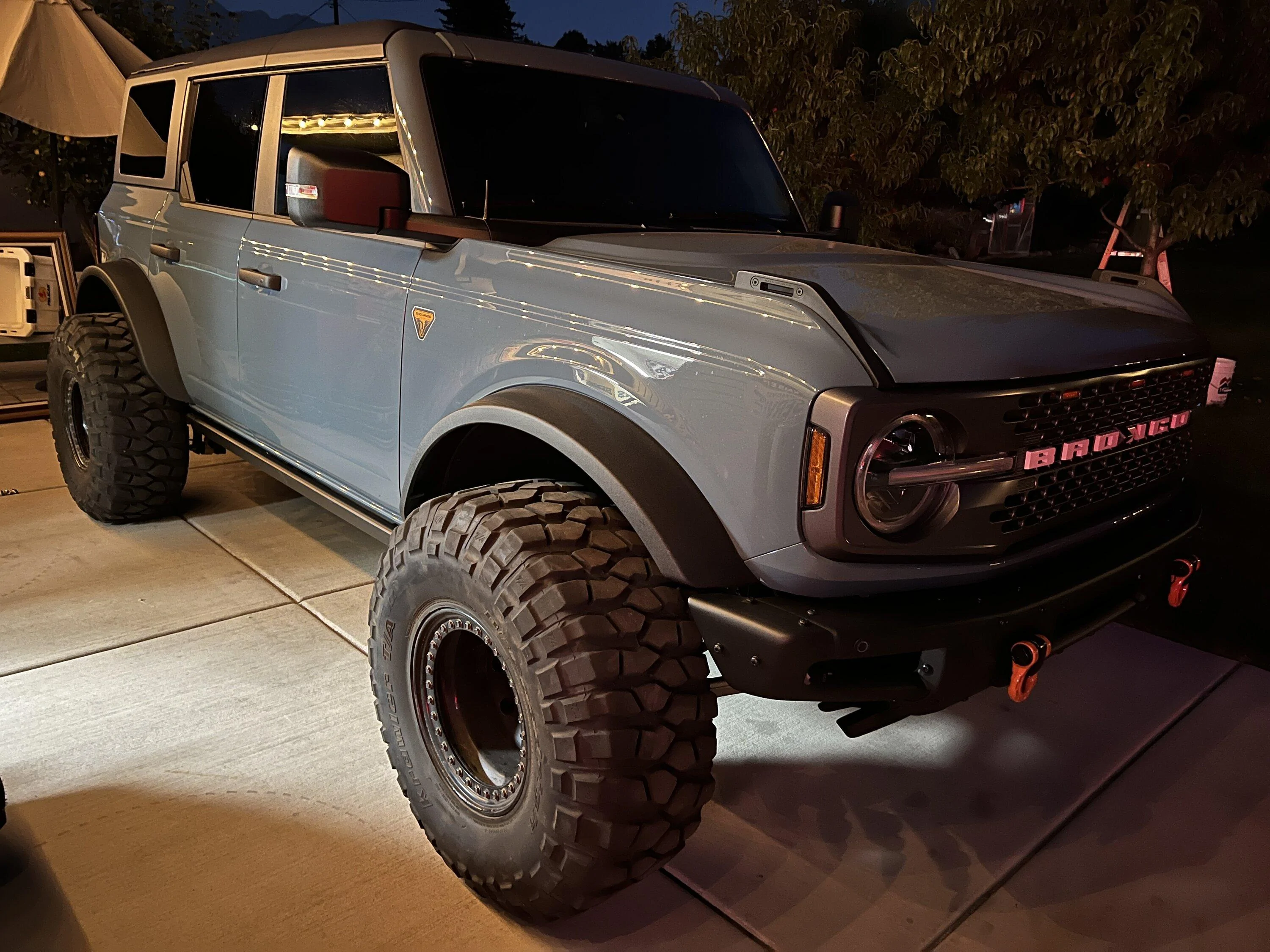

Just for fun the other night I mounted a set of 35" Krawler T/As that are from my Jeep Wrangler on our Badlands. I had to get wheel adapters to change the bolt pattern from the 5 lug Jeep pattern to the 6 lug Bronco pattern. They look pretty sweet, but rub on the bumper as well as the rock sliders when turning.
The adapters I used are 2" adapters, and the 15" wheels worked fine front and rear (no brake issues). The wheels are Allied RT81 Rock 8 steel beadlocks (15x10) and the tires are the BFG Krawler T/A 35/13.5 15s that are no longer in production. Our Badlands is stock SAS suspension.
Just thought I'd share. I may play around with it some more in the future, but really love the look of the smaller wheel - I've always been a fan of more rubber and less wheel.

When the brakes aren't in the wheel anymore you have all the clearance in the world. 😁

Lol, true! Although it looks like with the right offset one could potentially run 15s, but it may be tight.

It looks good. I just wouldn't run them since the adapters won't hold weight that well. Last thing you need is to hit a pothole and tgw wheel would come rolling off.
