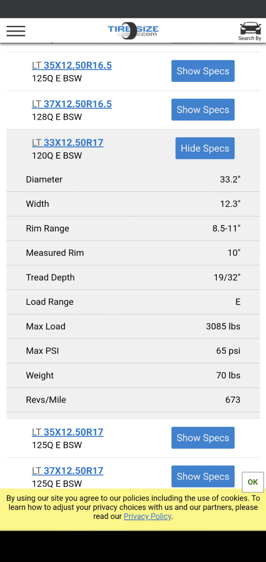

How wide are the steelies? Unless they are 8.5" or wider, Interco doesn't recommended fitting that size tire. Also 70lbs, ouch. Most places won't install them on 7.5/8 inch wide rims, you likely need to budget for rims as well.

They will fit fine, you may just need to find a smaller tire shop that will do it.
That’s a great looking tire, and Intercos are awesome tires. Very tough, but yeah that is kinda heavy.
