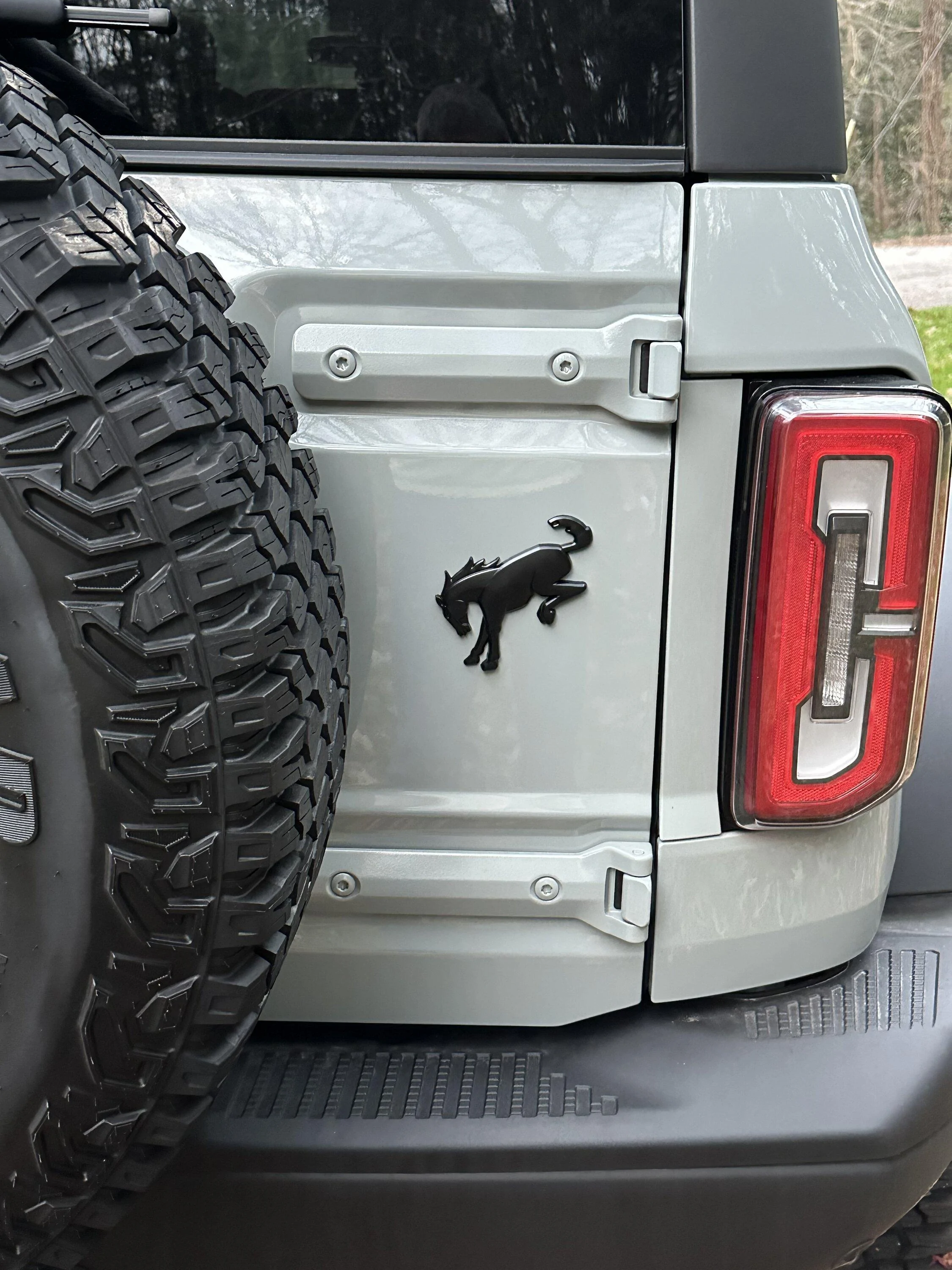

I found my black horse emblem on Amazon. It was cheap so I expected it to be plastic but was surprised when it showed up in metal.
Ford Bronco Blacked out emblems - recommendations? ECFEF765-7739-4160-A693-54538CAAC21C
What are the steps to installing this?

Take blue painters tape and put one strip horizontal and another vertical of the bottom and left side of emblem. Use a marker to mark the tip of head on tape and the front legs on the bottom. Take mono fishing line and place behind top of emblem and use a sawing motion to separate from the body. Use Goo Gone to take remaining double sided tape off. Reinstall using the marks on the tape. Done!

Thank you! Awesome looking truck

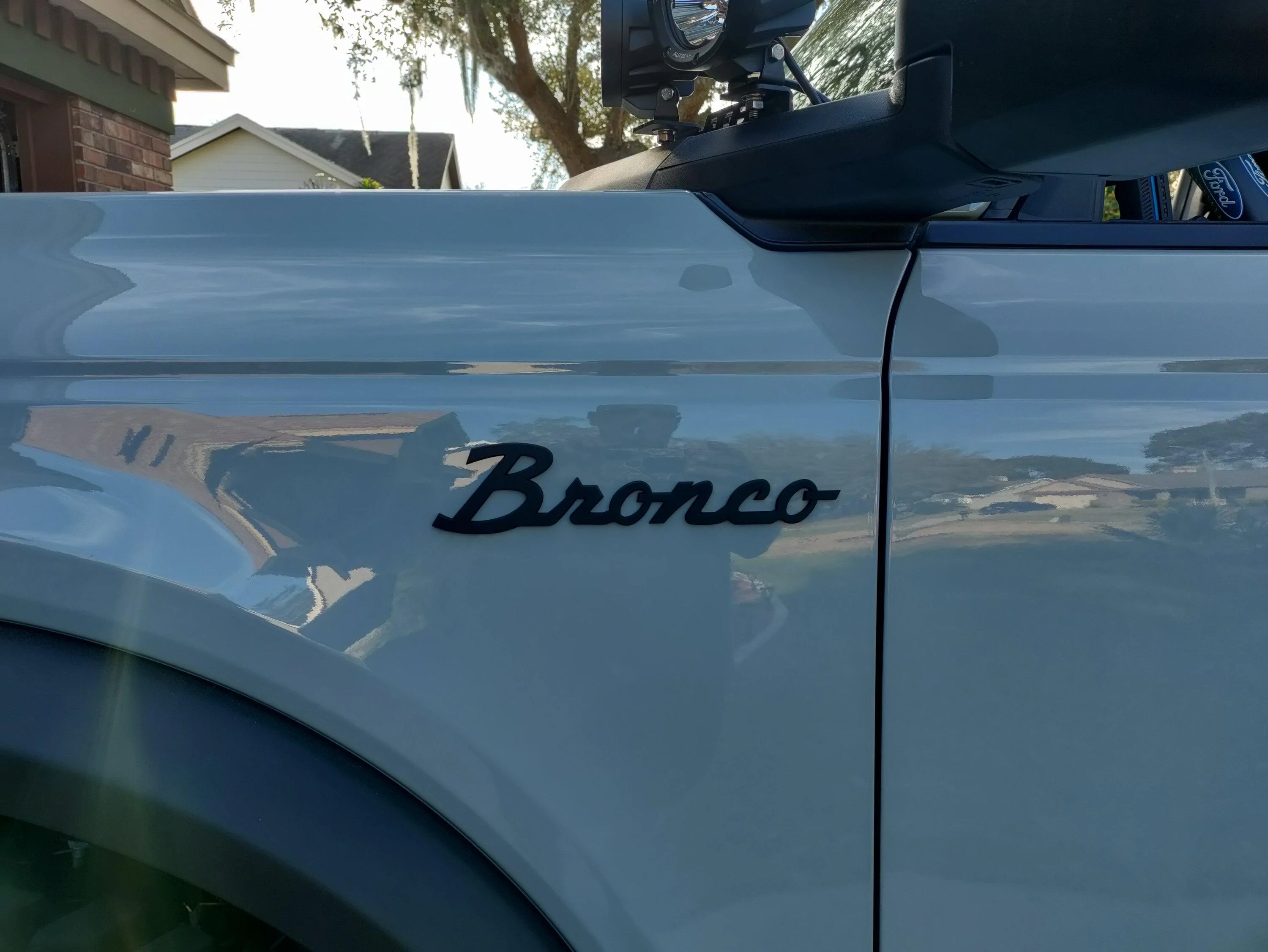

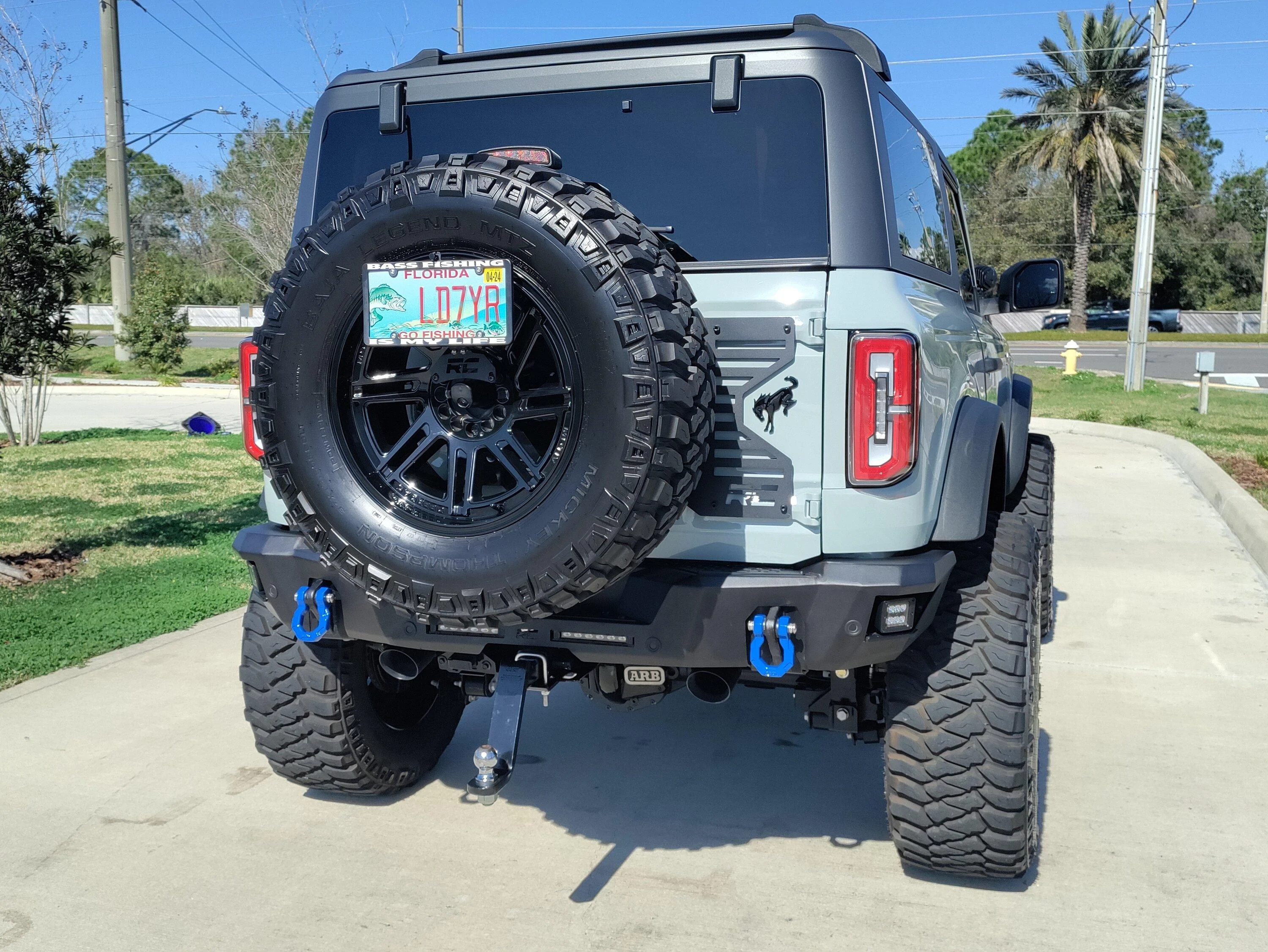

These are mine. Love the quality of both. Bronco emblem is from Bronco nation and the pony is from Bad Bronco (company is named something else now.)
Ford Bronco Blacked out emblems - recommendations? 20230322_173846
Ford Bronco Blacked out emblems - recommendations? 20220228_140832
