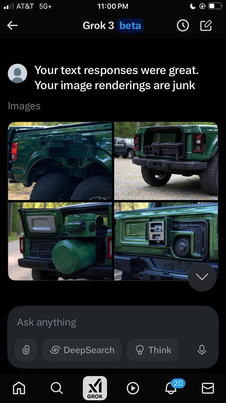

Ok really this is the last one. I asked it to give mounting details and recommended parts to mount it to the roll bar
