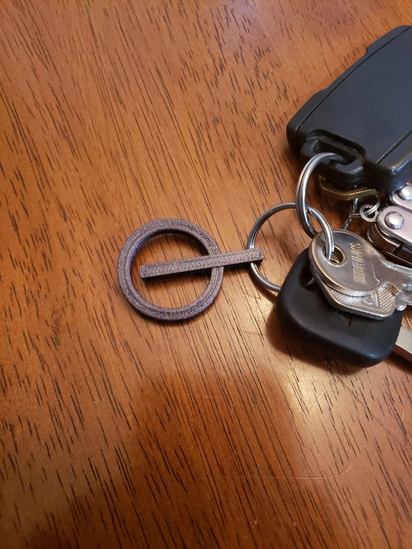

That seems like something that would break so easily as a plastic accessory.

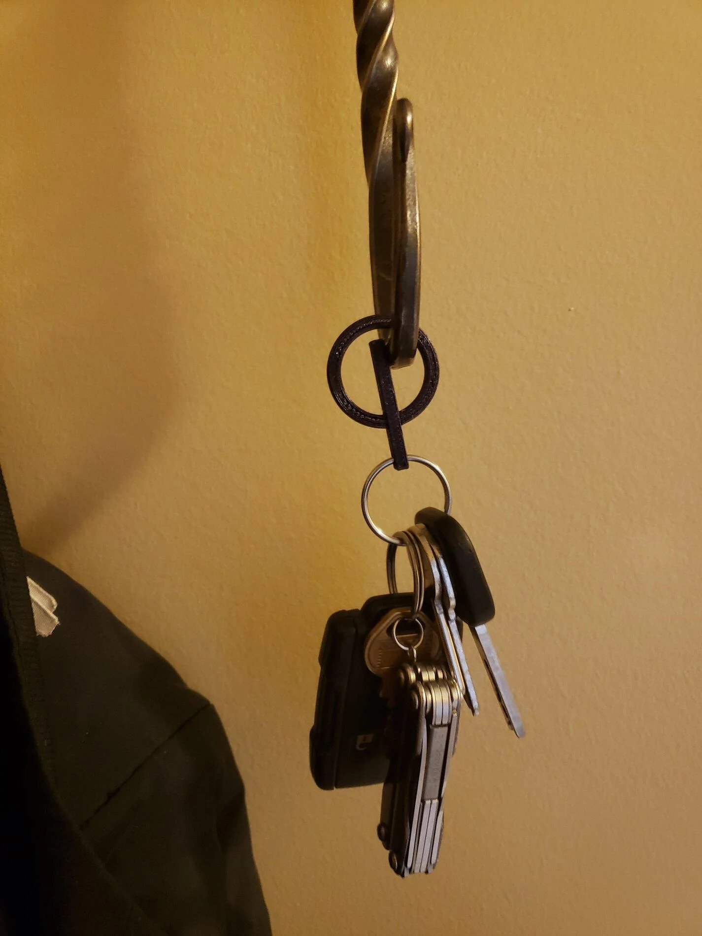

They certainly can be broken (I've broke one testing the strength) but really you'd have to be abusing this to break it. Key fobs are plastic and many people even have laminated grocery store cards on their key rings.
For what its worth I've kept one on my keyring for 2 weeks now and its been fine.

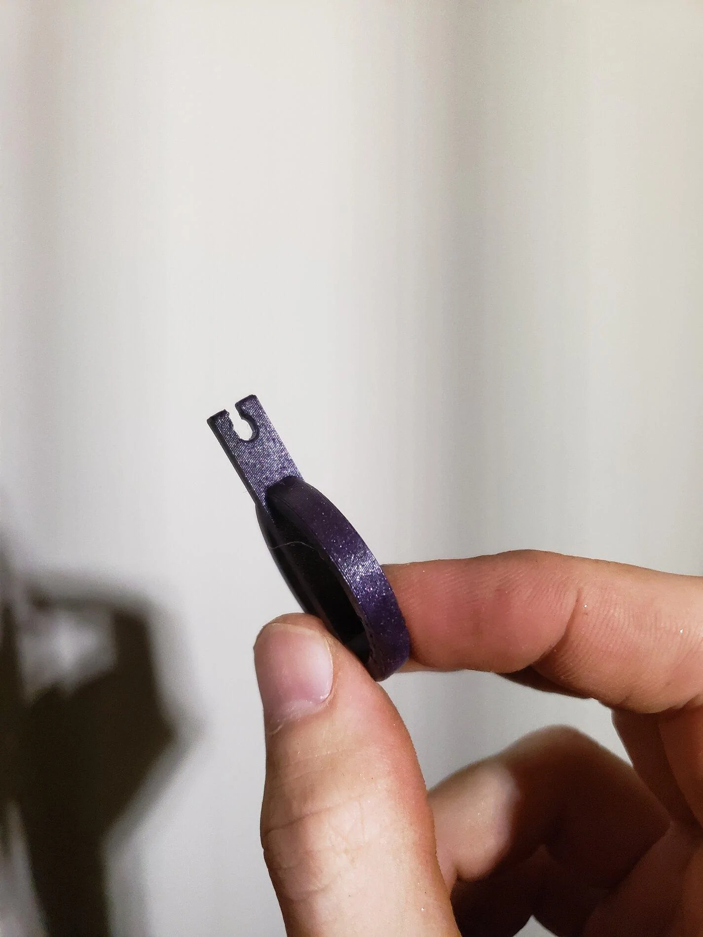

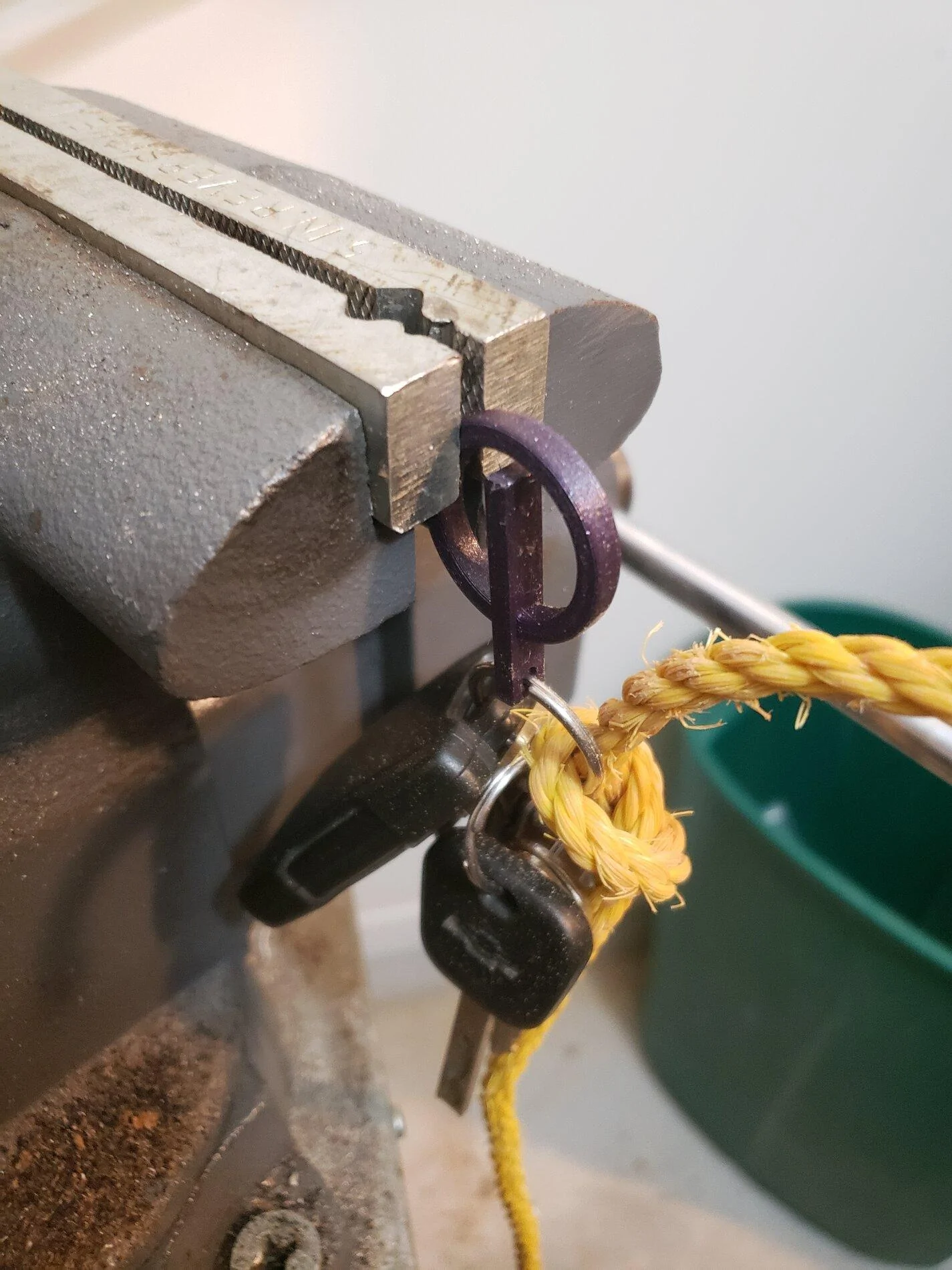

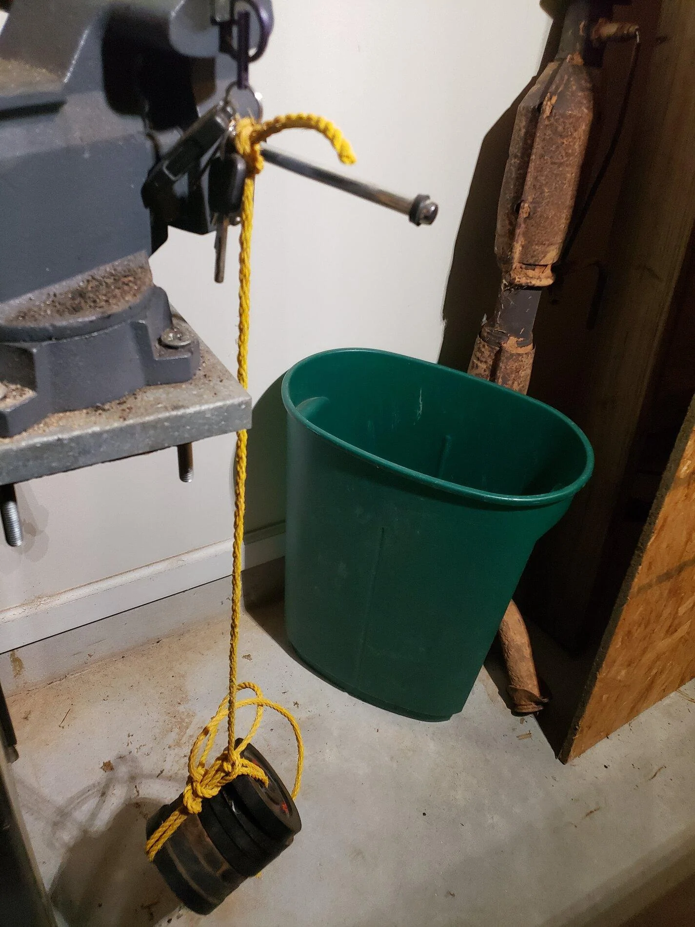

So, I can't speak to anyone else's personal 3d printing experiences as I dont know what machines are being used, what components, settings, software, filament type/brand, enclosure usage, user's design experience etc etc. Nor can I speak to what other people put their keys through. I tend to be good at breaking things, so I like to think Im a good tester for this sort of thing.
However, I can say plenty of people buy and sell 3d printed keychain accessories. I'm one of them. https://www.etsy.com/search?q=3d+printed+keychain&order=most_relevant&view_type=gallery
I can also say, my design as it's sold will hold 17.5lbs plus the weight of normal keys. That includes the mini leatherman.
At 20lbs the keychain did break. As yall can see I loaded the keychain in its weakest orientation. And the failure was the layer lines shearing.
Hopefully this eases the concerns about strength. 17.5lbs of static load is well beyond what I would consider typical usage for a keychain. YMMV

Not my personal cup of tea, I like minimal keys and wallet......
But cheers to you so for taking all the negativity, crushing it with science, and carrying on as you were.

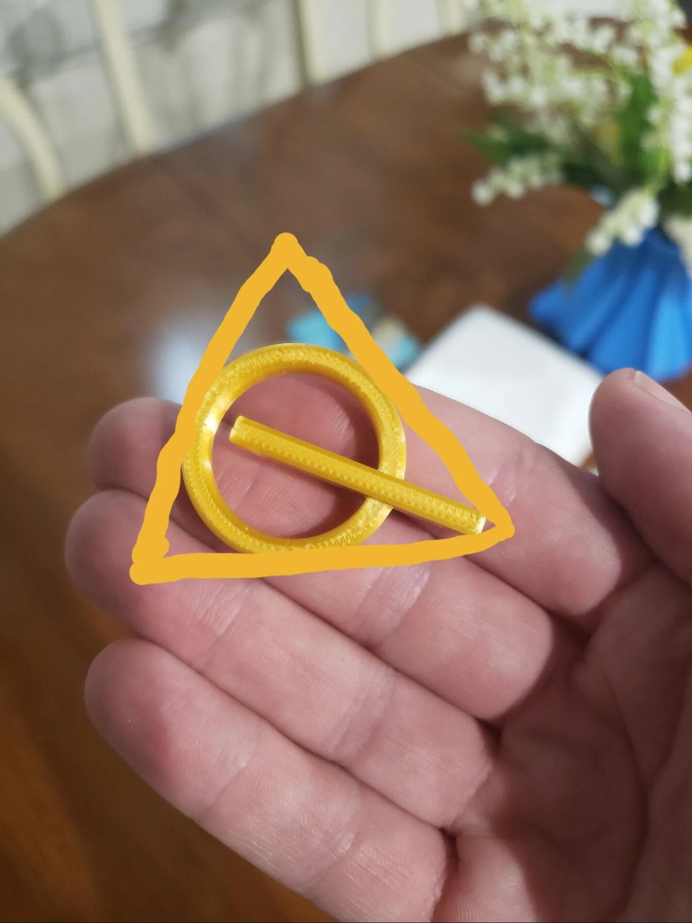

If you find the third deathly hollow, you will be the master of Broncos.
