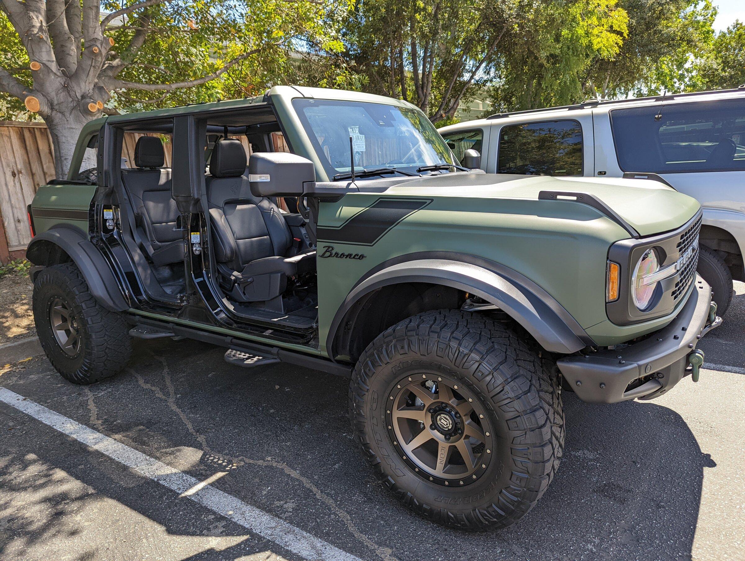

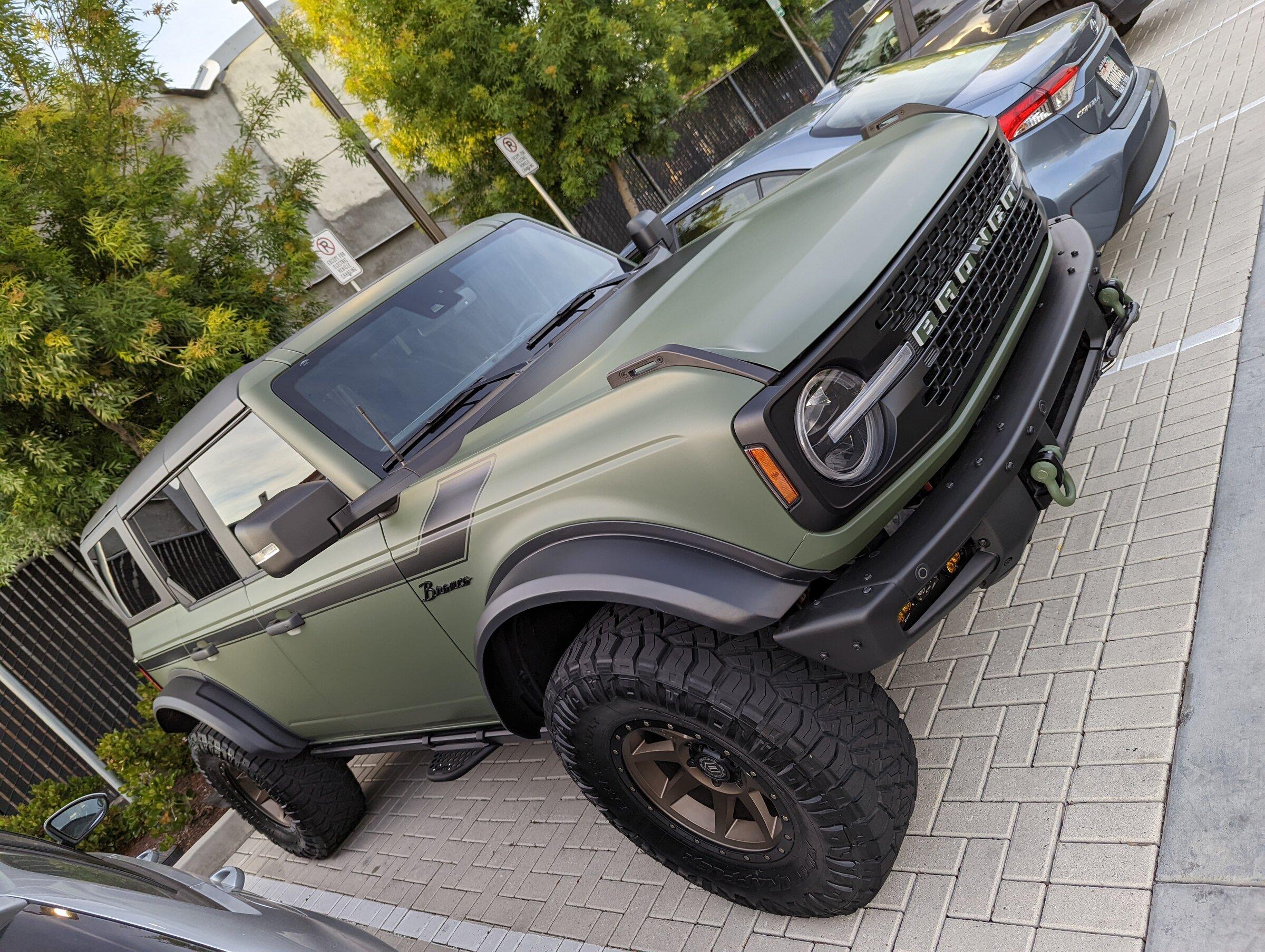

Do you mind sharing a pic of the finished product? Thinking about doing the same thing!
Here's a few. Thinking now that this option might be a little more challenging for those without a wrap. You'd have to figure out how to mount the metal on metal without scratching.

Good point, something to consider. Thanks for sharing the pics, looks great!

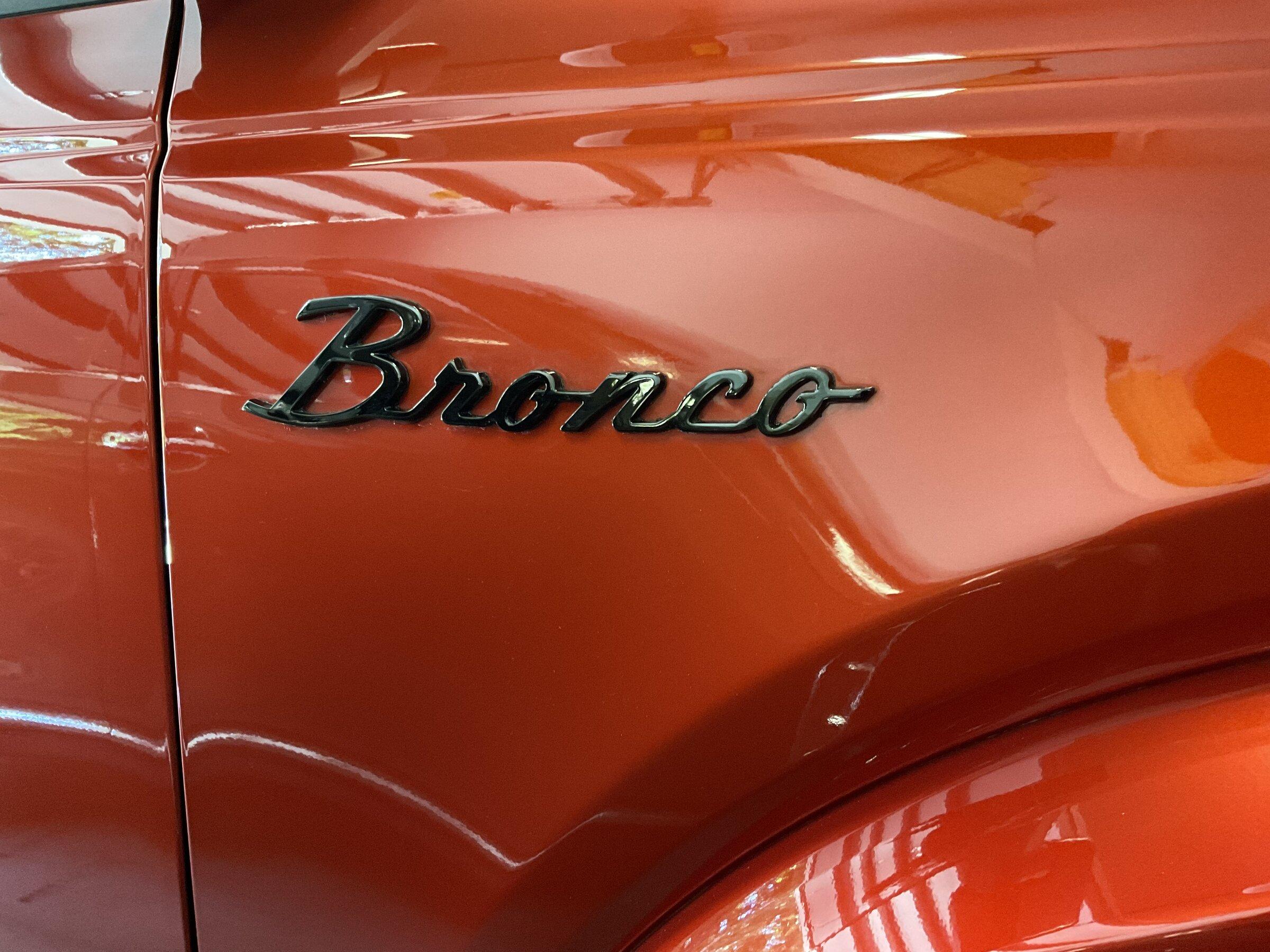

Oh and fyi, the ones I found say they have pins on the back for a drilled install. You’ll probably have to modify them like I’m planning to.
That’s what I did. Ordered black chrome badges from Tom’s Off-road dot com, ground the pins off, filled the cavity with epoxy, made a template to alight off the door edge and fender line, mounted with 3M moulding tape. Took some effort but way nicer than the plastic stick-ons I bought originally. Worth the effort.
