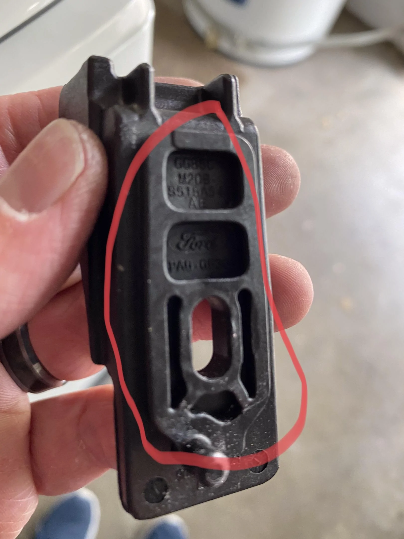

@CKXVII i finished up the install today. Had pretty much the same issue, I could close one side, but not the other. So to remedy this, I removed the Ford latch brackets from both sides and then using a dremel tool, cut away the “raise“ part of the brackets After cutting away both and reinstalling, the soft top will latch easier.
Ford Bronco Bronco Slipstream Security Enclosure 07A067EA-1353-4A99-BA63-487C55F706B0
Thanks for the tip; did this today and it def helped with closing the soft top.

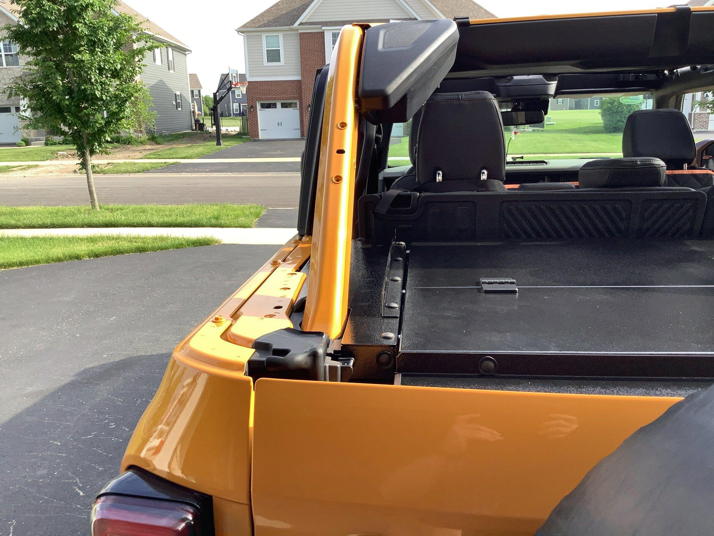

I took my soft top yesterday and figured it would be a good time to install the enclosure. I installed it myself
It took a few hours but I wasn’t in any rush, and referred to the video often.
It is very tight, and took a little bit of fiddling until I was able to get all the door and top pins in successfully.
I’ve realized I am going to have to do some disassembly of the enclosure to put the soft top back on which I am not looking forward to, but otherwise it’s seems solid and looks great!

The disassembly is only removing the three main bolts from each side of the side body?
