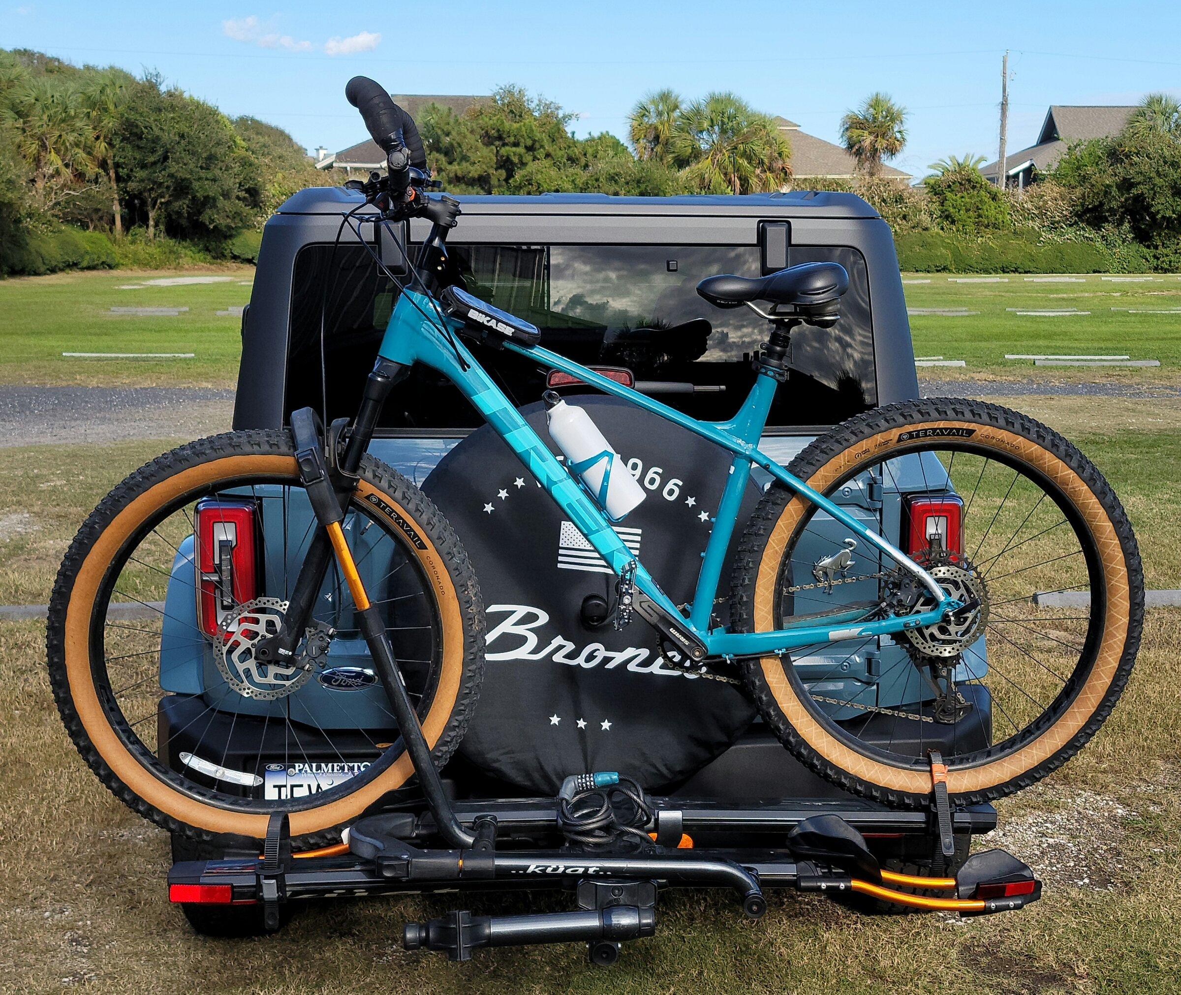

Its a Kuat Pivot2, about $400, which extends the hitch receiver away from the spare tire, as well as being a swing-out hinge. With a swinging rear door, I have to swing the bike away to open the door. To that is mounted a Kuat NV 2.0, flat load, fold up bike rack. With the accessory work station, it was about $650. I can also put other racks on the Pivot2, like a fishing gear rack. See photos. I leave the Pivot on the hitch, and change out racks.
Ford Bronco Broncos "Rake", level vs lift 20211123_104723
Ford Bronco Broncos "Rake", level vs lift 20211123_104853
Ford Bronco Broncos "Rake", level vs lift 20211029_160050
Although in this photo perspective, it looks like the bike is wider than the car, it is not. In fact, the OBX fenders are wider than the bike.

Ohh sweet, might just need to buy the pivot tbh. Clearing your spare wheel do you think it leaves enough room to clear a sas tire? Love your bike btw!

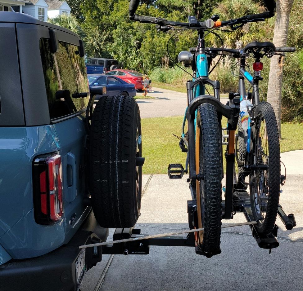

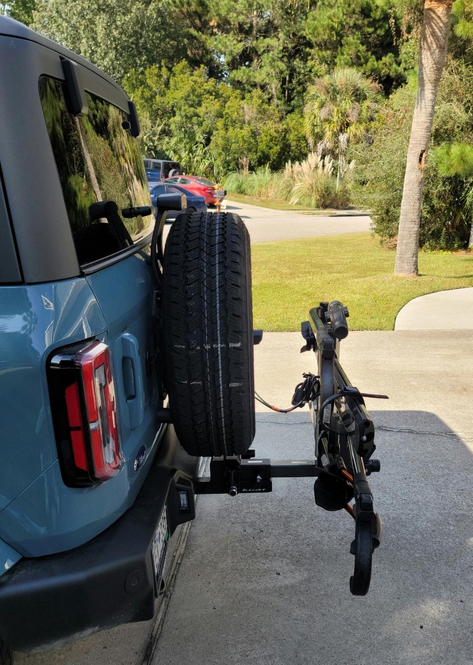

Yes, it would clear a SAS tire and even 37" tires, I believe. You can see a yardstick lying along the bottom of the rack, it adds about 42" fully extended. 4" of that is the add-on work station. Its the most expensive pair of bike racks Ive bought, but Ive found you get what you pay for, and these are very sturdy. I used them on my F150, and could put the tailgate down if needed. These racks both have tightening mechanisms inside the receiver bar, to eliminate movement. The hitch pin has a safety and theft prevention role. Here are two photos, with rack loaded, and folded, and how far they extend.

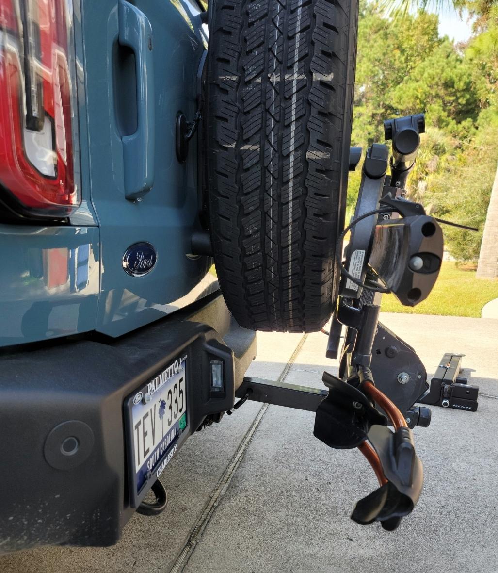

BTW, the bike rack will NOT clear the tire without an extender. I added a photo showing how the OBX spare prevents the bike rack from entering the receiver. The Pivot is on the ground in this photo.

This photo shows how an extender is necessary to add a bike rack with a spare tire.

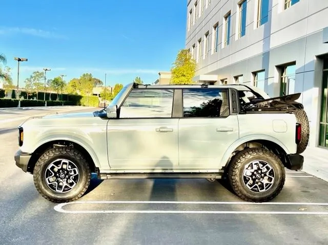

We added 33" tires with no lift on our Outer Banks. The rake on yours isn't as noticeable as ours. The difference from the front fender and rear on ours is 1 3/8". 36 5/8" front and 38" in the rear.

I cant read your tires. What exactly are they, size and type? What do they ride like, and how do you like them? More noise or harshness than stock?
