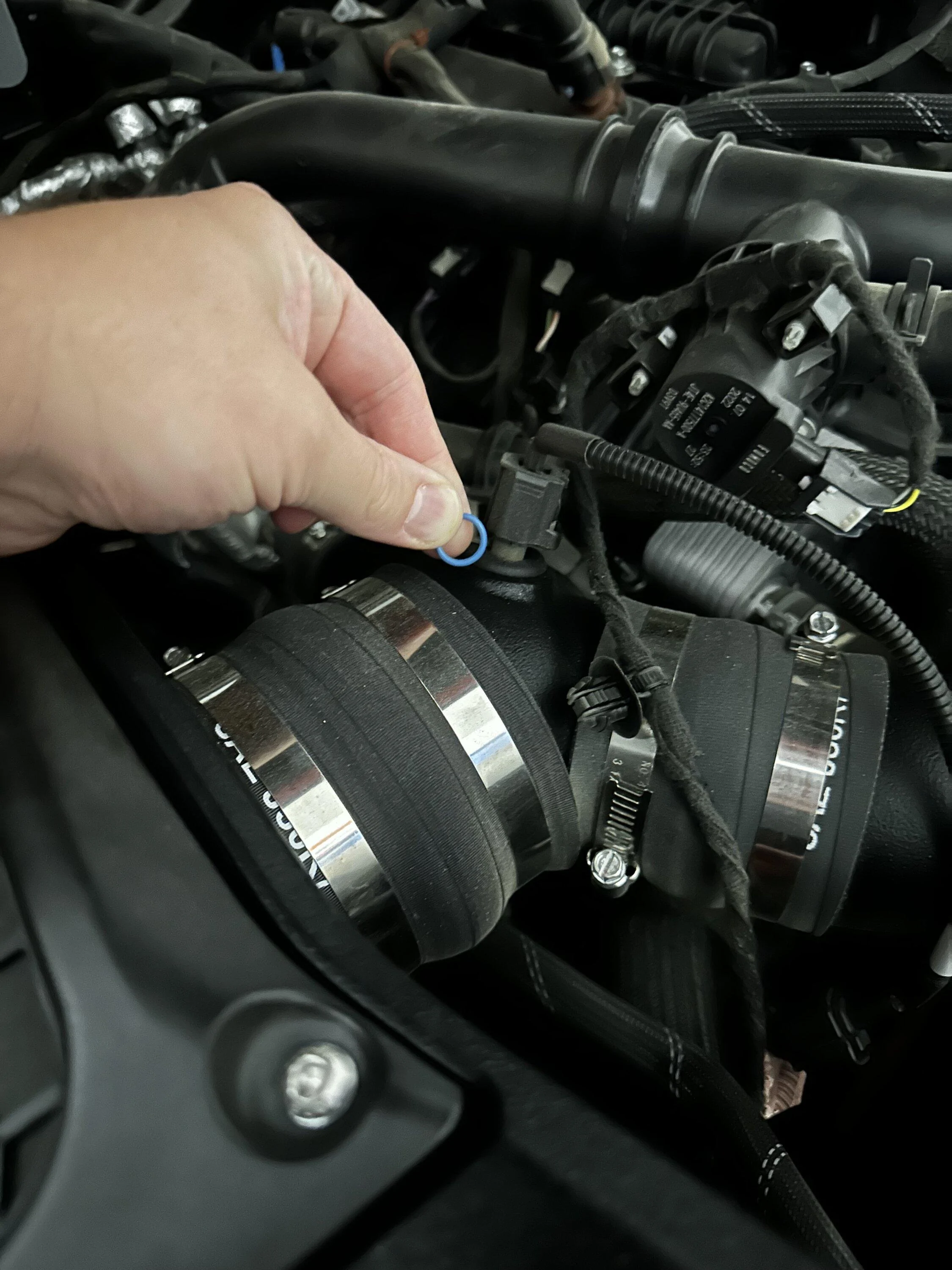

Same thing happened to me, I installed the K&N CAI @ 1500 miles in my 2023 outer banks and the check engine light immediately came on with the same code, P0111. I used an instructional video to install it and a very important step was missed. This step is included on the printed K&N instructions though.
The blue O-ring on the air charge temp sensor has to be removed, it won’t fit in the K&N intake tube without it being removed. It’s still a tight fit, but I took the o-ring off, cleared my codes, and have driven 1000 miles light/code free.
Hopefully this helps, I’ve included a picture of the O-ring and the respective sensor.
Ford Bronco Check engine light PO111 for 2.7 IMG_1350
Thanks I’m going to check it out
