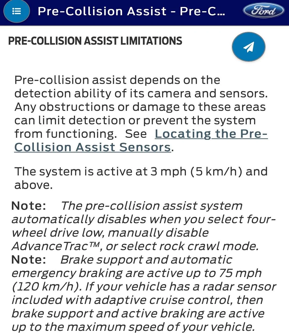

I saw that video, that’s exactly what I think my Bronco would do.
Now I am curious, has anyone had their collision warning go off at something between 3mph and 25mph?
Yes, pretty much every time it has gone off for me. It is always when someone is turning right either at a corner or into a lot and I am coasting/engine braking to slow down (no foot on brake, low speed, and a decently long distance between turning vehicle).

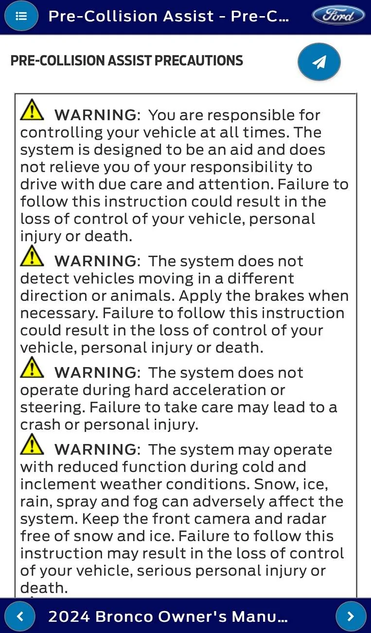

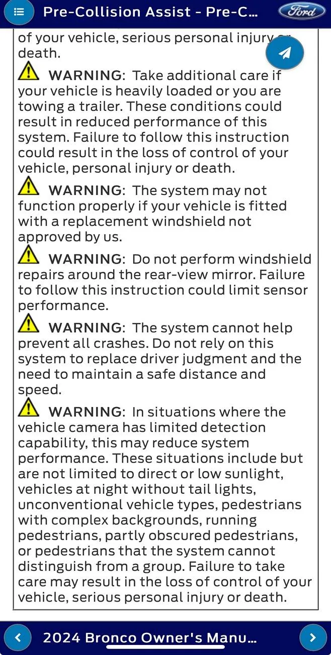

Also like I mentioned earlier, it only works during certain times. I’m 90% sure the owners manual lists certain times it may not work and night is one of them. I’ll find it in a little while and post it.

Thx, and that's damned helpful to know that pedestrians dressed dark and at night are fair game. Duh.

Ducati, I’ll personally take you to 3 ford dealerships in the Los Angeles area. Not 1 salesperson will be able to tell you the mph at which the collision avoidance will kick in. I agree with you that it’s not the service manager’s job to know that, but it is the salespersons job to know what they are selling. Again, apologies for a rant…. I have not found an answer to my question from Ford. However I did just notice in my Bronco, that the alert priority display shows 1 car length, for each level of alert. Highest level is 3 car lengths…. There is no mention of speed. The lane centering seems to kick in at 40mph.

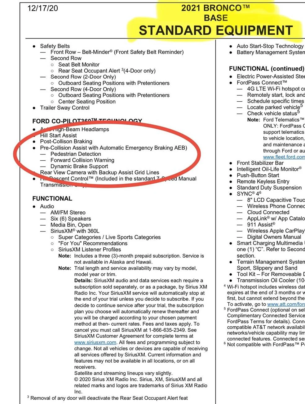

thank you for posting that!. My window sticker does not say all of that. It just says: Pre-collision assist with AEB, without breaking down the details like yours does. But I am assuming that your sticker's breakdown, is the same system as pre-collision with AEB. Your sticker specifically states; Pedestrian Detection, Forward collision alert, dynamic brake support: My window sticker just says: with pre-collision assist, with AEB. Is this just the verbiage on the window sticker? or could mine do less than what yours does? On the infotainment screen: it does let you turn emergency braking on and off. Interesting that it's so much more detailed on your sticker. I know that window stickers can vary.

That is the official order guide from 2021 for a base bronco showing the standard options. Meaning this stuff comes on every Bronco.
Window sticker is much different, even mine with the lux package doesn’t give this much info.

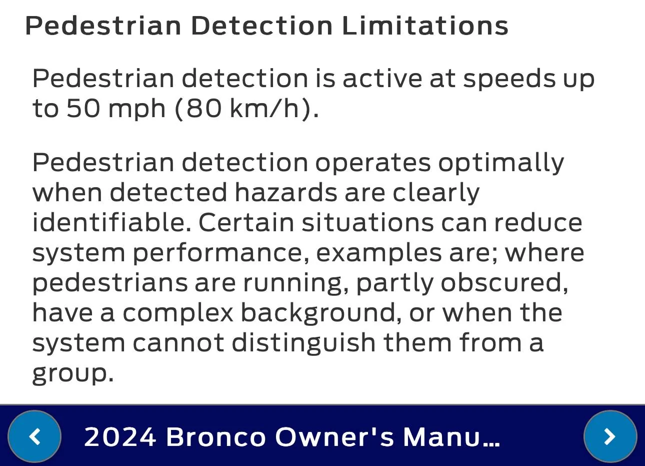

and just for laughs.... do you think Ford means "Pedestrians with Complex backgrounds, or pedestrians that the system cannot distinguish from a group" as perhaps being a bit open to misrepresentation? Like if you are driving through UCLA and there is a mathematician, your car would not brake for him, or her. I mean I get it, but why put it in the system if it's most likely not going to work. I don't think there are a lot of Urban driving situations where a pedestrian would NOT have a complex background. Actually, it's sort of, would you want a Tesla to be driving on its own with anything close to this disclaimer? I'm sure I will catch a lot of grief from this post and I am a Ford enthusiast....
