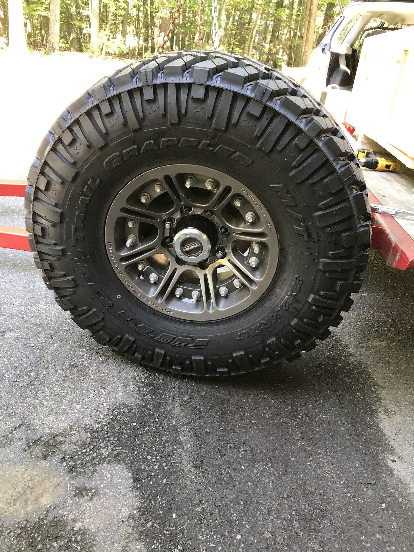

I can only offer one reference point, buddy's Rubi.
JKU Rubicon.
Method 105 wheels
BFG 37'' KM3 Tires
I torqued to spec, the beads of the tire compressed but not to the point of the rings clamping against the wheel. My buddy drove it about 100 miles and rechecked and they were loose. He torqued them once or twice more and I think they have been tight since. I believe if you can seat the ring against the face of the rim it'll be rock solid. If the ring is "floating" i think things can shift.
All I got first hand.

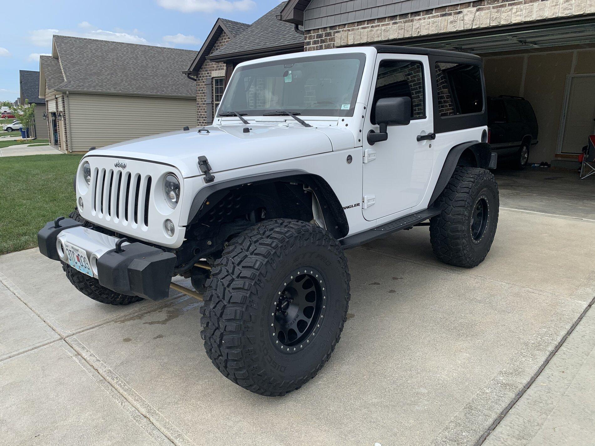

Those wheels require a spacer with thick bead tires! Buy them ASAP, this is when beadlocks are unsafe! They have to be solid, or they will come loose and/or break bolts! I had to get them for Cooper STT pros.
https://www.northridge4x4.com/part/...s-beadlock-ring-spacer-kit-one-per-wheel-17in
Now. That being said, i ram beadlocks on my daily for 20k miles without issues. They never came loose, although i did check them every few months. I will be doing beadlocks on the bronco too.
