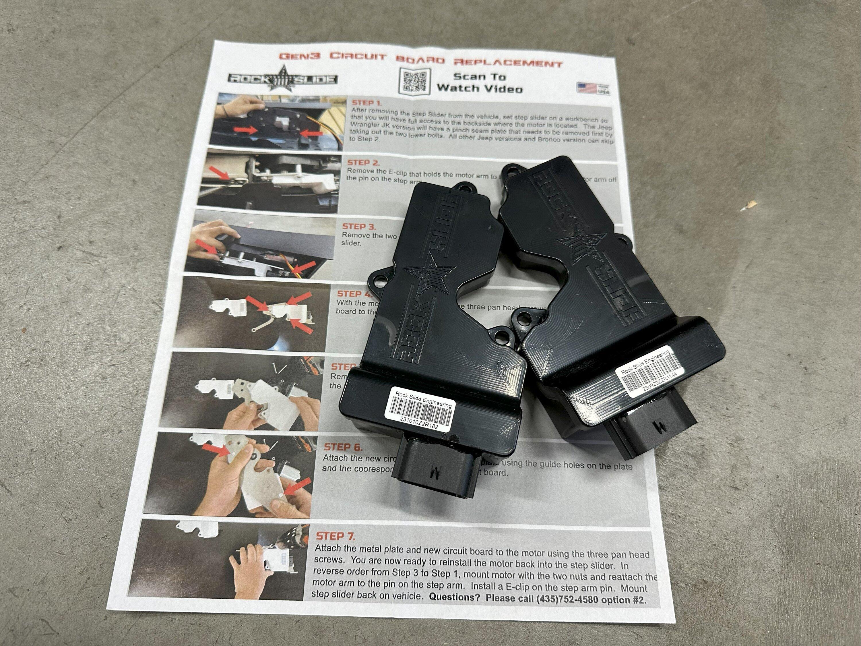

I installed the new controllers a few days ago. The original controllers were over 130mA. With the new controllers, it dropped to 33mA. Still high, but much better. The new controllers are black (original white). The controller behavior is also slightly different and doesn't seem to cycle the steps when reattaching power.

Yeah, the older RSE steps have a big problem with battery drain. It will drain the battery in a week or so. I can't remember how many mA's I measured, but it was too high. They have fixed the problem, so contact RSE support to ask about a controller swap.
I reached out to them...now apparently I just have to prove that it is the steps causing the drain. It is the only aftermarket (electrical) item I have installed.
