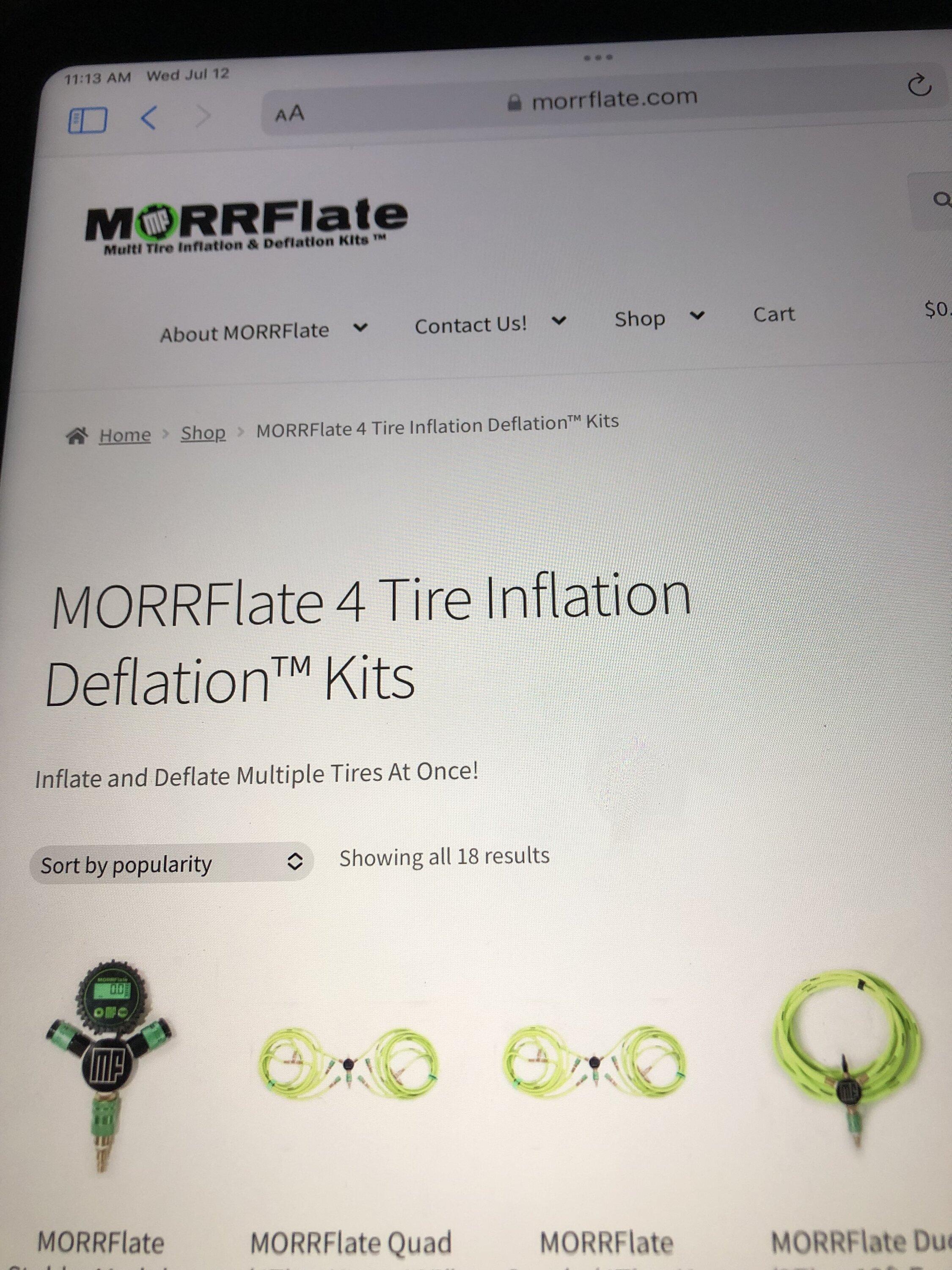

Thanks everyone, that’s why I asked the question. This is the other system I have been considering, along with their dual compressor

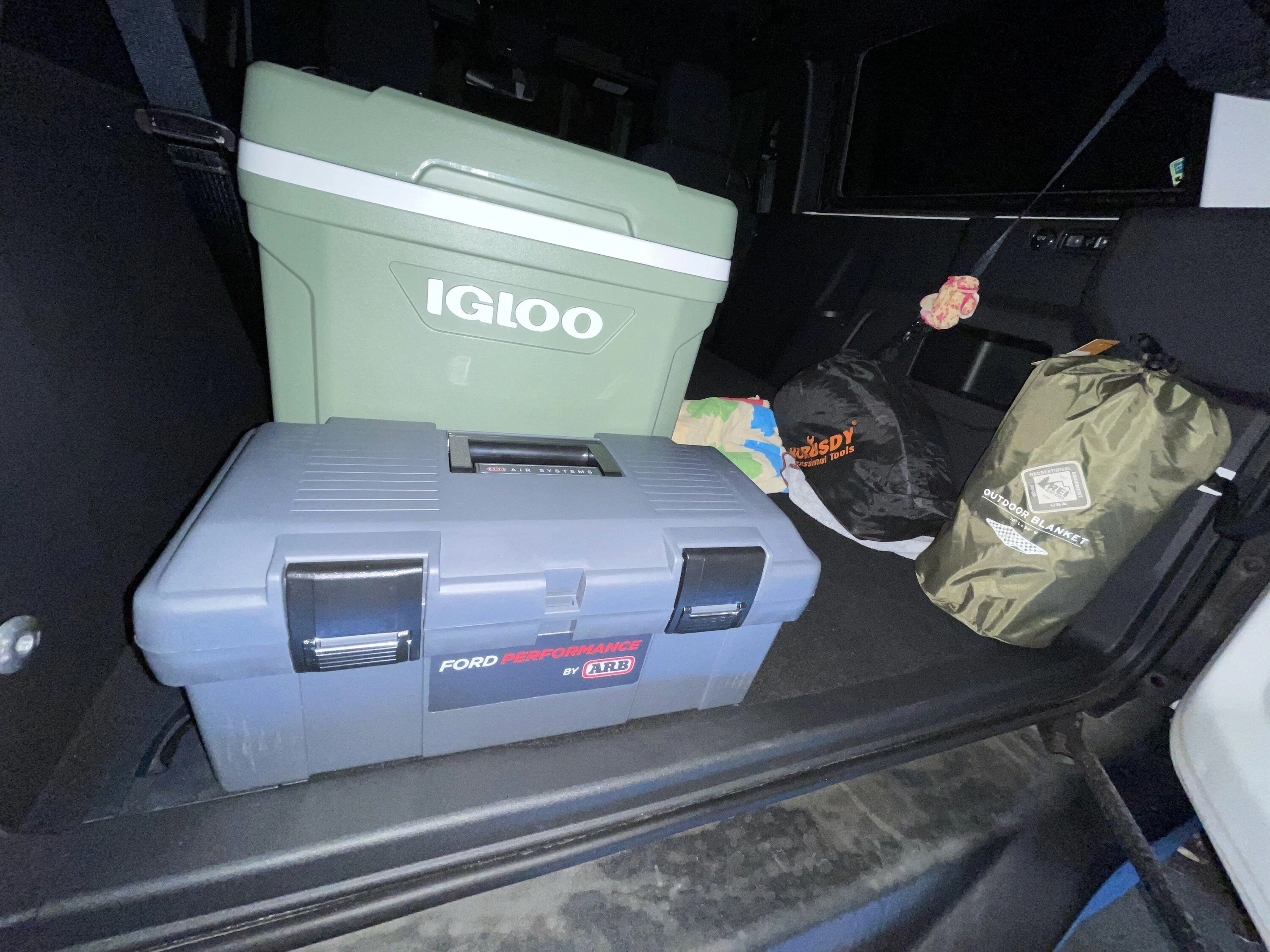

I switched to this for 35s. Used a bunch of Ford points, got it free from the dealer. I think my old plastic pump would've melted down!

Those kits can work very well once you have them calibrated and that can be a chore.
I have the Boulder Tools deflators. You can calibrate them as well, and maybe I should, but they’re just manual screw on deflators and take PSI down pretty quickly.
For inflating, I just have the ARB kit which is one at a time. I air down to 20-25psi most of the time and it takes me roughly a minute and a half to air up each tire.
Other issue that most fail to mention is that inflators get very hot quickly. The ARB twin is mostly metal and doesn’t need cool downs and can run 100% cycles. However, everything gets hot to the touch after about 2-3 tires. I wear gloves to remove the line from the chuck.
Point is, consider that before a purchase. Plastic will melt eventually, causing you to buy another. Guess when it’s most likely to break? Right when you’re leaving the trail and need to get home. Having a good compressor and good digital gauge (also ARB for me) is a smart purchase.
