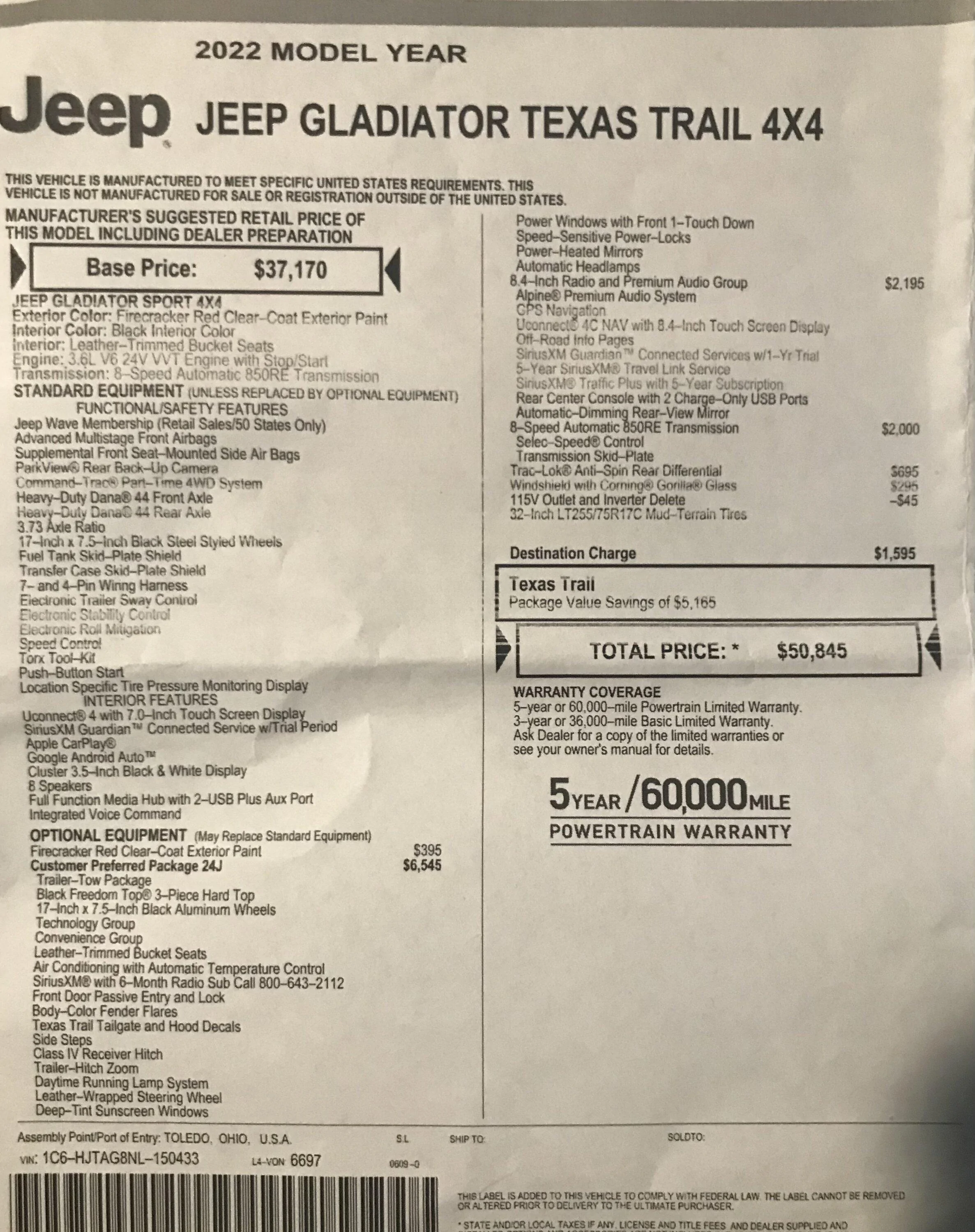

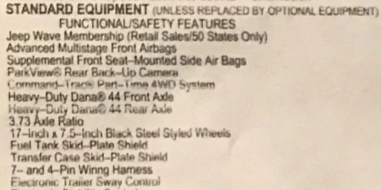

All the info I can find says the JL Sport (which is what the Texas Trail is based on) says that they came with the Dana 30 in the front. Only the Rubicon came with the 44 up front.

Comes standard if you go tow or diesel last time I looked. I know I was looking hard at Jeep Gladiators in 2021 before I got covid laid off.
You do understand that tow and diesel are options... which makes the axle an option too...

Ok that makes sense. Tx Trail package includes tow. I was mis-informed by a jeep guy neighbor that all Gladiators come with D44’s front and rear. His is Diesel btw.
