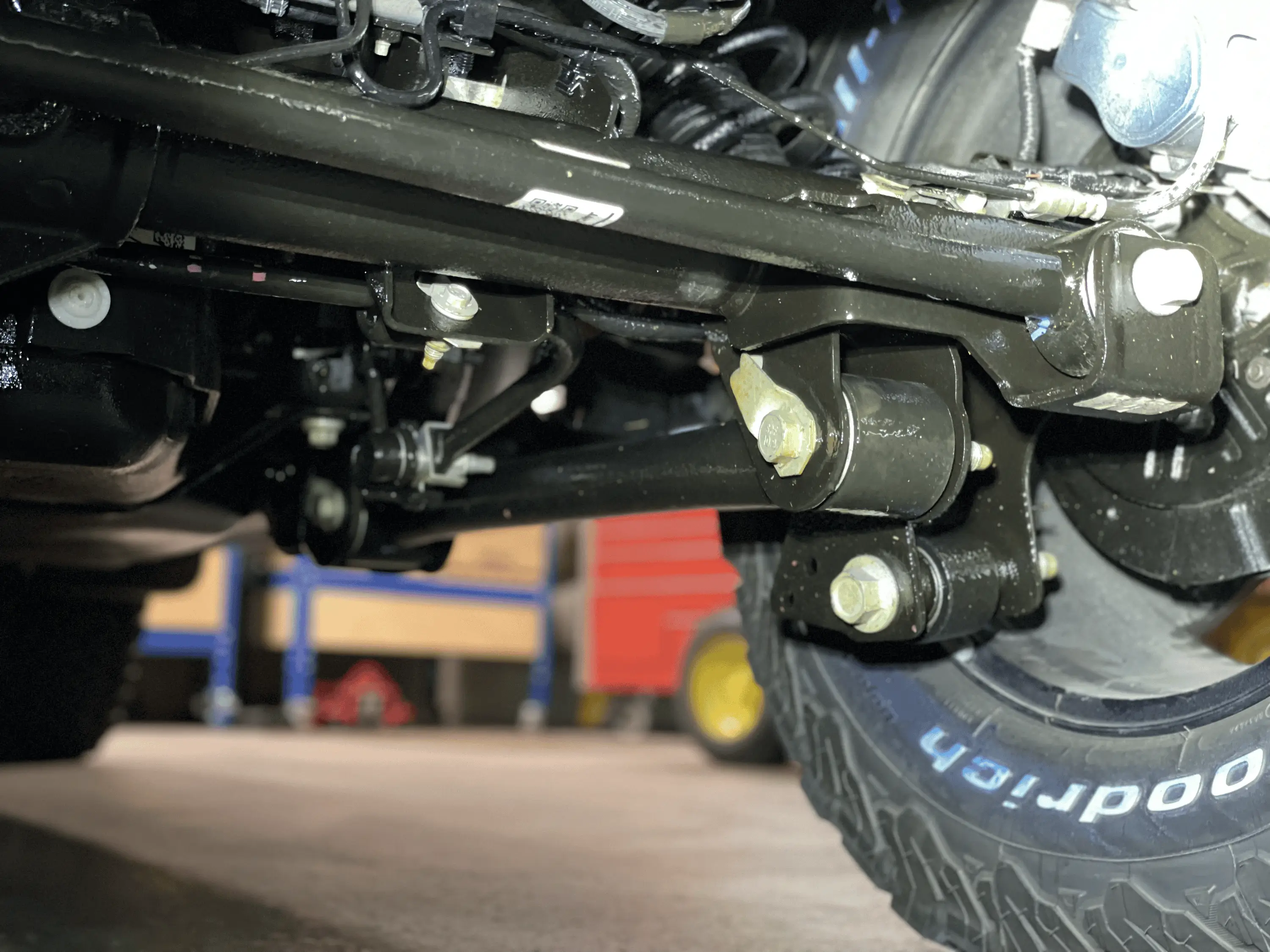

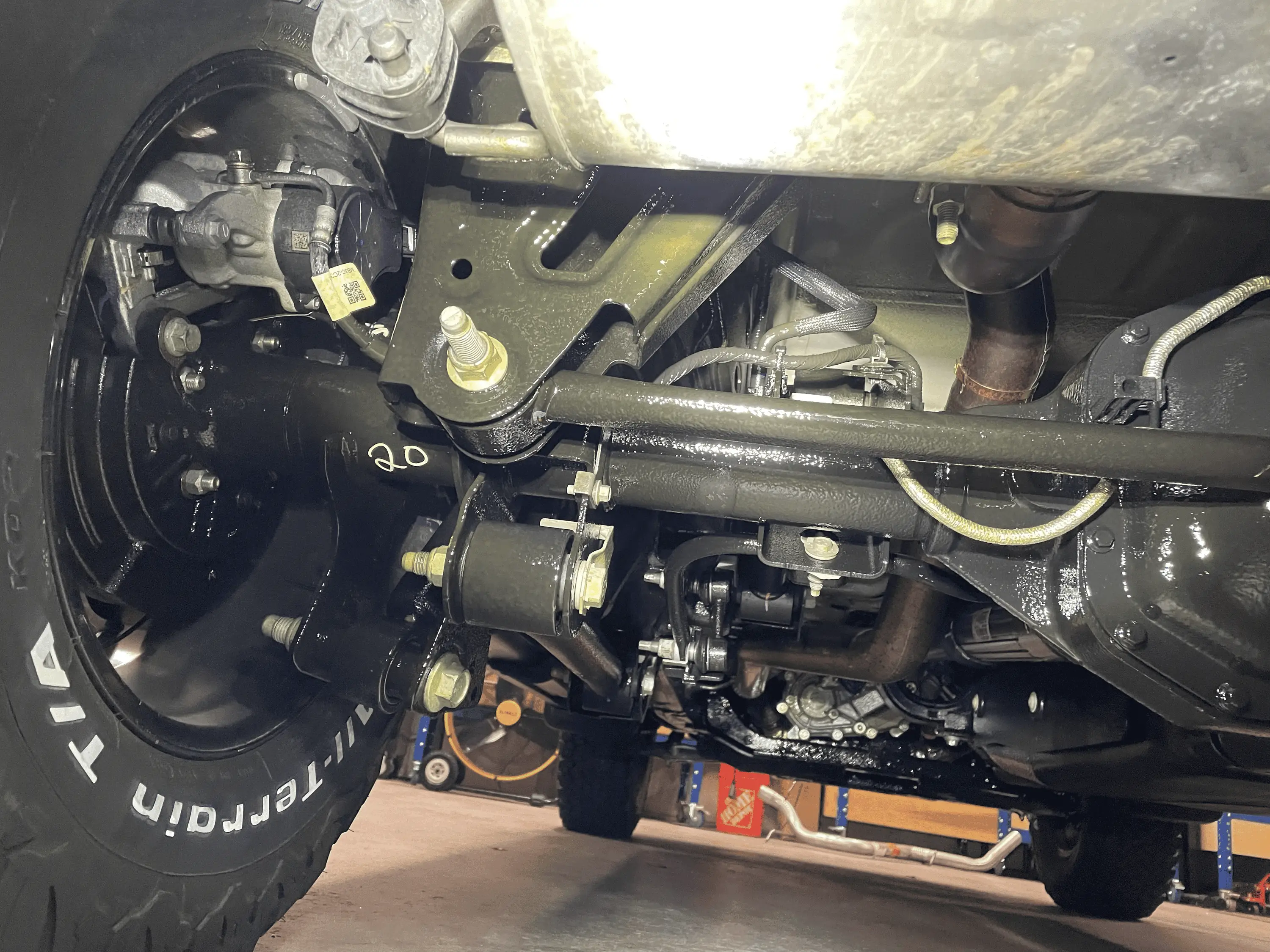

Undercoated the Bronco this weekend. Total time about 4 hours. I work slow.

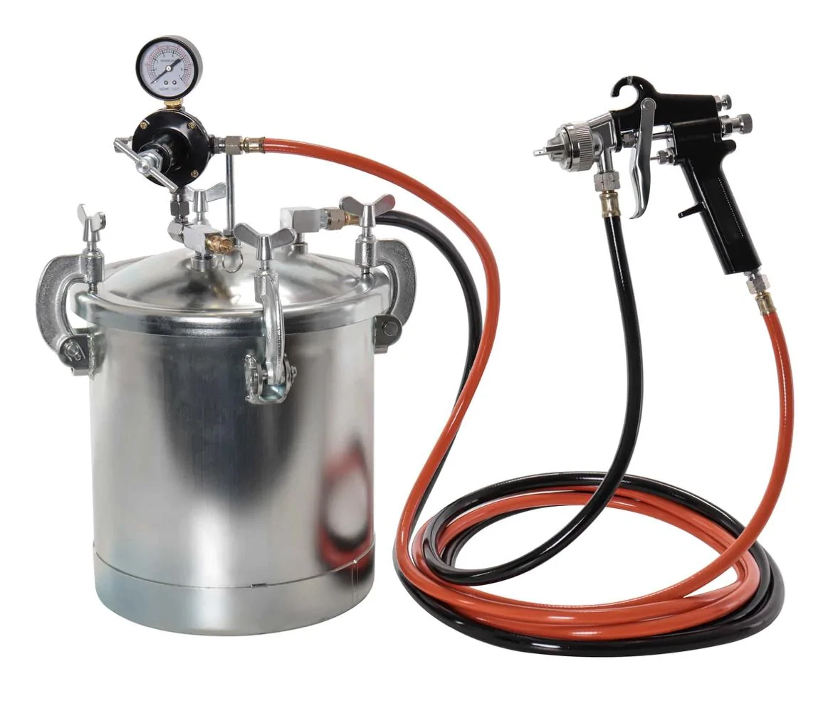

Removed the tires and skid plates. Used Corrosion X HD product. Purchased the 1 gallon size from Amazon. Applied with Harbor Freight pressure pot sprayer.
Results look good. Good control during spraying. very little over spray.
Will see how long it lasts.
