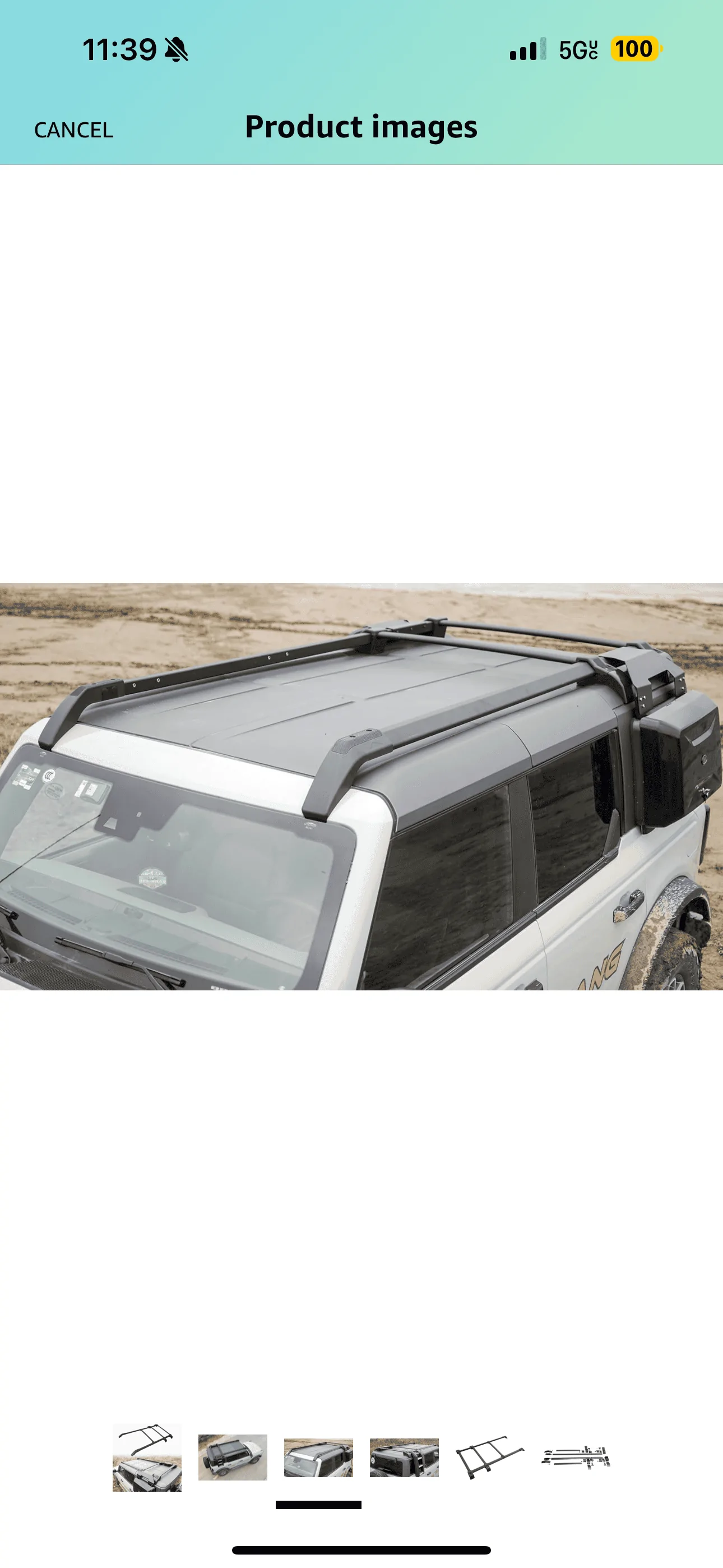

I ordered this OEM looking roof rack off of Amazon and installed it last night. When I went back online to look for an install video i saw that they had side accessories on both driver and passenger sides….
https://a.co/d/hqIJYeb
interested in finding these compatible accessories…

So I saw this rack a few months ago, how did the fitment end up being? I’d like to get the side ladder, pulling stuff out of the roof box is a little tricky.
Fits great! Looks like a bit more space in between the front 2 panels for ease of removal. I'll try to take some pics by this weekend.

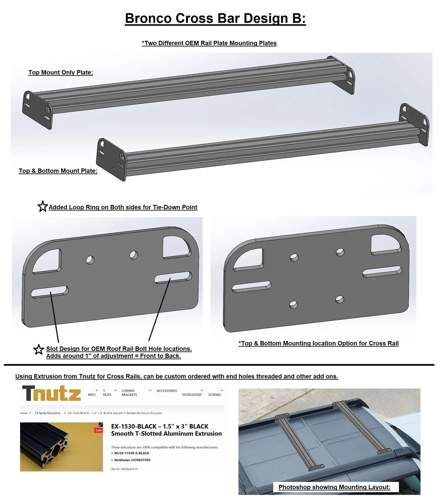

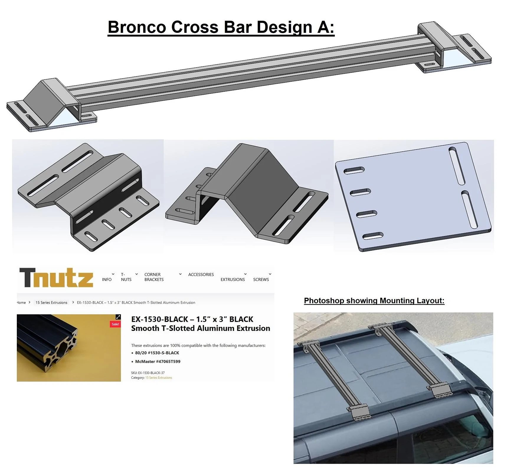

I'm surprised no one else has come up with more Mounting Options for the OEM roof rack but I guess since it's limited in it's capacity no one wants to put in the time to make anything.
Being that I'm an Engineer, I'm the type of person that will make my own parts if I can. That being said, I've been working on some Bracket/Mounting Plate designs for the OEM Roof Rack. These would be able to mount Aluminum Extrusion Cross Bars with T-Slots for more roof add on options. See my two designs that I created. I've seen something similar for other vehicles, but nothing for the OEM Bronco Roof Rack.
This is still a work in progress, so the designs are not final but I'd like to get some feedback.
I have a place that can laser cut the plates and bend them using Aluminum. I was thinking .187" thick should be enough and they can Powder-coat them.
Option A: essentially this has the Bracket follow the OEM Rail profile. I created a plate on the bottom to fully secure it to the entire Rail. I added slot holes for all mounting points to make it more versitile. On the outside extension part of the plate it has slots so anyone can add accessories like an awning or other items. You can add an Aluminum T-slot Extrusion bar along the outside to connect two of the brackets, thus making it more universal for adding more stuff. This one has a lot of bending involved so it will be higher in cost.
Option B: this is the simple approach that is similar to another roof rack manufacturer I saw but they don't have the bronco OEM rack add-ons like this in their line up. These simple plates mount the to the exsiting threaded holes on the OEM rails. You can mount the Cross Bar above the OEM rail or below the rail. I have two designs, one has both hole mounts.
I don't have anything laid out yet for the Cross bar in the back where it mounts to the Hardtop. The plastic covering is formed to match the oval OEM cross bars which dont have any T-Slots and they have thin walls too. I'm sure if you wanted to add one of the Rectangular Extrusions you would need to cut some of the plastic to fit it between the plastic covers. Something I'm still thinking about.
Nothing is set in stone for either design and I still need to make some test pieces via 3D printing to try out first. Right now I only have an estimated cost for what either option would take to make. I don't know what the weight capacity would be, since this is only preliminary design.
Most likely the cost could be:
Option A -Estimate: at least $250 or more per cross bar set = (this would include four plates -Left/right -top & bottom plates, +powdercoated, plus one black cross rail extrusion from Tnutz with the predrilled holes/tapped end holes etc.).
Option B -Estimate: $150 per cross bar set = (again it would include two plates for mounting one cross bar with the predrilled holes/tapped end holes etc.).
Granted those prices would be lower if I get a higher quantity made.
I'm also working on some other designs for other parts of the bronco.
Let me know what you all think and which one would you be interested in seeing.
Thanks!
