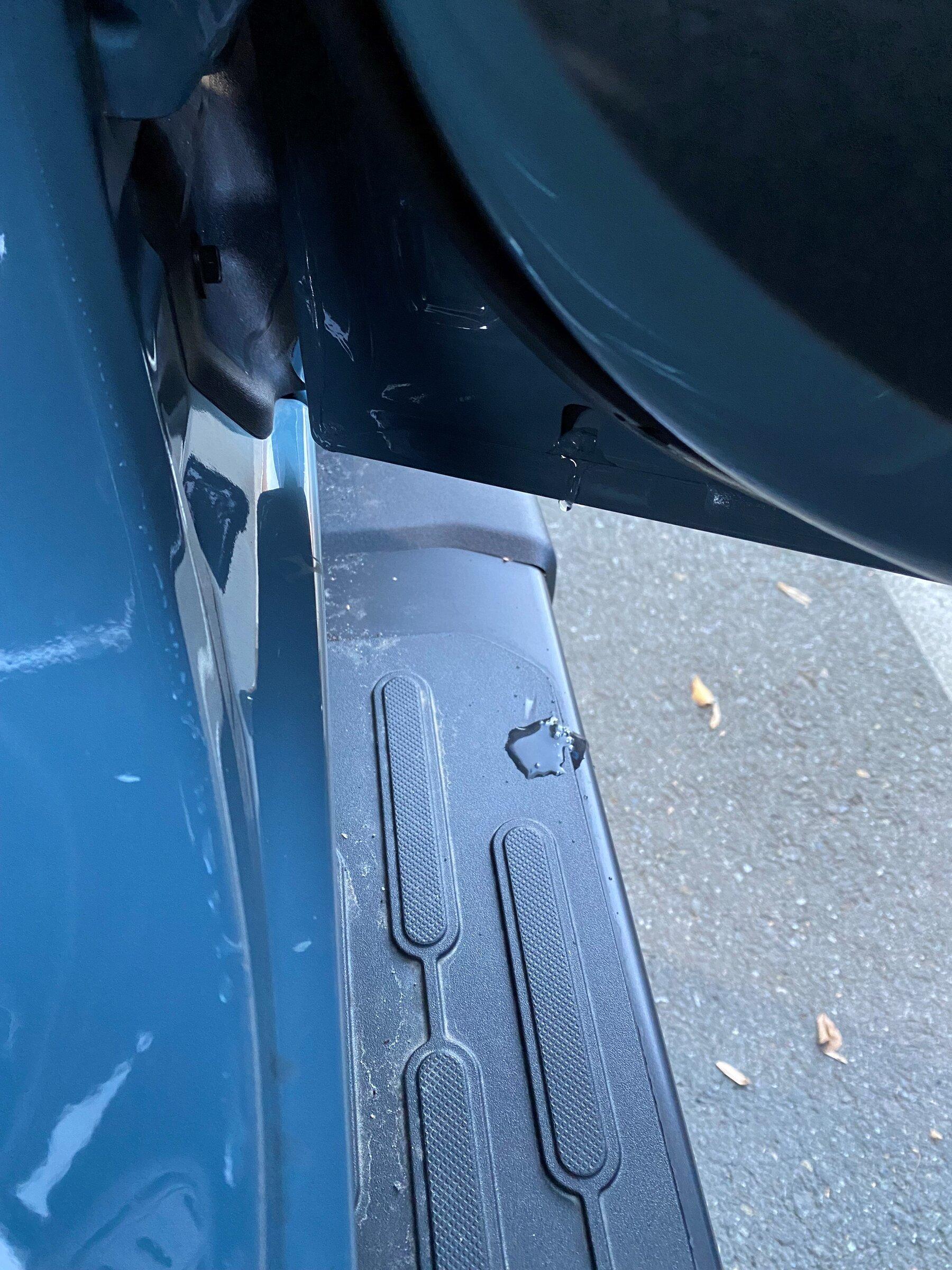

Brand new to the forum, just picked up my 4dr hardtop a couple of days ago which happens to coincide with actual rain in California. When I opened every door I noticed water draining out of these little cutouts in the lower part of the door. It seems like the water is being stored in the door. Is this intentional or a problem?

Hard to see in the picture but they appear to be factory drain holes working as designed. Unfortunately I have not yet received my Bronco to confirm.

That is normal with most all vehicles. There are small drains in the doors because the window seals are far from watertight.

Those are weep holes for water drainage, my '16 F150 has the same thing. After a wash or rainy weather I always open the doors, make sure the holes are clear of debris and dirt, and give them a little shake. Otherwise the moisture will just sit inside the doors.
