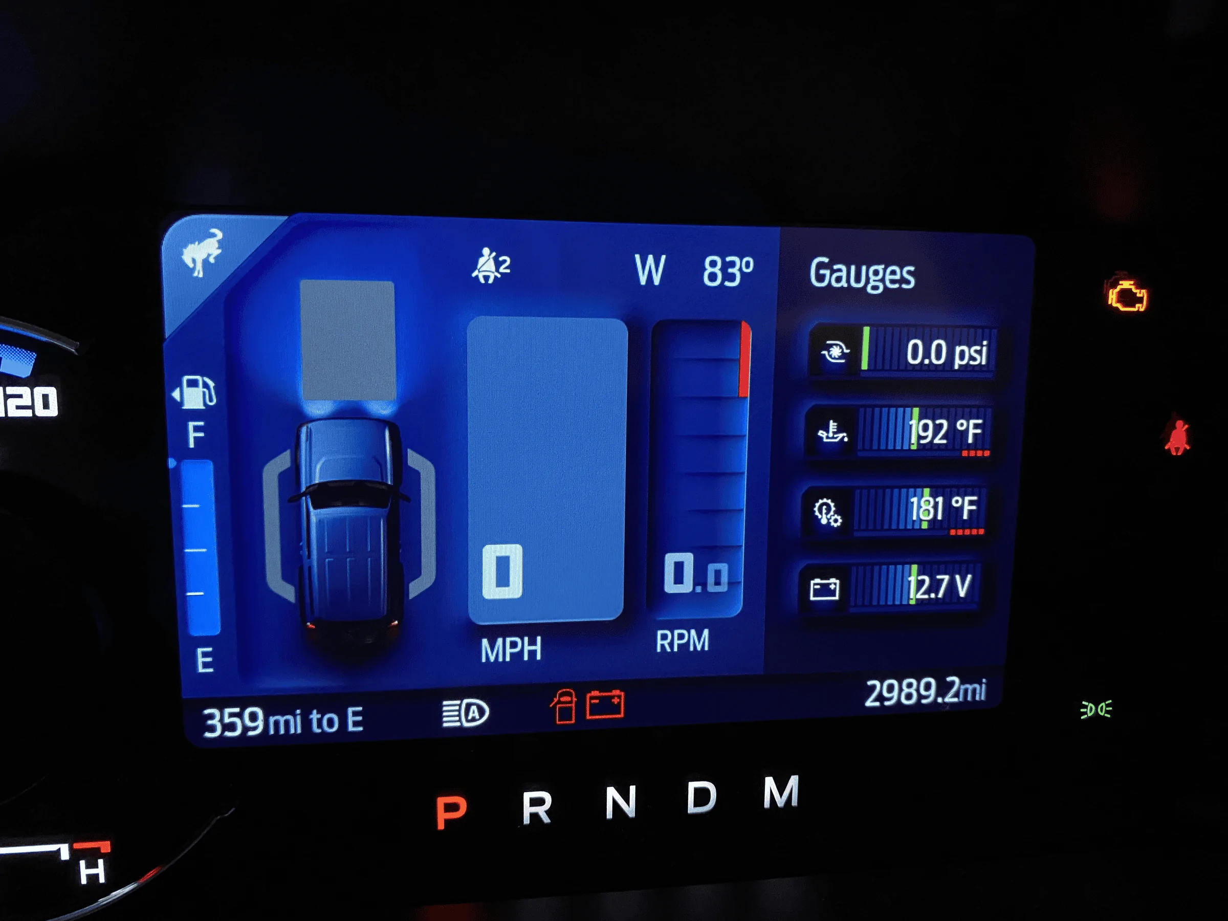

Took my doors off for the first time this week and it was awesome! Did get the random parking brake engagement someone mentioned. Also had the dash screaming at me to say that collision avoidance was disabled. Both of those only happened once.
Now though, doors are back on and I have two warning lights showing, ONLY when I'm in full accessory mode. looks like this:
Ford Bronco Doors off creating gremlins tempImage8V8mcP
I've unplugged and plugged back in all four door electrical connectors and even full disconnected the battery for 30 seconds. Still showing the battery and engine lights.
Not there when I start up and drive. Drives perfectly normal. Got me stumped.
Hi there. This doesn't sound like an experience we want you to have with your Bronco. Could you please send us a PM with your VIN and the name and location of your Ford dealer? I'd be happy to look into how I can assist you with this warning lights concern on my end.

Thanks. VIN and dealer name just sent via DM

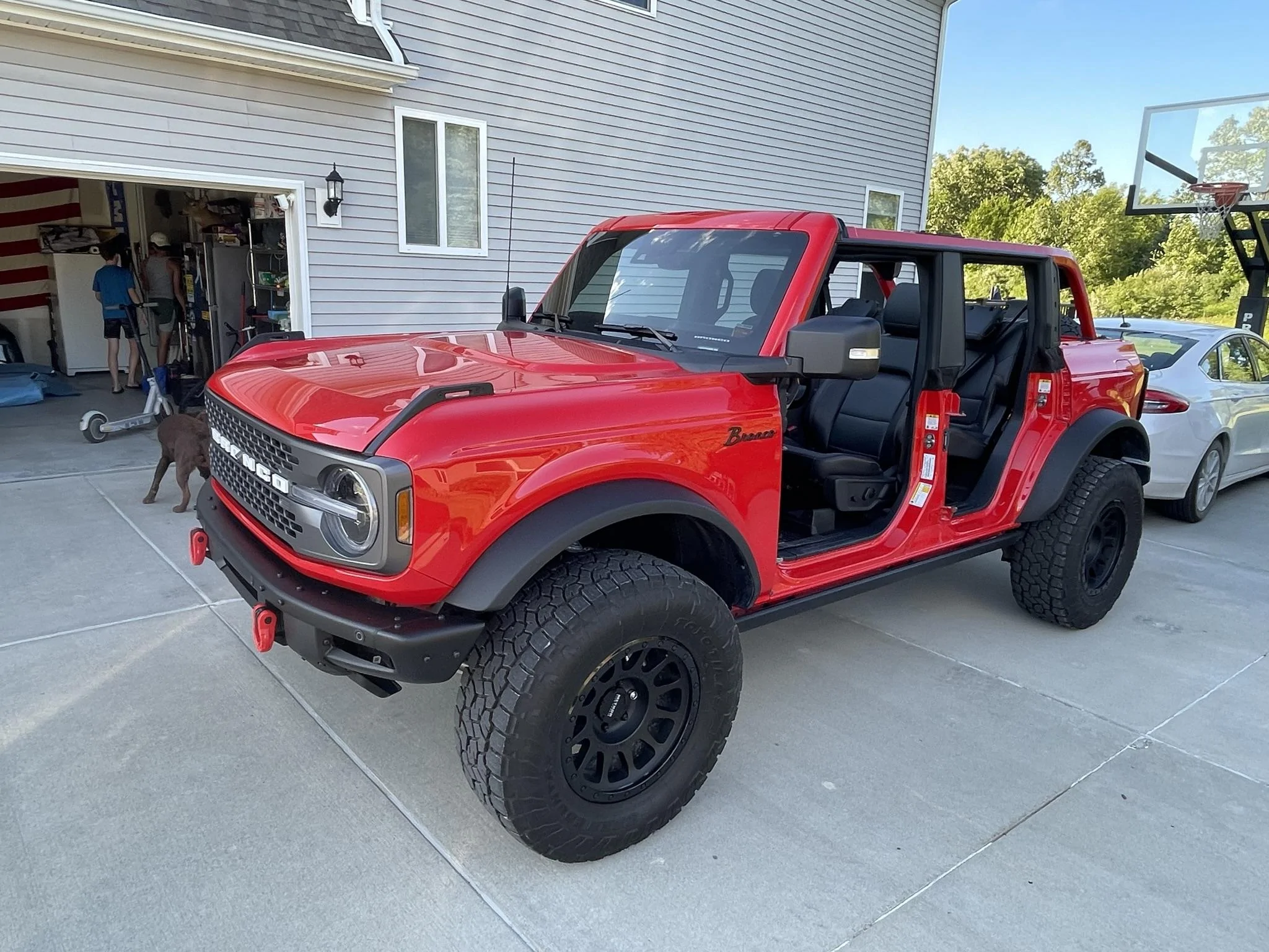

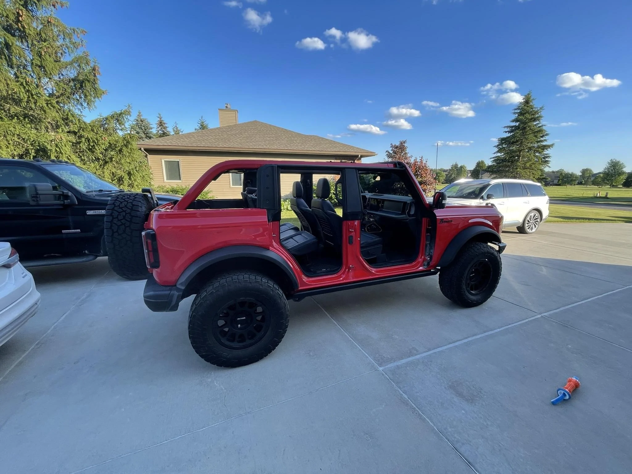

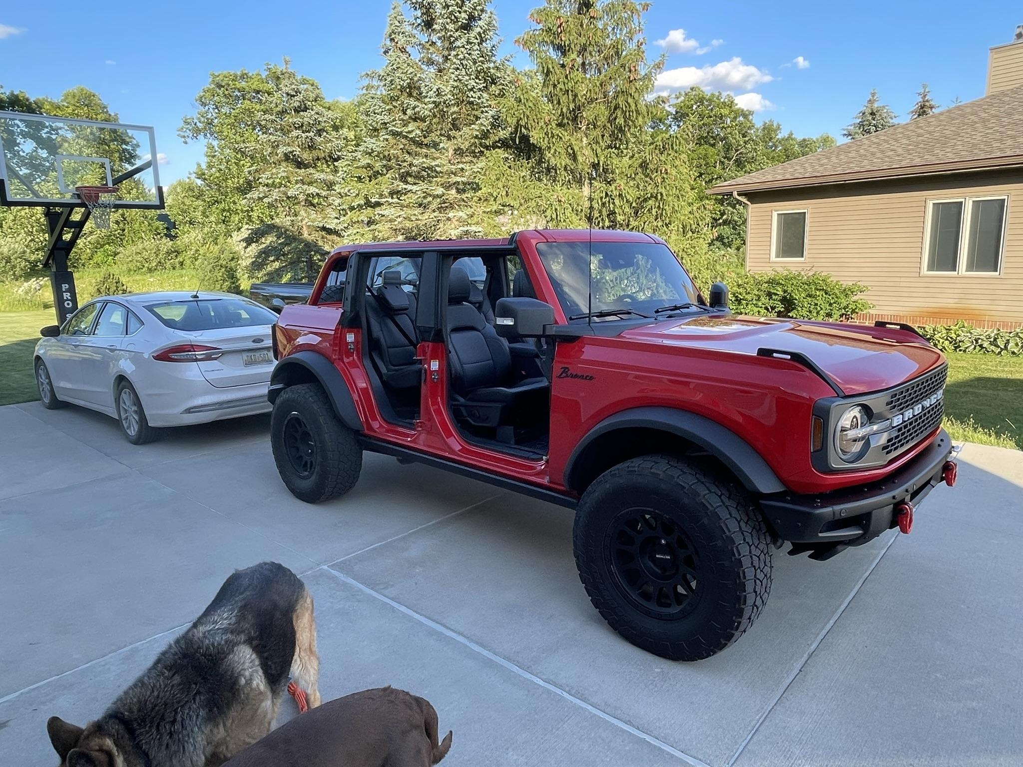

my apologies it is a sin to post the most awesome thing about this vehicle without pics. Sorry here I go……..
Ford Bronco Doors off creating gremlins 1D171AEC-44D2-4026-8E41-0044EDA48BD4
Ford Bronco Doors off creating gremlins 581EE3D0-0644-45FB-8AAB-E763438DC45E
Ford Bronco Doors off creating gremlins DE96755C-2D91-4C74-A972-951B90DFACB0
