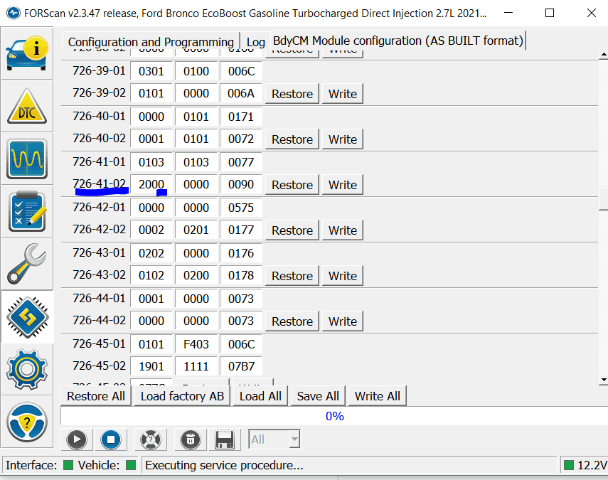

I am attempting to remove the annoying double honk, I downloaded the latest version of FORScan, bought the appropriate ODB adapter, made sure the drivers were loaded. Plugged in ODB, turned vehicle to ON (not running), saved backup files for all 'AS BUILT' files. Then when I decided to go into the BdyCM module to adjust the double honk, the value is already zero see attached.
I can't find a similar thread to this problem so am looking for help for anybody who may have run into this and solved it. Thank you in advance.

wrong area, 2xhonk is
726-63-02
edit heres the full thing. you are right about the fourth trailer being zero:
Double Horn Honk disableBdyCM726-63-02xxx*xxxxxx--0 = disables double honk when exiting running vehicle
double post edit, you are looking at the expedition! use this for the bronco:
FORScan - 2021+ Bronco - Google Sheets

Thank you! That works.
