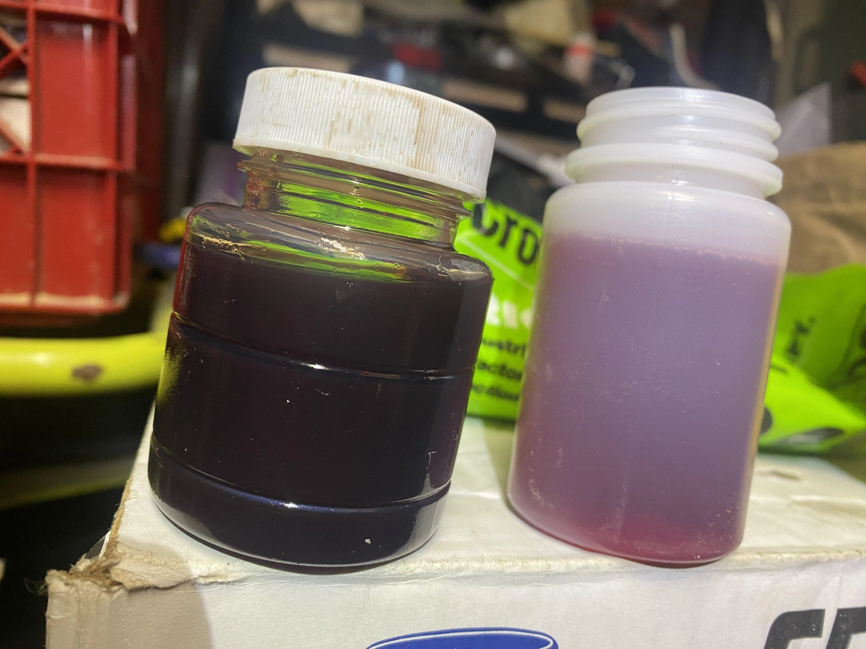

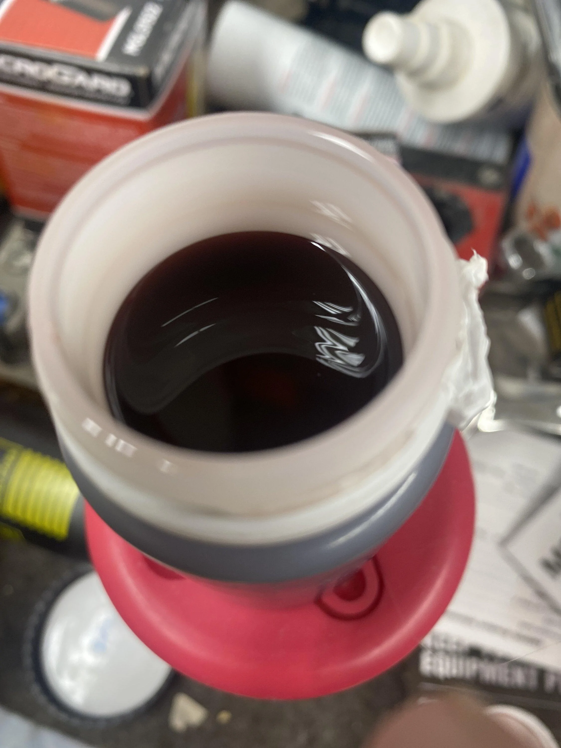

This is my transfer case fluid .. Had three winters on it ( 4x4) and has only 6700 miles..
the front differential ( 1 quart) was just as metallic and dark.. I havn’t got to the rear differential yet.. Ford Store has shipped the other two rear differential covers I ordered.. Shipping problem! That’s gone on three weeks!!

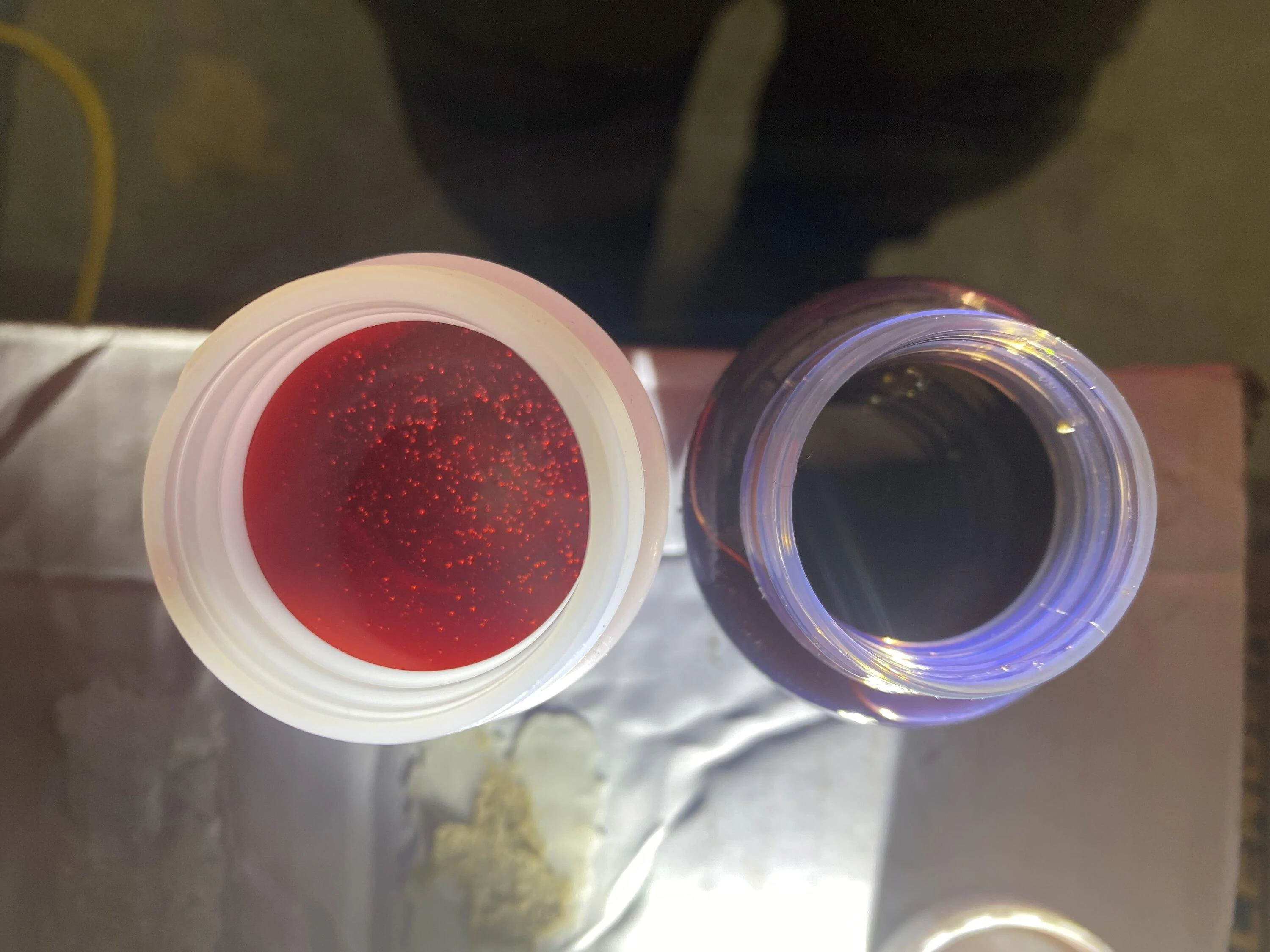

Okay, time for everyone to drop that Transfer case ( TC) fluid ( especially if you have not done that before). I drained the fluid today on my 2023 Badlands with only 6800 miles.. This is its first winter but I got a liking to the 4A and it has spent most of the last month in 4A until today. I was able to drive the highway in 2H .. Here is the fluid at the 6800 miles vs. clean Mercon LV.. Unfortunately, there was no magnetic plug installed at the drain so no metal could be noted..

Transfer case fluid 6800 miles in a 2023 Badland …
