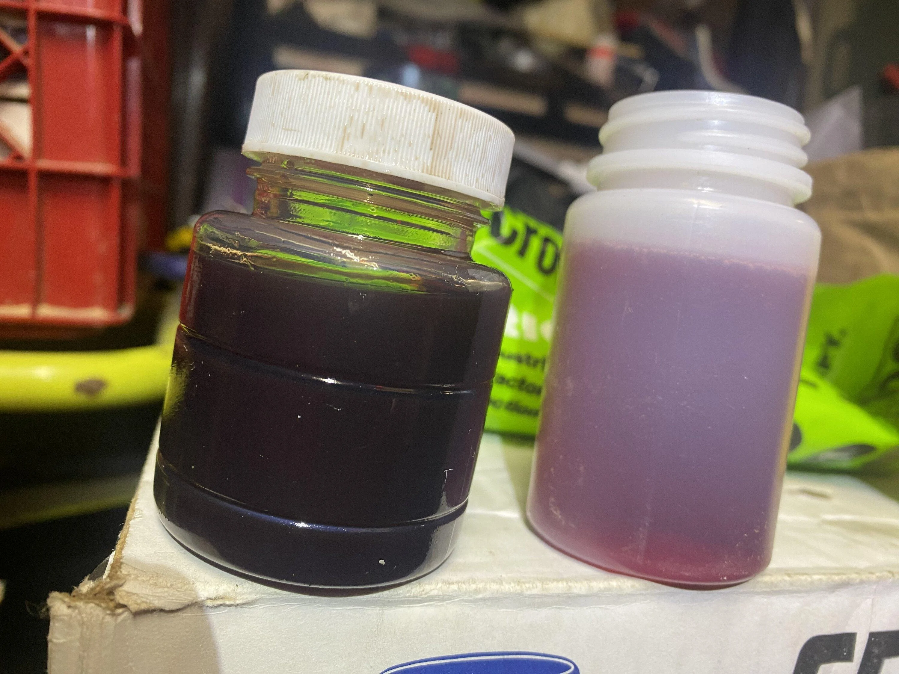

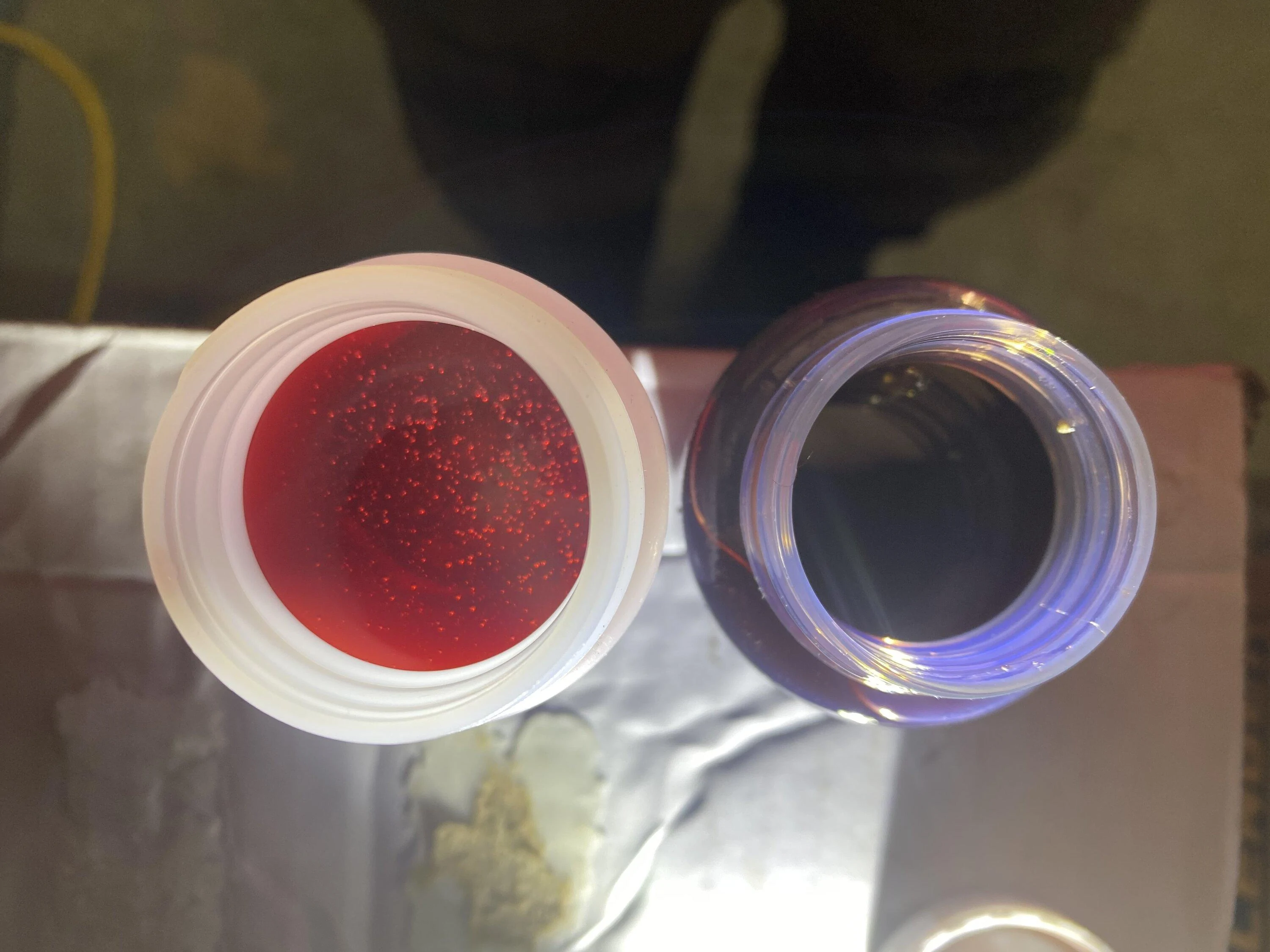

Hi, here is the sample from my 2023 Badland with just 6800 miles.. I suggest you drain the Transfer Case and save a sample of the fluid. carefully watch the drain plug that it is magnetic and will give an indication of metal in play.. Bright red fluid is new Mercon LV.. Dark fluid is right out of transfer case with 6800 miles.. The transfer case uses two quarts of Ford Mercon LV fluid..
