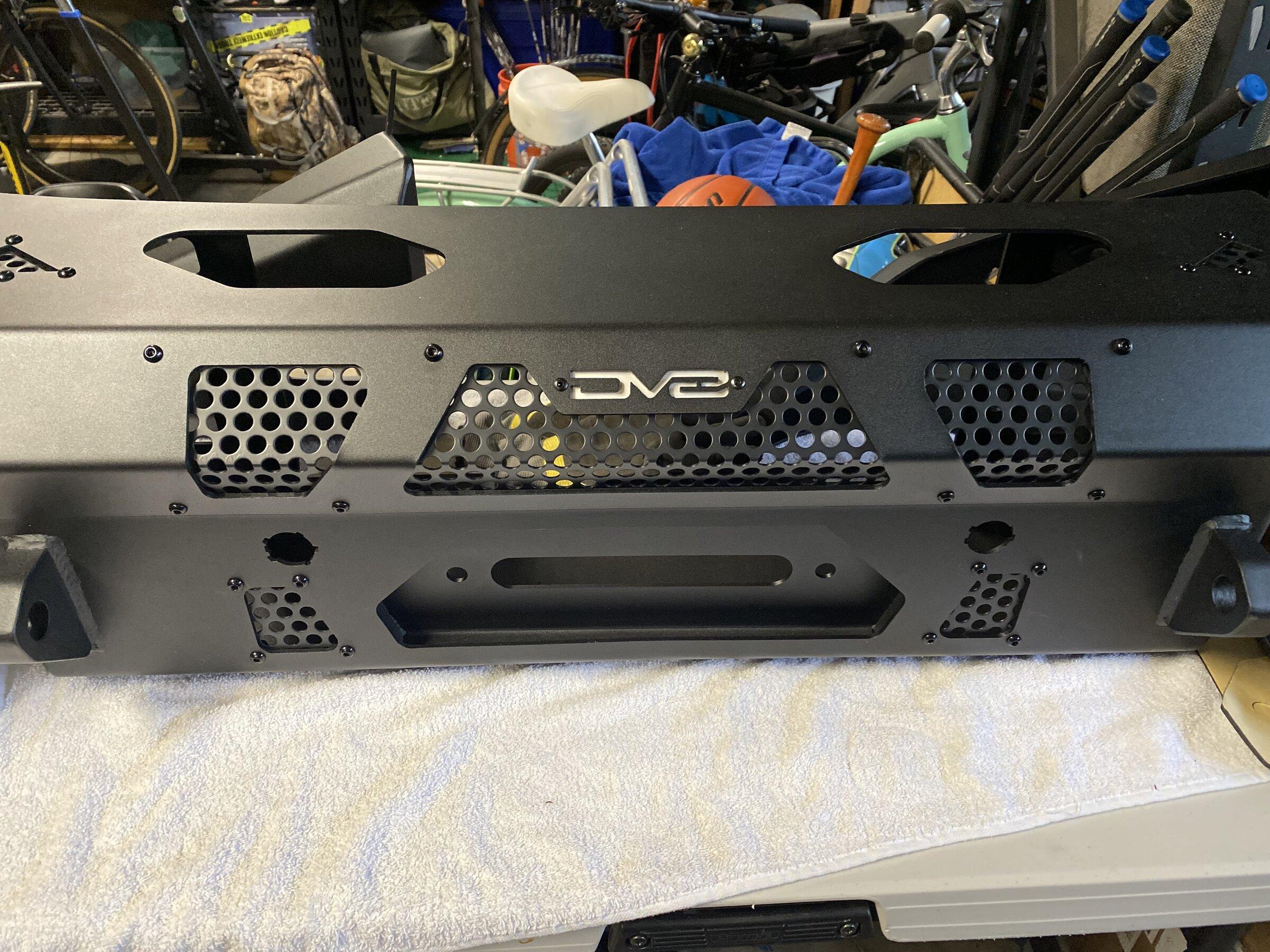

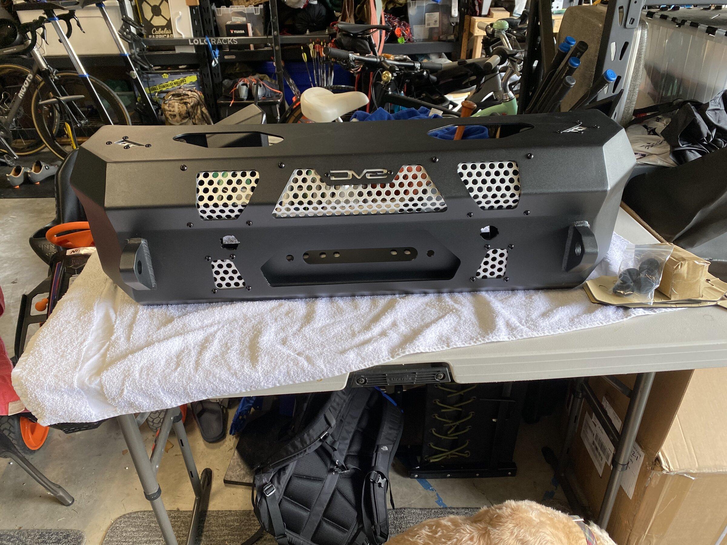

What are your impressions of the quality/fit/finish of the bumper? Welds? Powder coat?

Overall quality looks really good to me. Time will tell how it holds up. Tight would be an understatement! I have XL size glove hands and feeding the bolts into the bumper is TIGHT!
My main issue with the install was getting the three brass bolts to re-align in the holes that secure the bumper to the Bronco. There is a factory nut plate that you are told to remove in the instructions but there was no hardware to secure the DV8 bumper. I was able to secure one sides 3 bolts but the other was a no go. I needed up chopping the nut plate to separate the 3 bolts into 2 sections to give me some more wiggle room. I don't think this is a big issue as the "nut plate" seems to just be a large washer to speed up production. After many adjustments and readjustments I was able to to get the other three bolts in and finish the install.

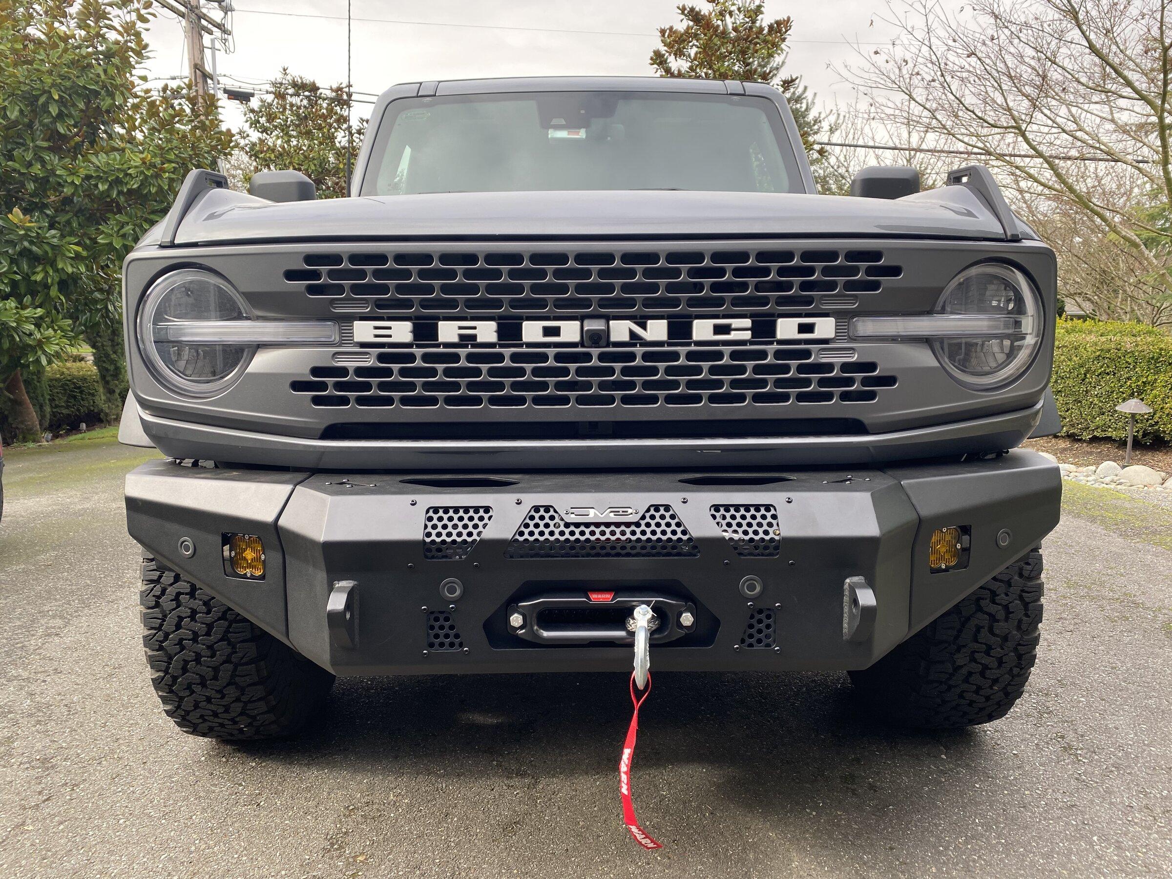

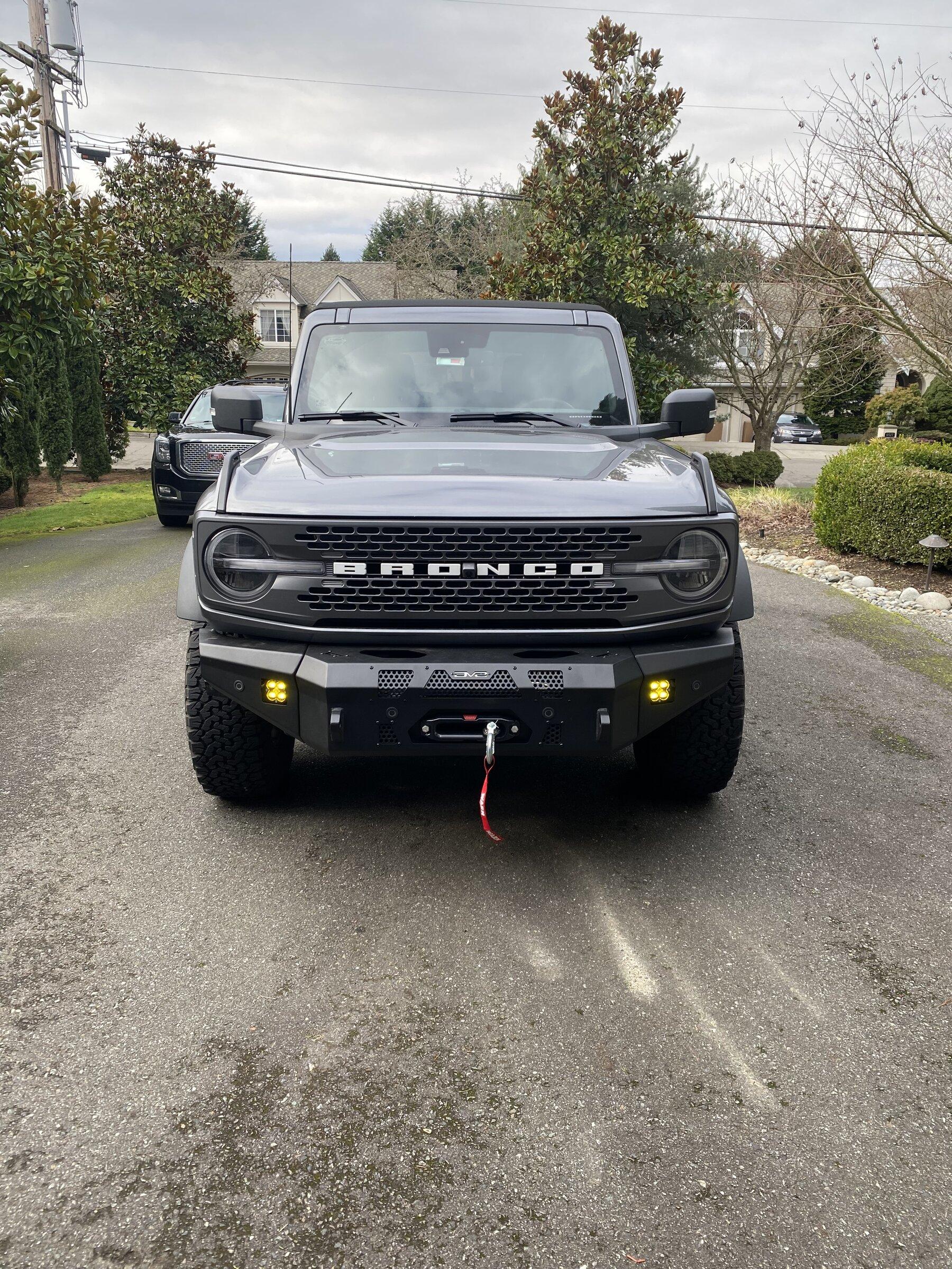

I installed the new DV8 bumper with a Warn evo 10k and, Wow, that was a lot harder than I thought it would be!

Looks great. I was thinking the same thing about painting the silver mesh black if I get the DV8.

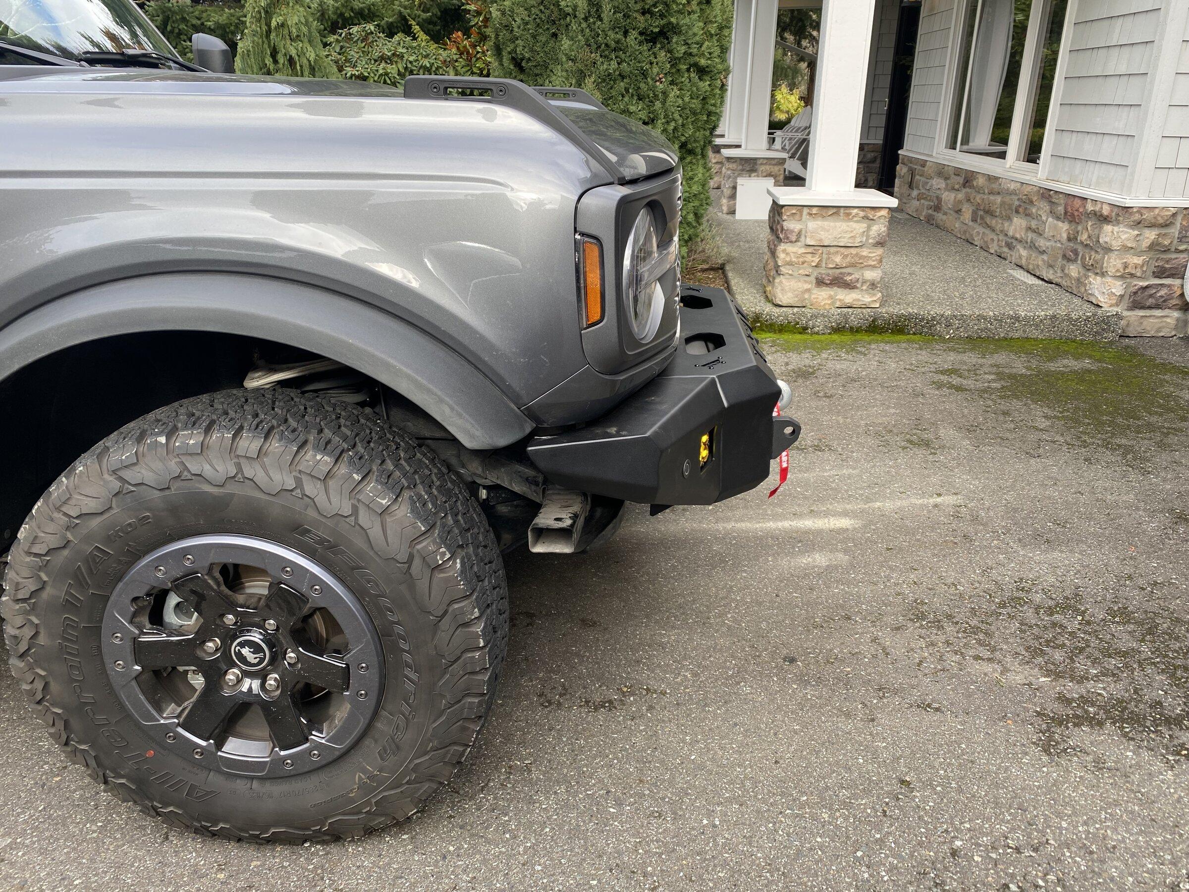

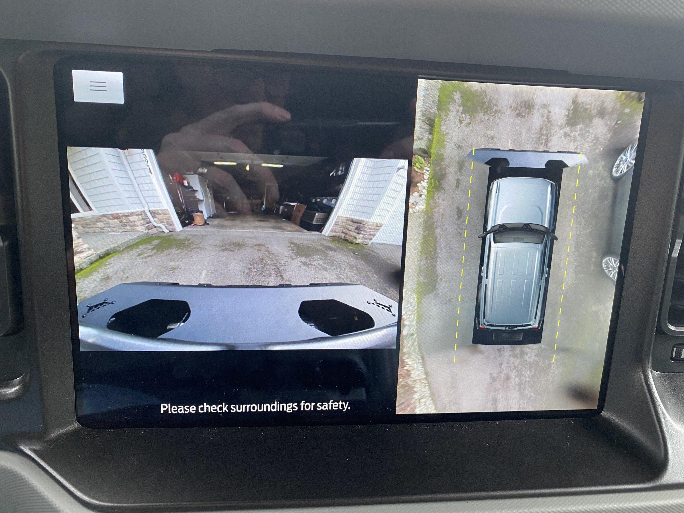

Maybe it is the angle of the camera, but that front shot makes it look like the approach angle is extremely reduced. Is it just the angle of the camera, or does it make that front nose longer and lower?
The approach angle will be reduced slightly as the bumper does extend out more than the mod bumper. The winch sits nice and low so it doesn't block the camera like the one from ford and a few other manufacturers. There are compromises in everything, this is what I went with and it is staying put!

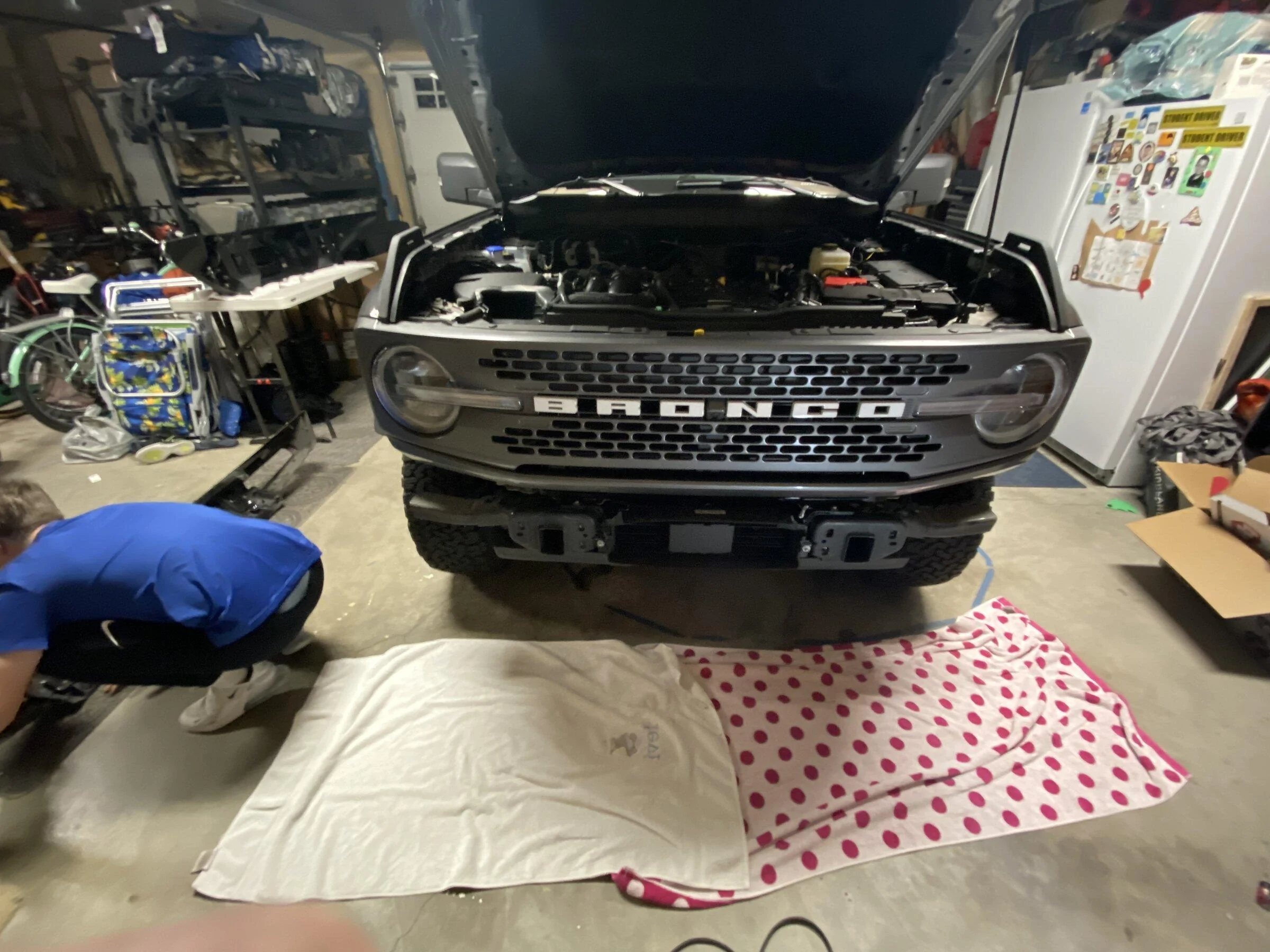

Mine is arriving today (just the bumper b/c I haven't settled on a winch yet). @PatioDaddio78 do you have any advice on making the install as painless as possible? Open to any and all thoughts.
Make sure you have all the bolts! I called DV8 about my install issues, and they said that there should have been nuts for the bumper install bolts. Its a two man job as well. I have an old wooden chair that fit under the bumper to hold in place instead of holding up on my own that seemed to work pretty well. If I had all the intended hardware it would have been much easier.
