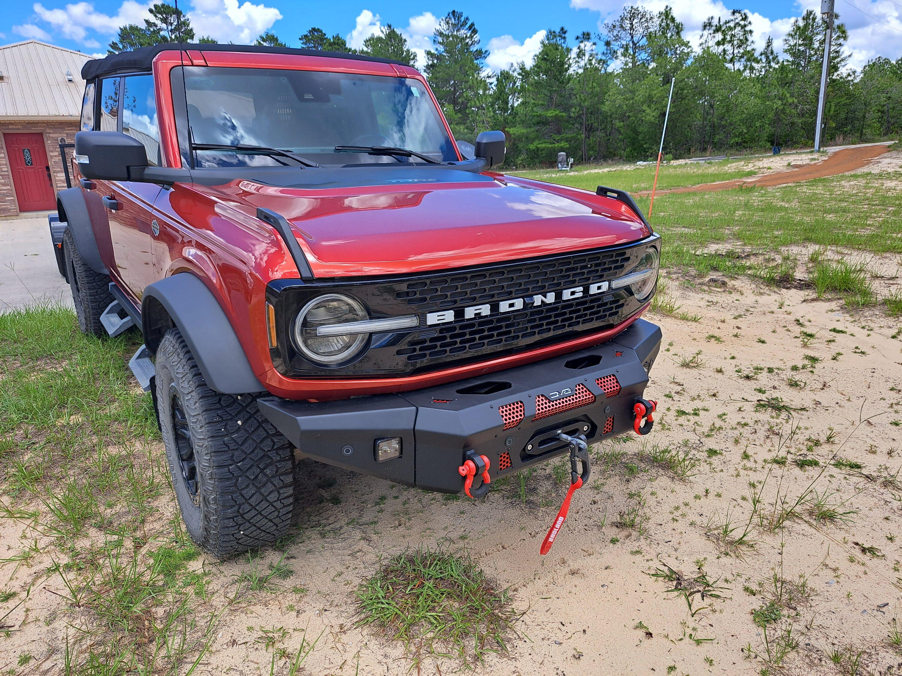

Overall quality looks really good to me. Time will tell how it holds up. Tight would be an understatement! I have XL size glove hands and feeding the bolts into the bumper is TIGHT!
My main issue with the install was getting the three brass bolts to re-align in the holes that secure the bumper to the Bronco. There is a factory nut plate that you are told to remove in the instructions but there was no hardware to secure the DV8 bumper. I was able to secure one sides 3 bolts but the other was a no go. I needed up chopping the nut plate to separate the 3 bolts into 2 sections to give me some more wiggle room. I don't think this is a big issue as the "nut plate" seems to just be a large washer to speed up production. After many adjustments and readjustments I was able to to get the other three bolts in and finish the install.
Same issue here. They did not provide nuts for the mounting. Trying to use the nut plate and got most of them in but having a hard time with one side. Not sure why they would not use the mounting plate and I am going to try to make it work. I also have huge hands and these thirds bolts are beyond ridiculous.

Chop the plate up into separate pieces. That was the only way I could get it to work. Good luck!

How did you run the winch cables? Ask the way through and out the drives dude wing?

What I did is take a small stick and insert it from top of engine compartment behind drivers headlight going down. There is a small path there. Then tape the winch cables and any other wires for lights to the stick and pull it back up. Blammo! Cables all in and just need to zip tie to secure wherever they are running.
