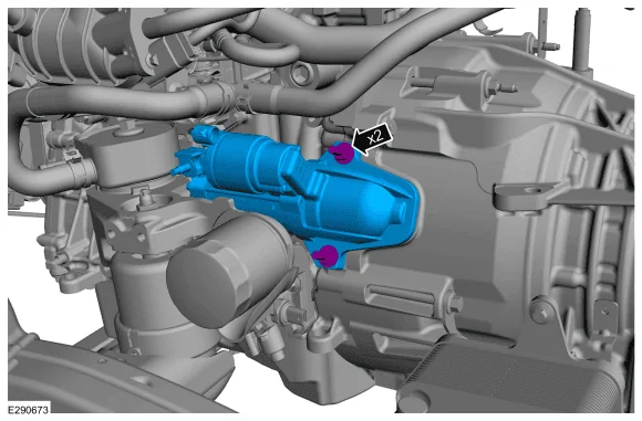

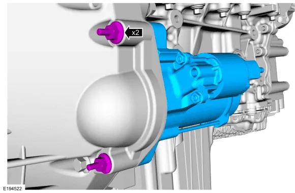

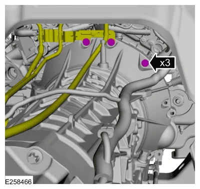

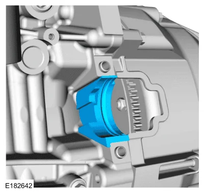

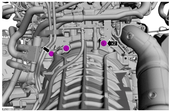

Based on what I could glean from 20 Ranger 2.3 w/10R80 vs. 20 F150 w2.7/10R80 they are COMPLETELY different. Even the starter mounting is totally different.
Ford Bronco Engine Bolt Pattern same between 2.3L and 2.7L? 27bell
Ford Bronco Engine Bolt Pattern same between 2.3L and 2.7L? 27starter
