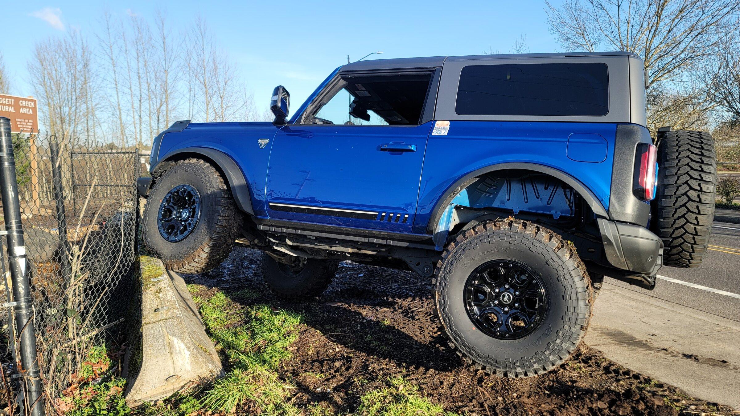

Absolutely they will fit and look better too!
How has that worked out for you? I plan on doing similar to mine. post a picture with it not flexed out? Looks badass!

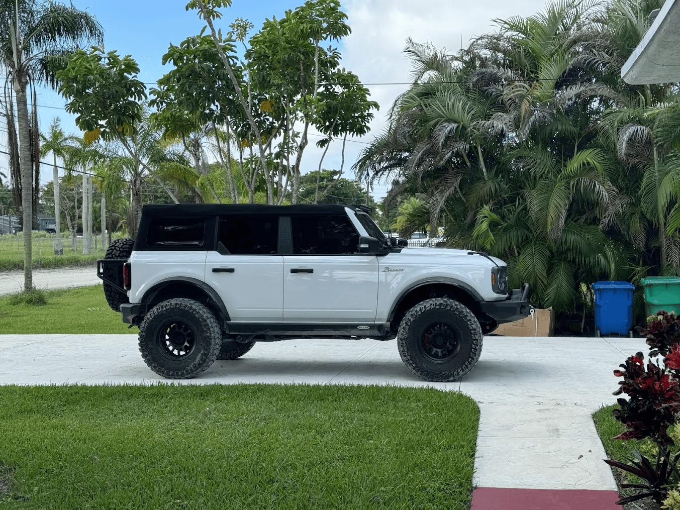

Nice setup. I run Fabtech's but I did not have a SAS, and I went with the full system. On a non-SAS setup, it put me at 4' coil over with 2.5 res. I also have the link bars in the back, basically everything sans the tire rods, which came out after I had done my kit.
I love the Fab system, rides smoothly and is very capable on the trails. I am also on Cooper 37
