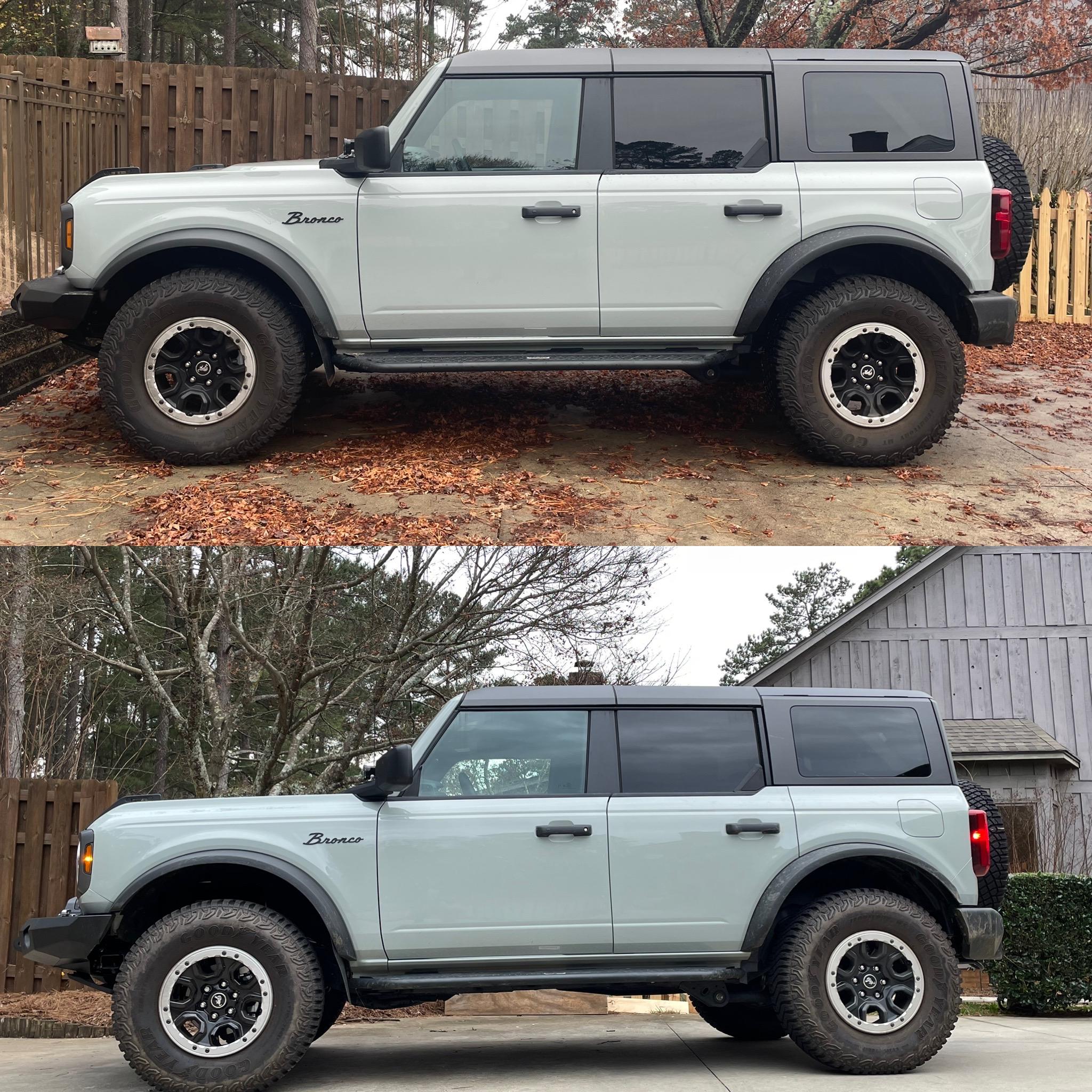

Which size leveling kit would y'all recommend for a stock Outer Banks?

Depends on what size tire you plan to run and how much wheel well clearance you want.
If you do a forum or Google search for "Bronco level" or "Bronco spacer lift" you will find a ton of pics and information.

I installed the 1.5"(got closer to 2" of lift) Fab-tech kit on my SAS and I'm very happy with the results, but I had also lost about 1/4"+ of height in the front due the weight of a warn bumper and winch install. If you want it to be level and not higher in the front, I think a 1" would be what you'd want.
Comparison photo isn't the best because it was taken from a slightly different elevation but it will give you a general idea.

Thanks for the photo! looks awesome. Off topic, can I see your custom sleeping platform??

Also, check this post out- it shows a SAS with this kit installed but he doesn't have the weight of the bumper and winch like I do so you'll get a better idea of what results you can expect (assuming you don't have the warn bumper and winch.) To me it looks just slightly nose high but still looks great. Just depends on what you are looking for.
