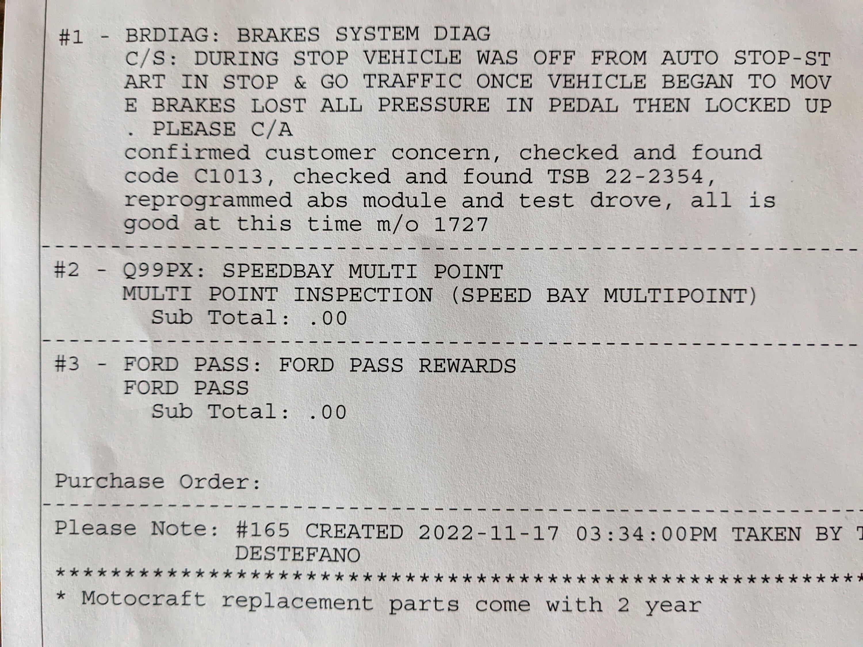

You might want to take it in again. I got it back yesterday, and they acted on a different TSB from the one they initially referenced. I'm assuming this is the software fix since the TSB is too new to be listed on any 3rd party sites yet (or the dealership lied). See below:
