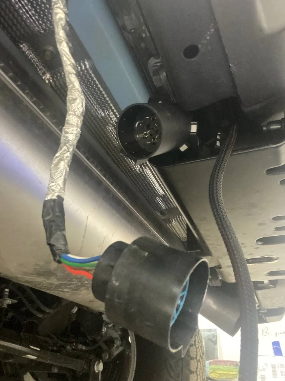

If you have the powder-coated steel ‘Capable’ rear bumper, the Diode Dynamics hitch mount reverse light is NOT your solution. I tried the install and the DD harness extension/adapter and factory harness wouldn’t fit inside the Ford OEM hitch mount and it was all going to be dangling right in front of the muffler no matter how I secured it. I guess I could have wrapped it in heat tape but it was going to be visible from behind and crappy-looking.
Ford Bronco Features questions - 2025 Bronco IMG_1785
