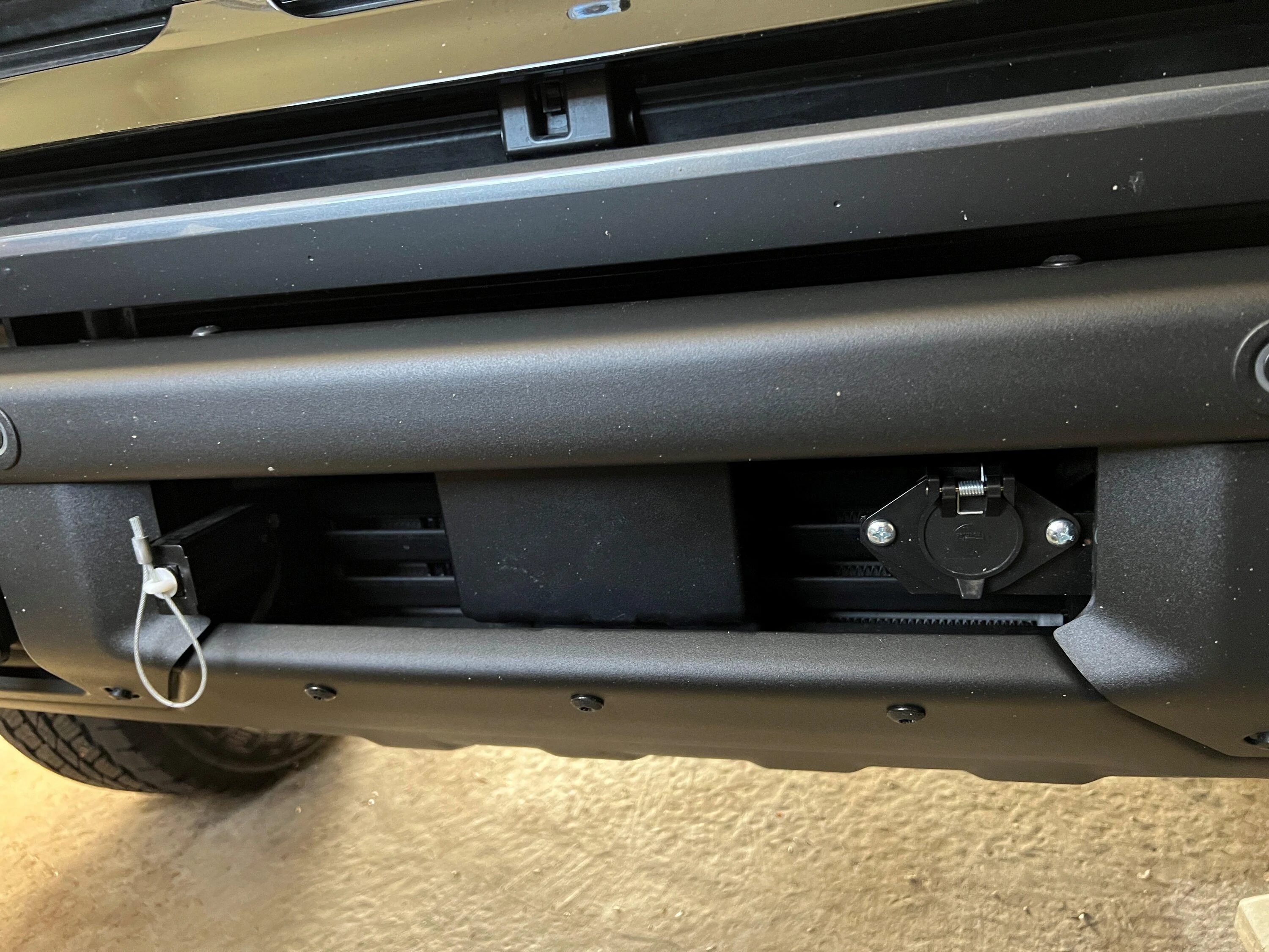

Blue Ox Base Plate BX2692 (Replaced previous model BX2688)
Blue Ox 10k Avail tow bar BX7420 (2" receiver)
Blue Ox Towing Accessory kit BX88308

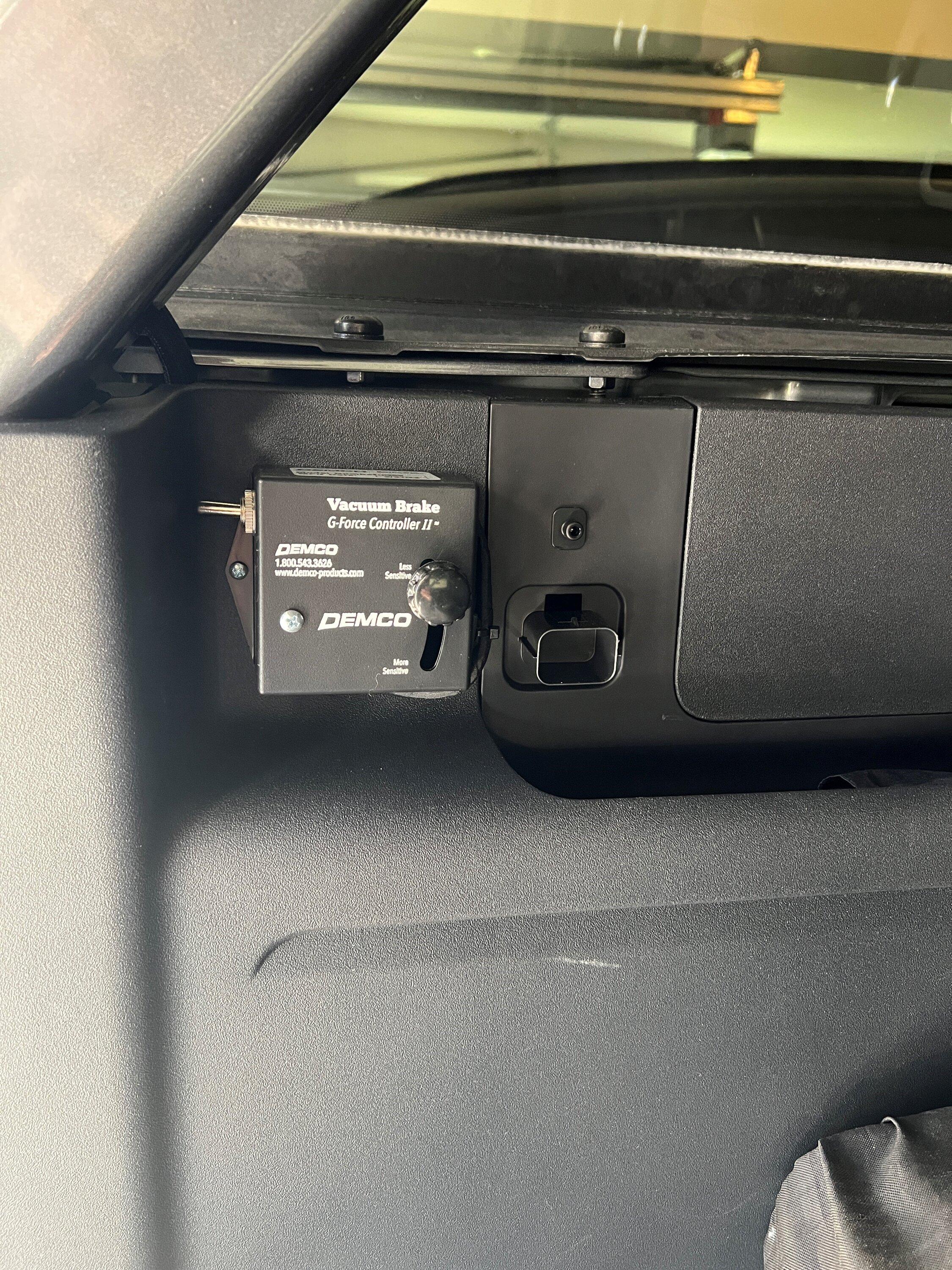

Stay-In-Play Duo Brake System perm. mount. Main control unit mounted under hood, switch mounted left rear inside.
Hope that helps!

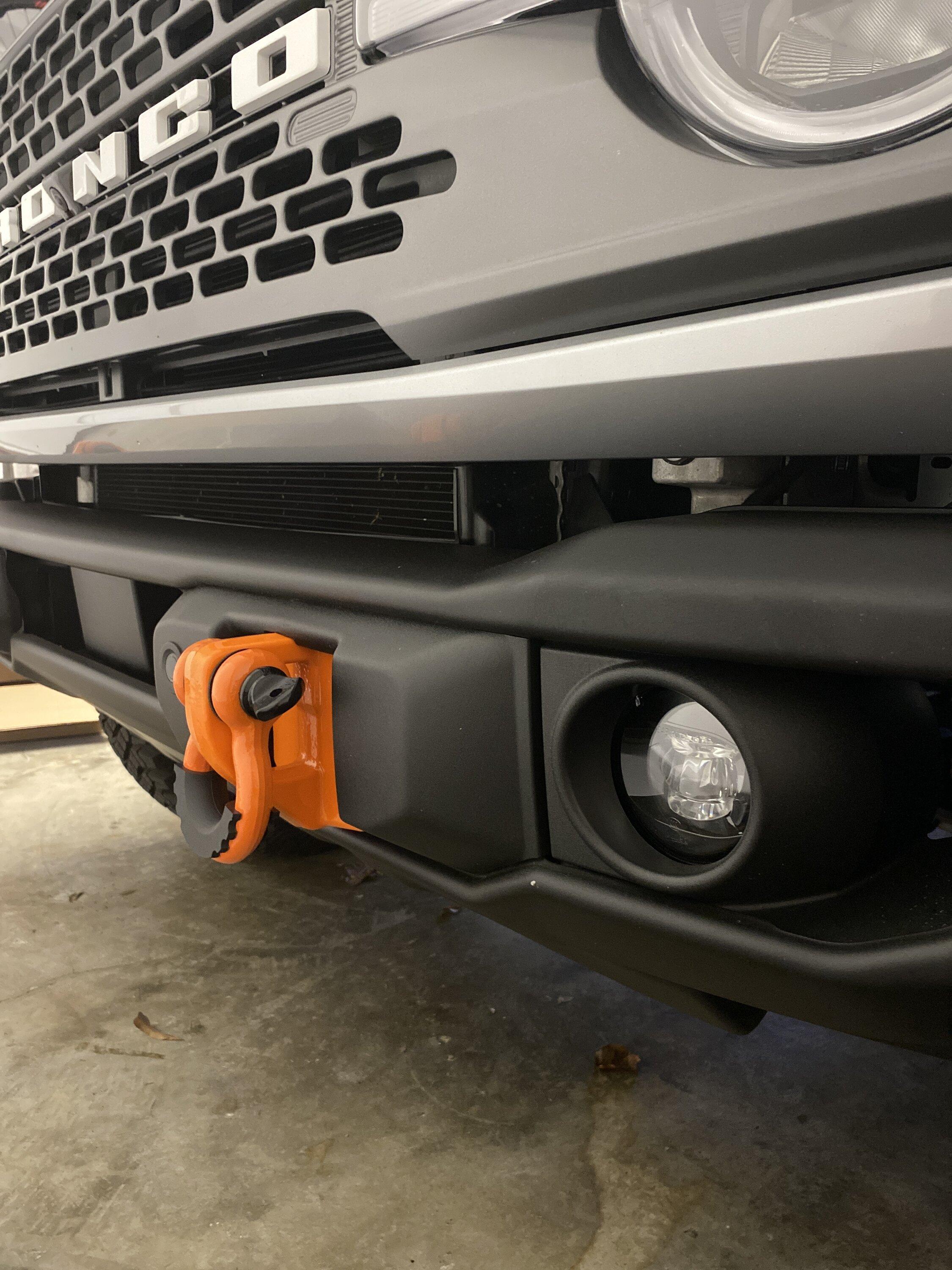

Todd, are you using the recovery hooks or are you using the base plates? Those orange hooks with the D rings are factory?

The Black D-Ring Loops come with the Capable Bumper. I replaced those with the Orange D-RING plates from Ford. Then I bought the Tow Bar adapters from Curt.

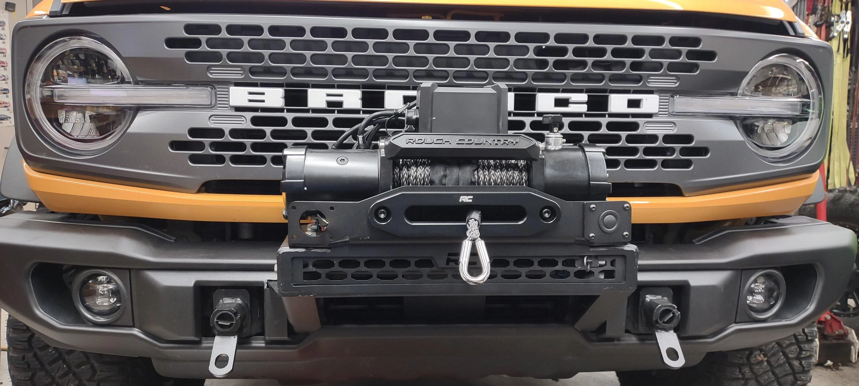

Base plate plus a winch on the capable bumper

Could you please share links to both the D-Ring plates from Ford and Curt tow bar adapters?

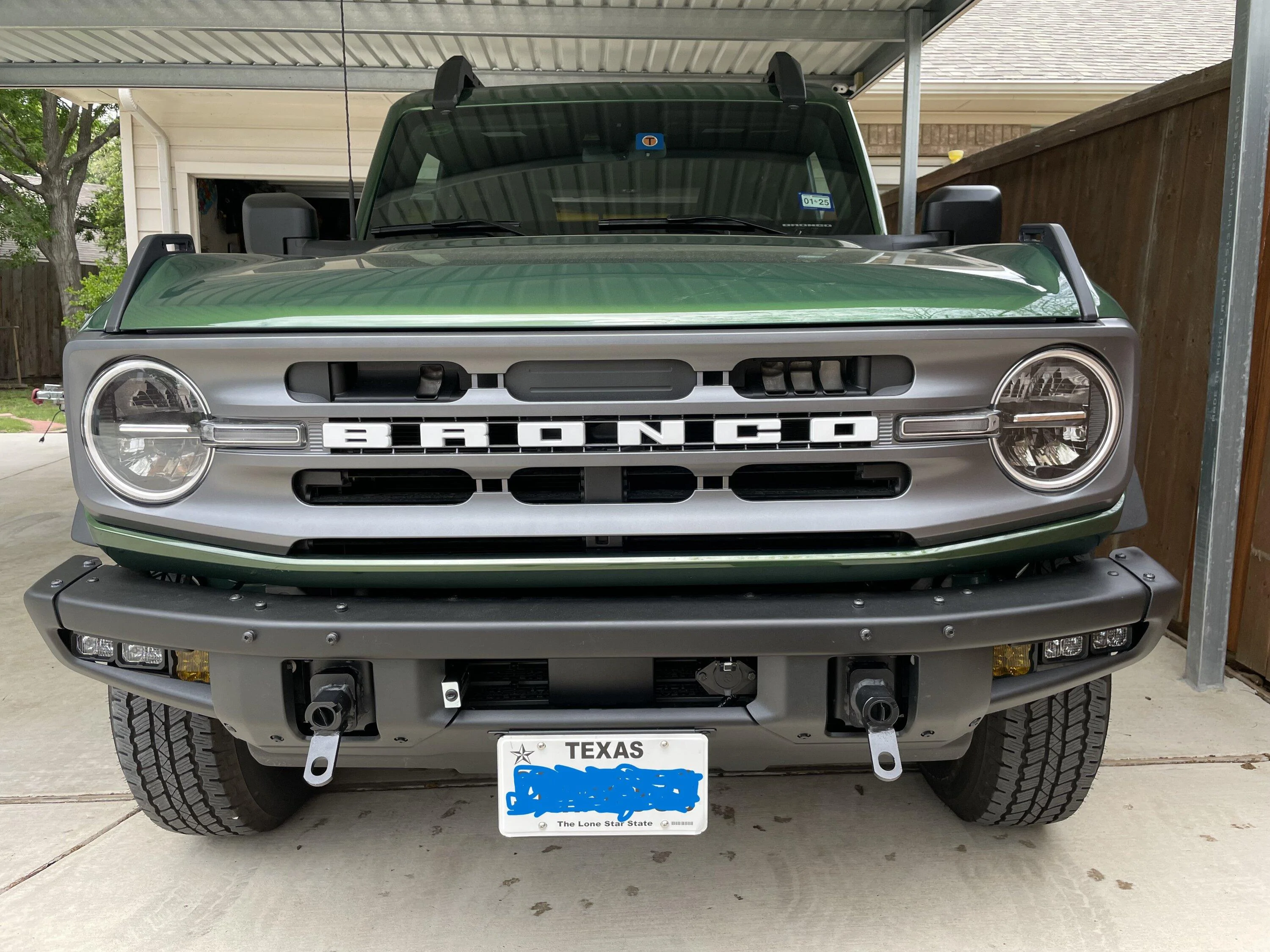

Thanks for the advice Tony. Just spent around 2 weeks on my buddy's lift. Completed the blue ox adapter installation, back light to front connector wiring, and while I was at it, put some fog lights in. I used some advice from the forum here and can turn on the fog lights with a factory switch I replaced.
I got a good deal on a Blue Ox Patriot manual install brake system, so I went with this. Can see how your permanent install unit would be very appealing though. Wish me luck as I move on to connecting to the RV next!
Bet this looks kind of familiar ;):

your set up looks great, trying to do the same to my MY22 BL with the capable bumper; tried to do a quick sawp with the performance Rings but it looked like the steel trim retainer was getting in the way and the plastic trim wouldnt fit in with the top?
Did you have to snip/trim any of the Plate Facing plastic trim or steel trim mounts to get the Orange D ring plates to fit?

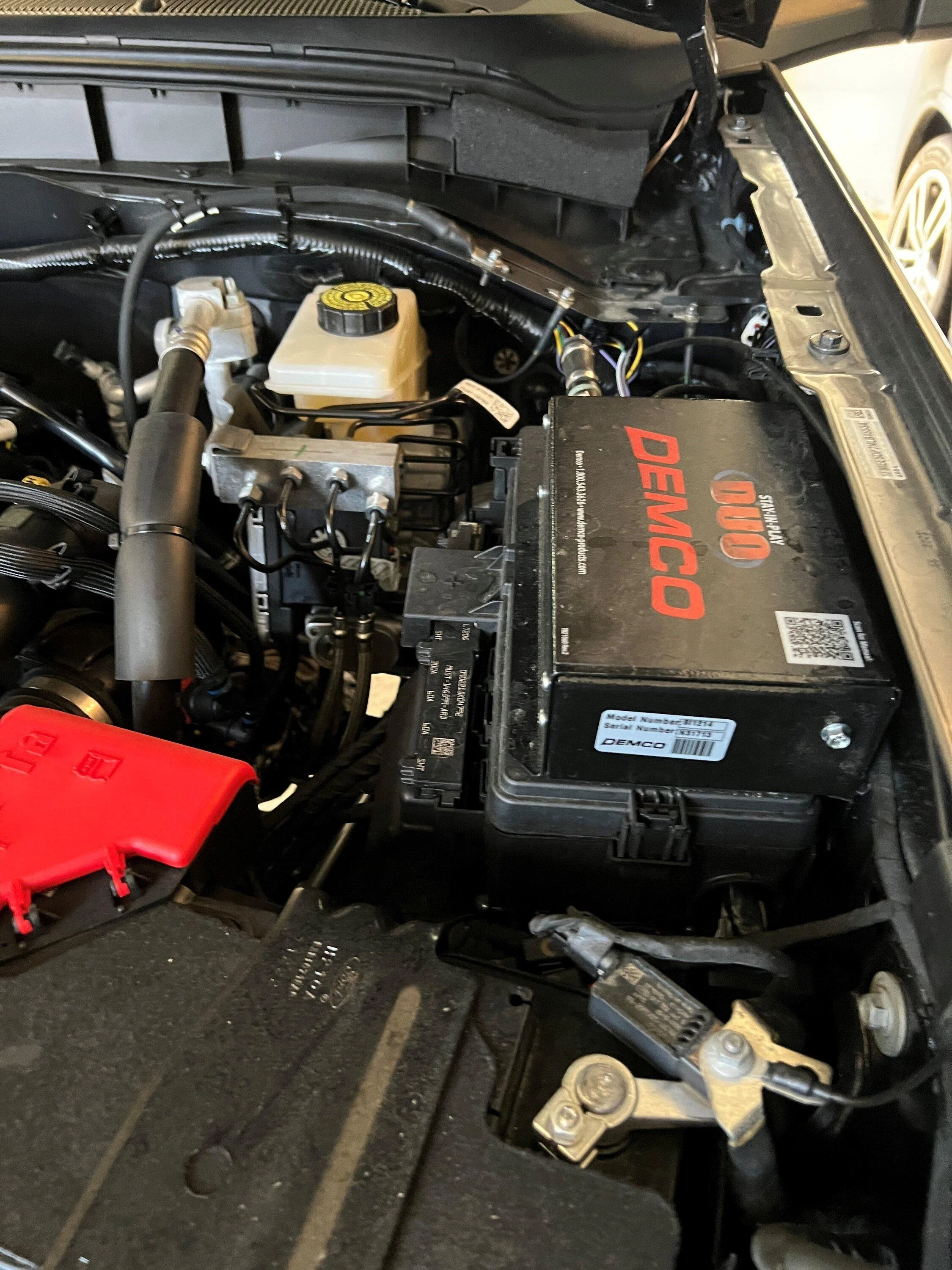

Tony, Got the stay and play duo setup you (and others) recommended, but before I go all "Edward Scissor hands" on the brake vacuum lines, I was hoping you could get me a picture of how you connected yours.
I saw they created a part/adapter that connects for some ford engines, did you use that or just splice directly into the Brake booster lines?
Thanks!
