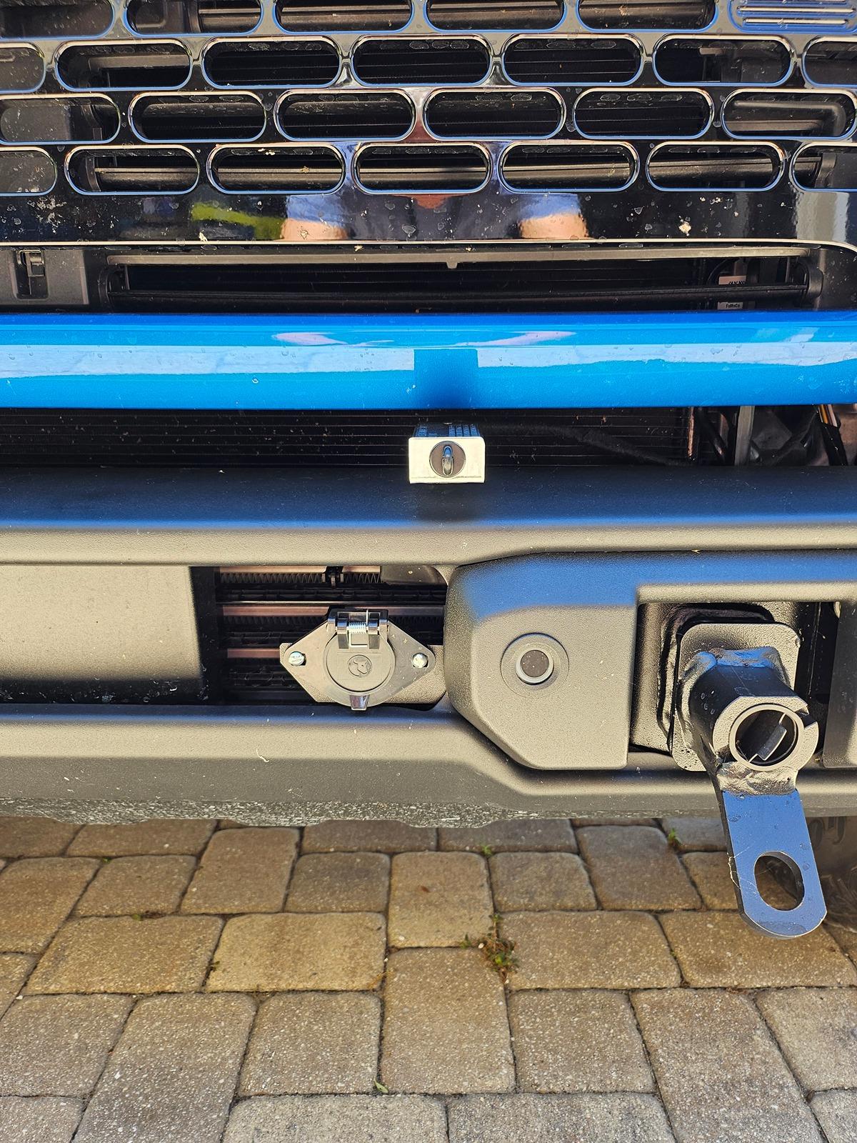

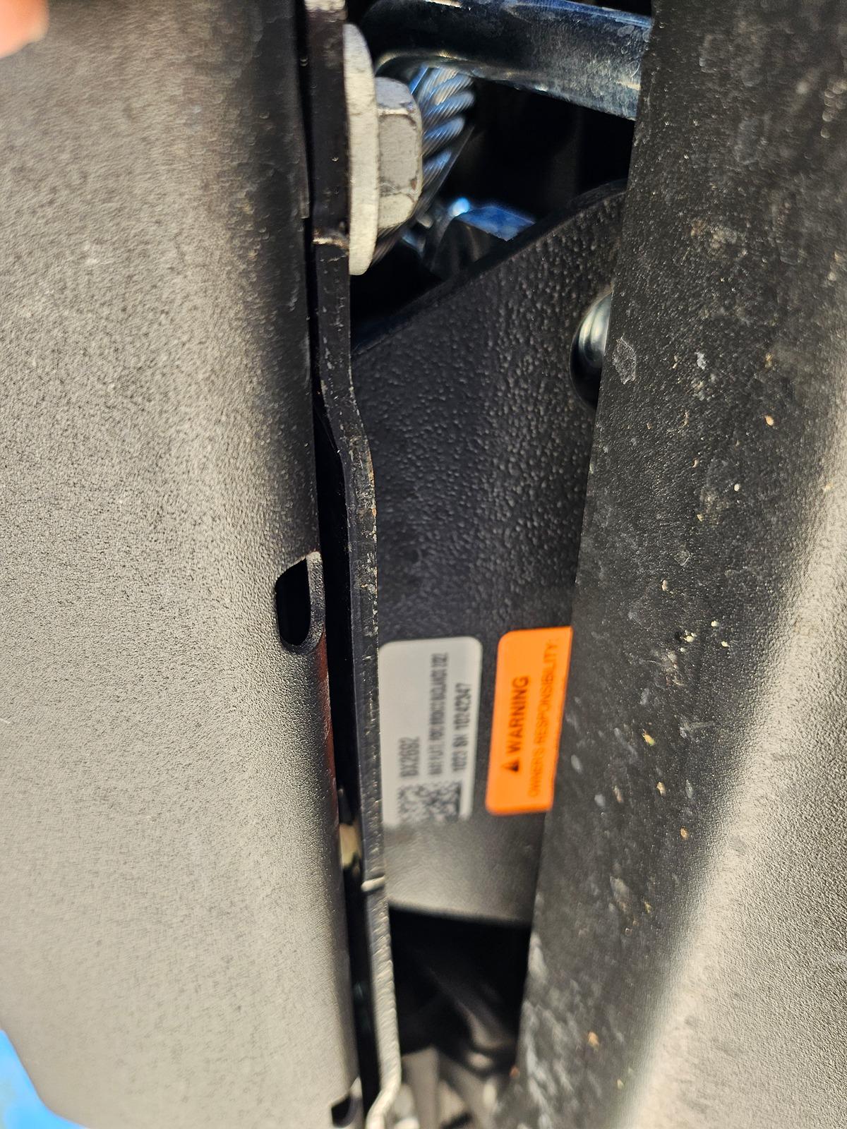

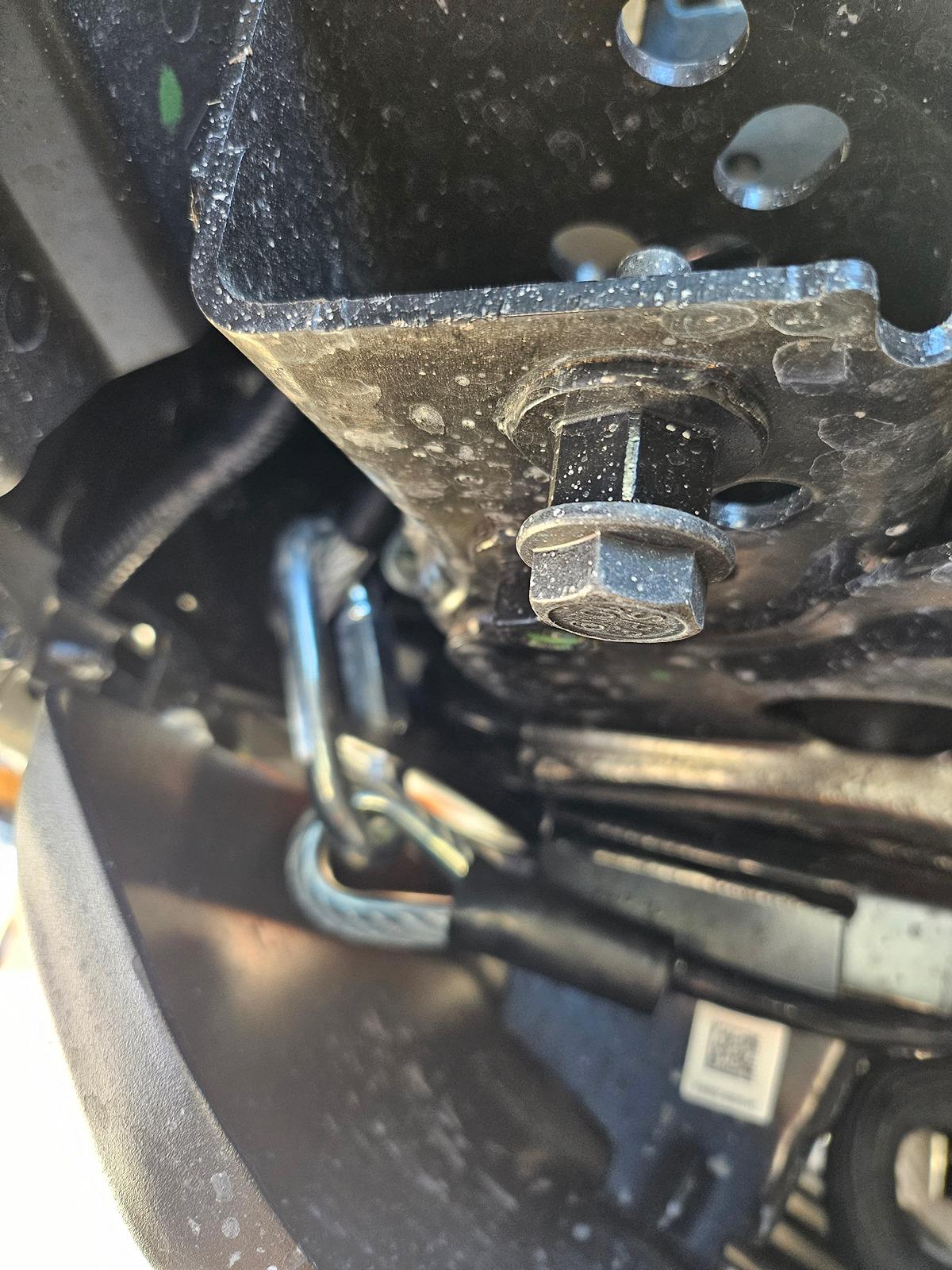

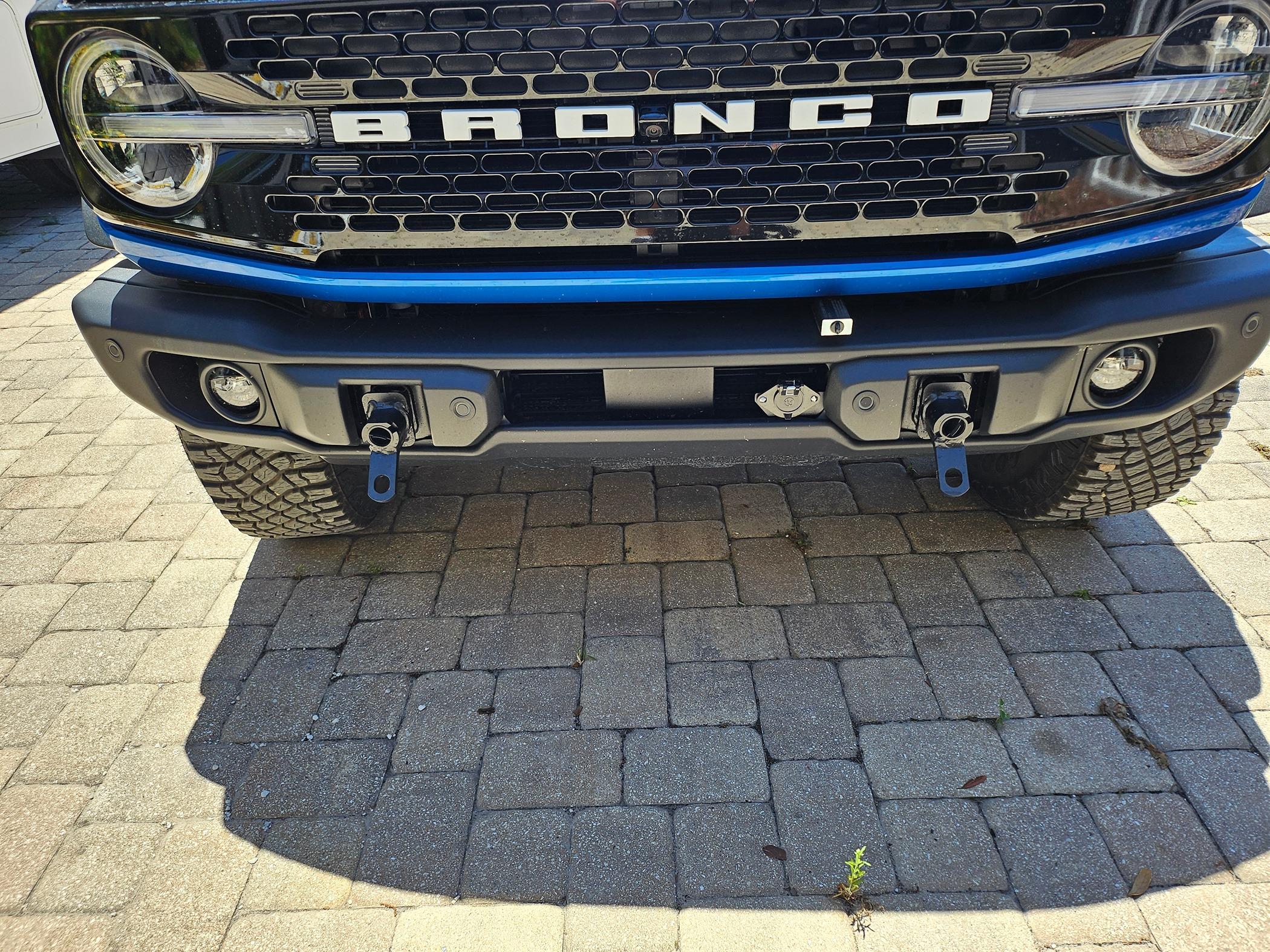

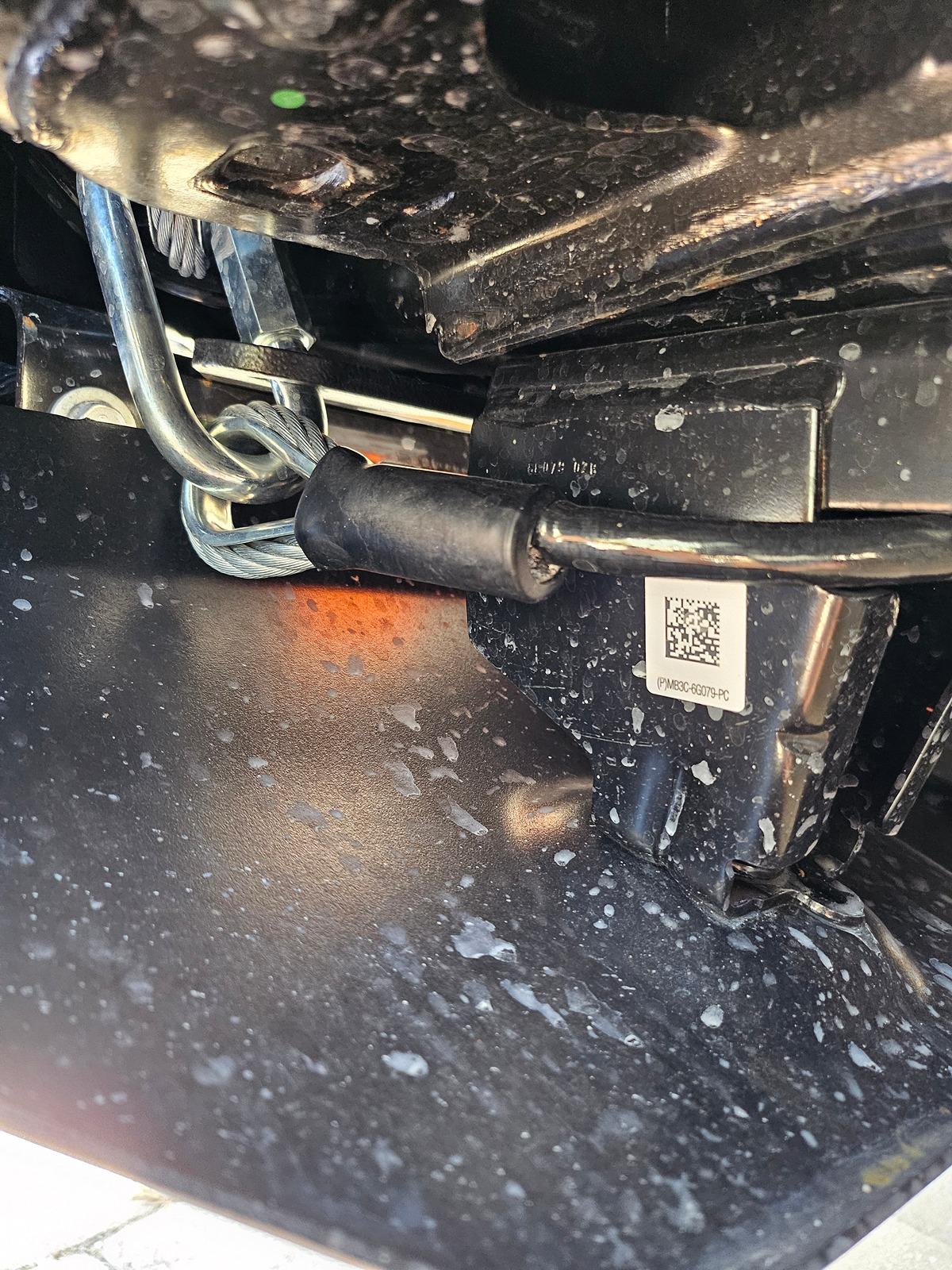

Trying to understand if this is an answer, as I have yet to see anyone answer the question or I'm confused. So looking for the following:
For 2023 Ford Bronco Wildtrak:
What do you need to flat tow when your Wildtrak has a capable bumper.
I personally purchased and have yet to install because there are so many no finished answers to the install process or what equipment to use that I'm thoroughly confused. Fear is to brick a vehicle behind my tow rig rendering my life ended! :)
Equipment sitting in the back of my Bronco:
Blue Ox BRK2505 Patriot Breakaway Swith
Blue Ox BX2692 Custom Tow Bar Base Plate Bracket
Blue Ox BX7420 Class IV 10k lb tow bar with safety cable
Blue Ox BRK2019 Patriot 3 Brake System
Blue OX BX88308 Accessory kit (which looks like a dupe of what I have below as far as wiring)
Blue Ox BX8848 4 diodes tail light wiring kit
Blue ox BX88206 coiled cable with female receptor
Question now is, I've read that this works for my Bronco, have zero install info or videos, and also have concerns about losing my front recovery points. (Going to assume those are gone if I flat tow). Any help would be appreciated. Do I leave it in the hands of a Blue Ox certified installer to do all this work? The ford dealer said, "Oh we do these things onf F150", well this is not an F150, so that scared me. Thoughts? I I should return all parts and start over, I'm okay with that too, just want answers.
BroncoFrogs
Mar 13, 2024
2023 Ford Bronco
Thanks for the post Tony. Am trying to answer the very same question now with my new 2023 Ford Bronco. Your installation looks nice. Am researching the Blue Ox products now. I trust you're still happy with your installation...
I finally broke and had JC's Customs in Winter Haven, FL do my install. They installed
BX7420 - Tow bars
BX2692-Baseplate for Standard Bumper with D rings
BX8848- Tail light wiring kit, diode
Demco stay and play Duo with Wireless coach link
BX88206- BLUE OX 7TO6 WAY HARNESS
Blue ox Wiring harness
Blue ox break away
Roadmaster charge line
I have yet to haul it behind the RV. Thats the set up though. My next question also would be can I use the tabs on the baseplate and put a 3/4 inch shackle through there for recovery purposes. Guy at the shop said yes, shouldn't be an issue as its attached to frame, however, there are welds. I would also think that Blue Ox could create something like the tow pins that go in there where you could install a shackle. Once we tow I will update, but thats my set up. I returned all the stuff I had purchased earlier. :)

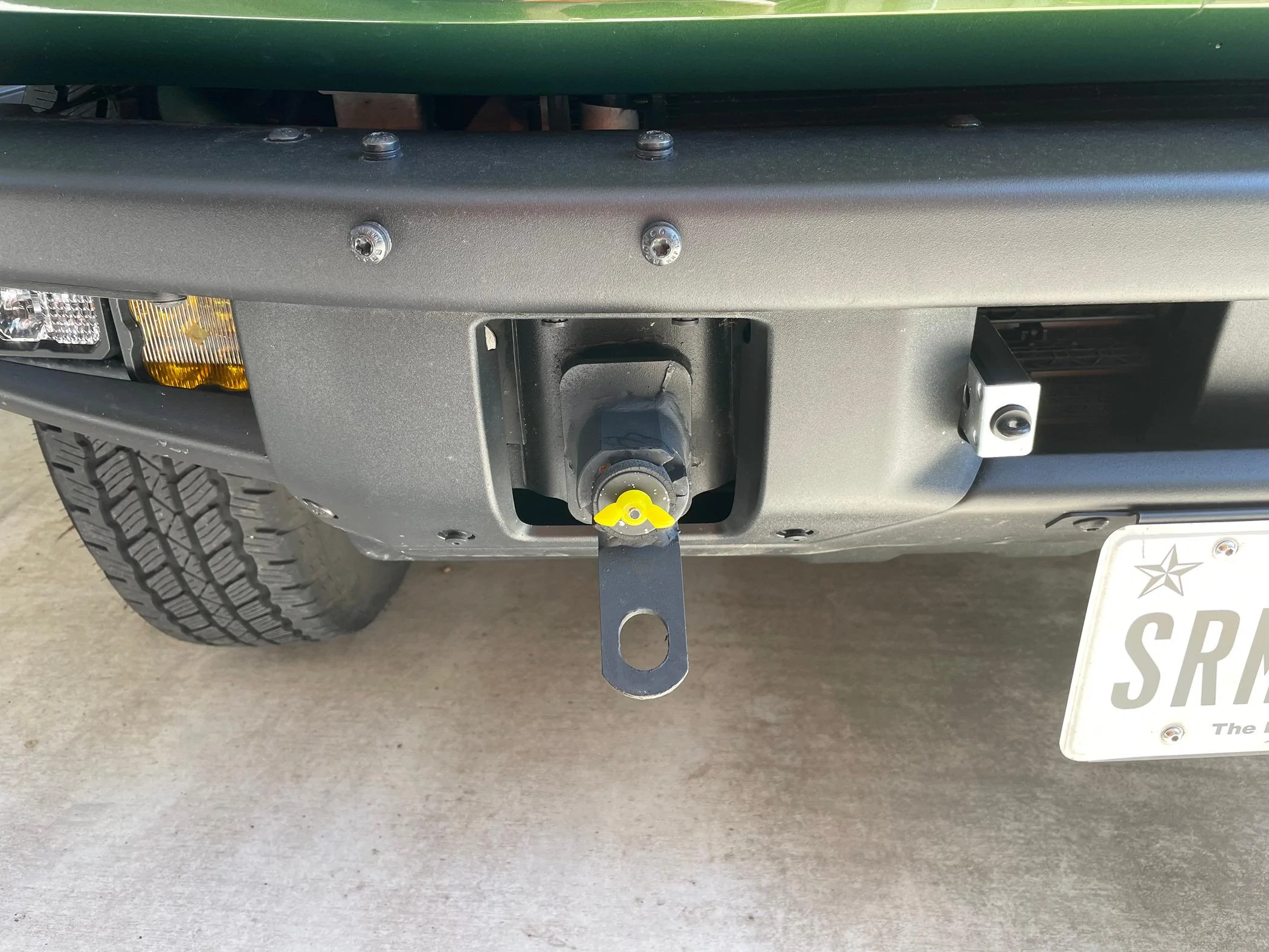

BX7420 - Tow bars
Blue ox break away
Install looks great. Had some similar thoughts about rescue maneuvers using the blue ox rig. Was thinking I might install the inserts that came with the base plate fixtures, and buy the mating parts from the towbar and attach to some form of soft shackle (believe I've seen these on sale on the internet).
One comment - you may want to buy a couple more of those plastic plugs... I had one fall out last winter. I came up with the expansion pipe plugs shown in the picture. Had to sand the rubber down to fit, and they're a little bit of a pain to install, but they stay put. Will revert to the plastic plugs when we're traveling as they're more convenient.
