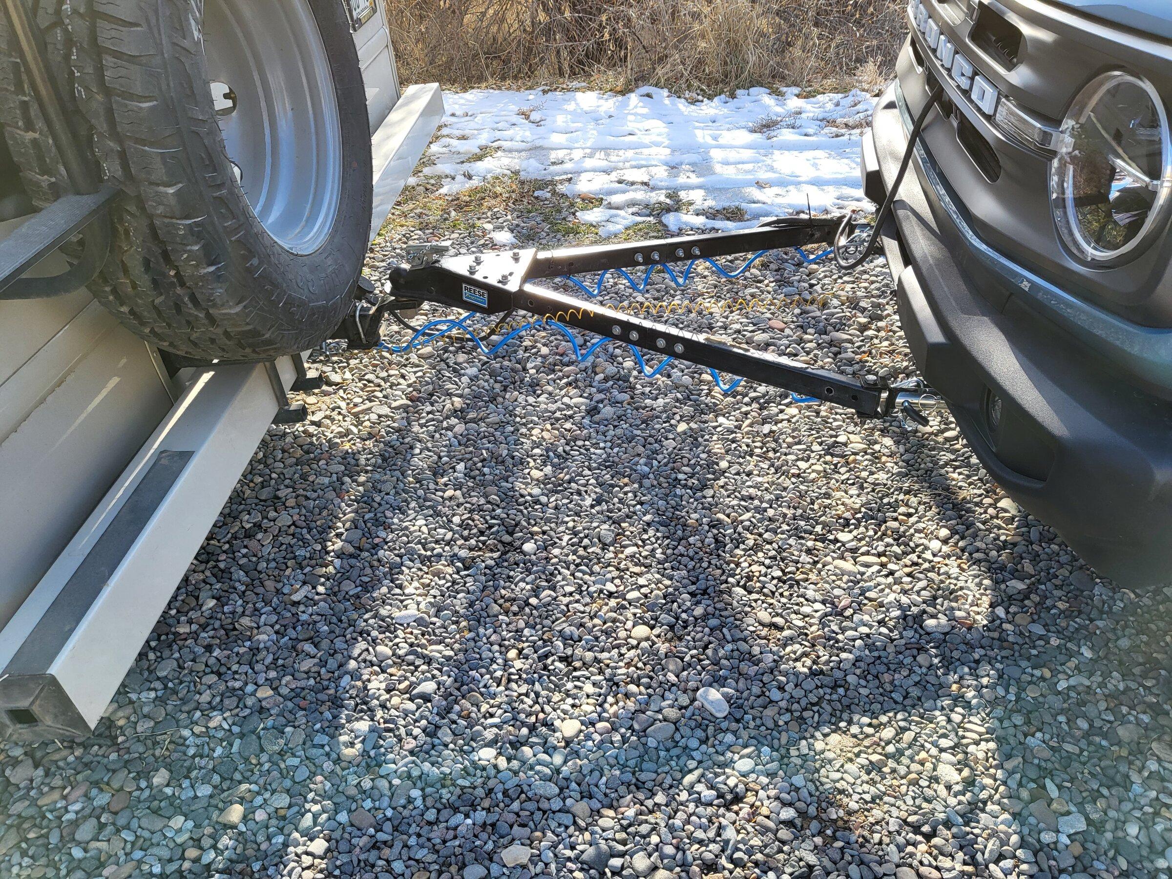

I have the 2.7 and blue OX Patriot 3. I did do the TSB with removing the 60 amp fuses and the Patriot three work flawlessly. The tow bar mounts go in place of the front recover d rings, no cutting of the Bronco is required.

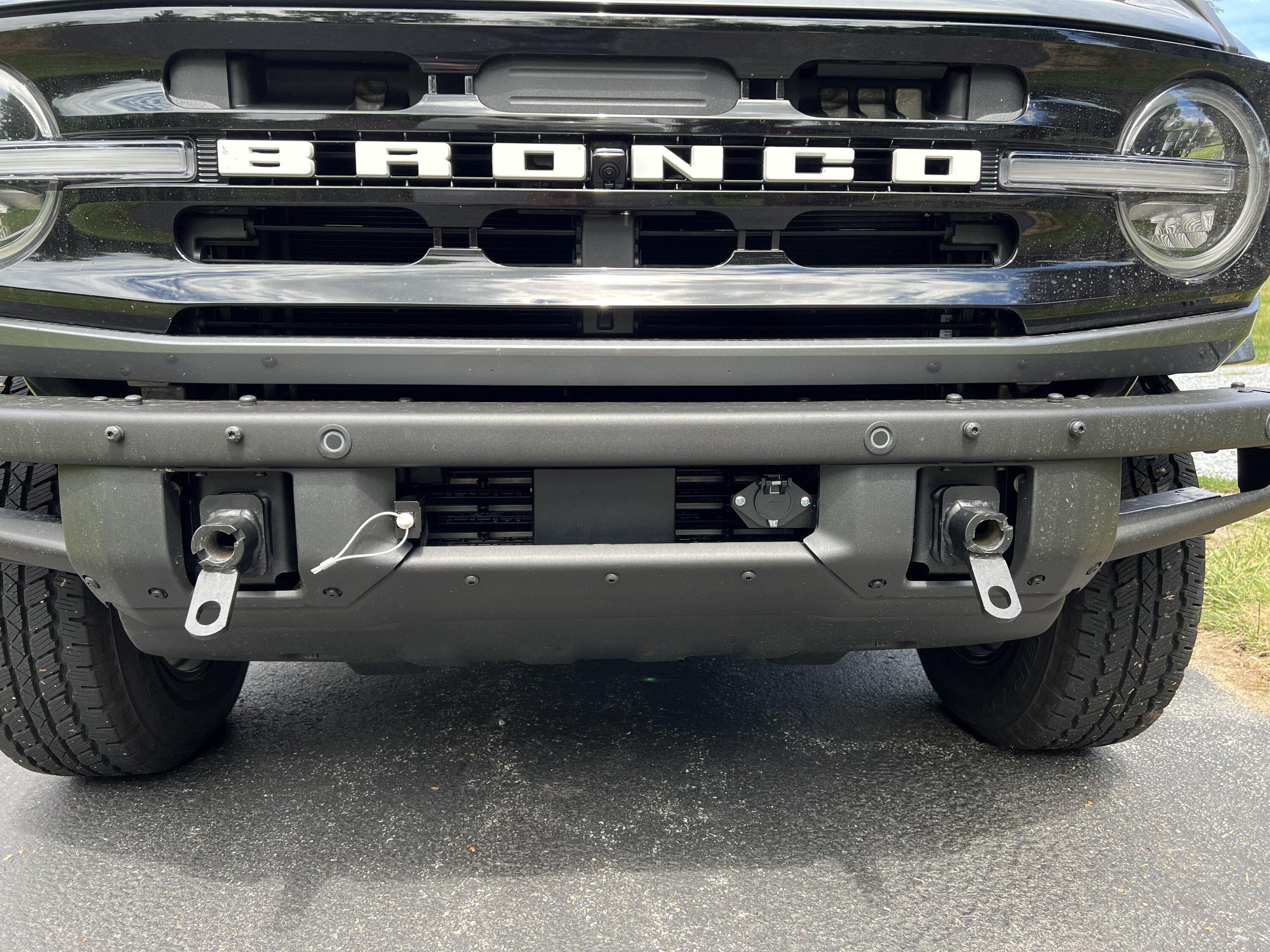

Late last week I finally got a supplemental brake system (Demco Stay-n-play) and Blue Ox tow bar combo installed @ Stoltzfus RV in West Chester, PA. They did an absolutely great job. They called Blue Ox and Ford - Ford said can't use the recovery hooks and Blue Ox redesigned their originals -- no cutting required. Flat towed the Bronco home (about 10 miles) - no issues.

Thanks for the post Tony. Am trying to answer the very same question now with my new 2023 Ford Bronco. Your installation looks nice. Am researching the Blue Ox products now. I trust you're still happy with your installation...

Bill - 2022 and 2023 will be the same if you have the HD capable bumper. Have over 1,000 miles flat towing and no issues at all. The best thing I did was get the stay-n-play supplemental brake system -- i literally just turn it on once I'm hooked up. Let me know if you need part numbers
