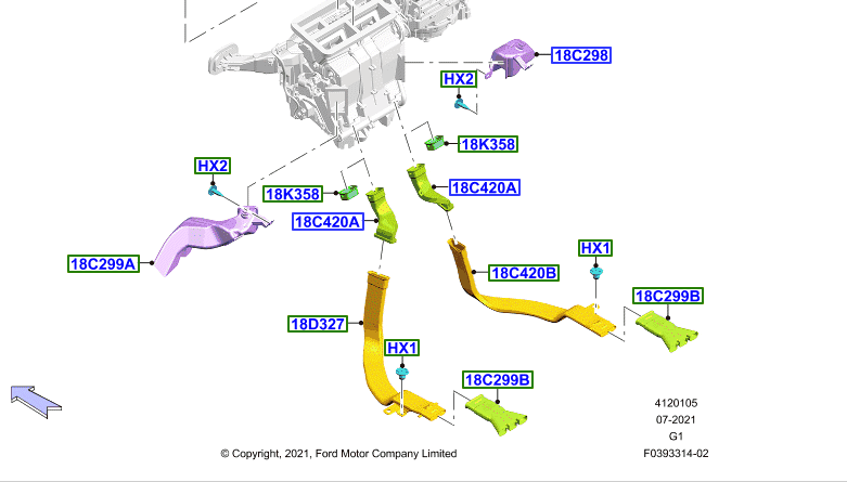

I am pushing the issue with my dealership. Got the "could not duplicate the customer issue at this time" the last time I took my car in, and I picked up after hours so could not complain about it.
I went back last week and demanded that a tech come out and show me how I am supposed to get hot air flowing out of the rear vents that are under the driver's and passenger seats. They could not tweak any setting to get airflow.
So now a tech (not a Bronco tech though) has confirmed that he cannot get air to come out of the rear vents, and is referring it to the "Bronco team" whatever that means.
I am still on 3.5.3 so will be interesting if they respond back that it will be fixed in 3.5.4 or if it is something else.
Love the Bronco, but this is really irritating, especially with the 20* weather we have been having the past week. Rear seat heat is really needed.

So the resolution was incorrectly connected ductwork under the seats.
I don't know if Ford had to remove the seats to get access, but bottom line, I have airflow from the rear/under seat vents. It isn't nearly at the level of the side window defrosters, but it is more than zero (which is what it was beforehand).
