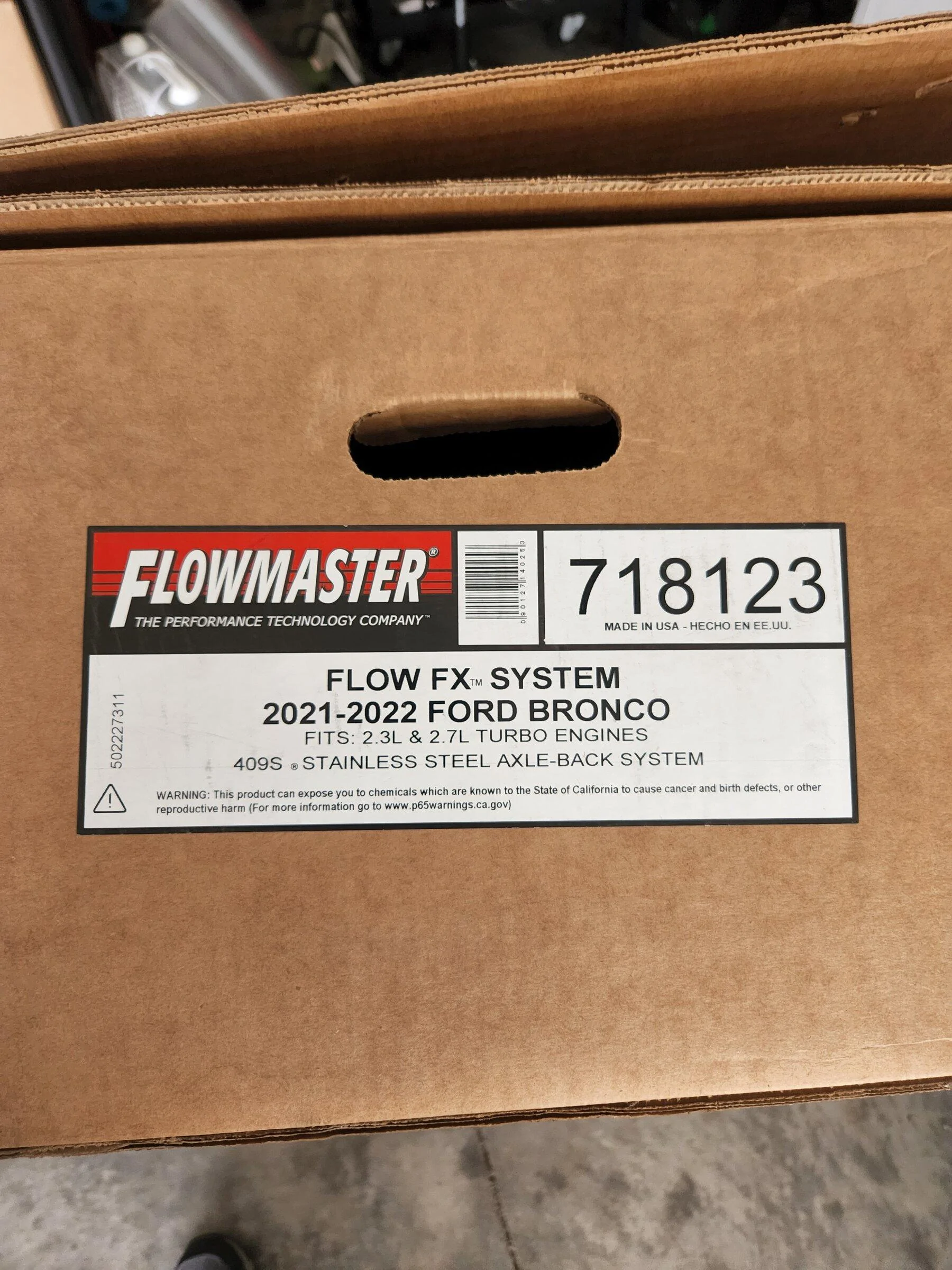

I installed this a couple nights ago on my wife's badlands. It's seems just right, not too loud or quiet, no bad drone that I can hear. Also it's louder that it sounds, the phone doesn't do the best job picking it up.

I thought it would be super easy but it was kind of a pain. 1st thing I did was slide under it on my creeper and run my head into the rear diff. Lol. It took me a little over an hour. The hardest part is trying to get the hanger bolts through the bumper without dropping them in the bumper. Why they didn't use the same hanger mounts for this muffler I'll never understand.

I see it because I know it's there but with the black tips I really don't know if other people would notice it or not with the black bumper. I think they would definitely notice it when they hear it. It took a little over an hour for me.
