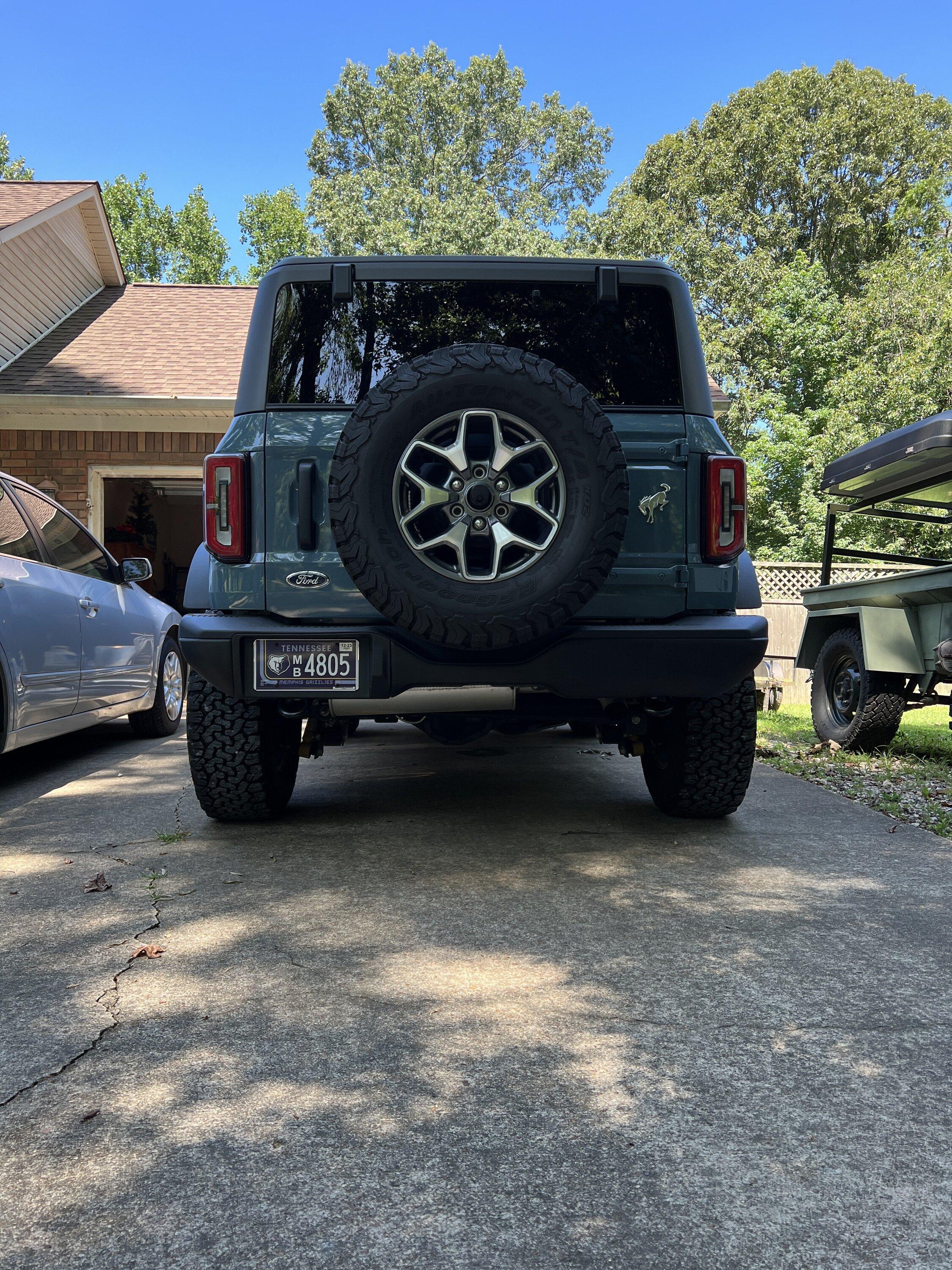

Hi all! wanted to include some pics and vids of a before and after install of the Borla Touring axle-back exhaust system. I have a 2.3L stick shift Badlands, 2022.
I really wanted to get rid of the giant silver can hanging below the truck, without getting an exhaust sound that was too much for a 2.3L lol. I think it's perfectly that. It sounds aggressive but it's not TOO much. I included a video, but I feel like it's not very accurate in portraying the after sound. It's a much deeper sound than what is captured.
I'm very happy with the note and the new clearance. Strongly recommend.

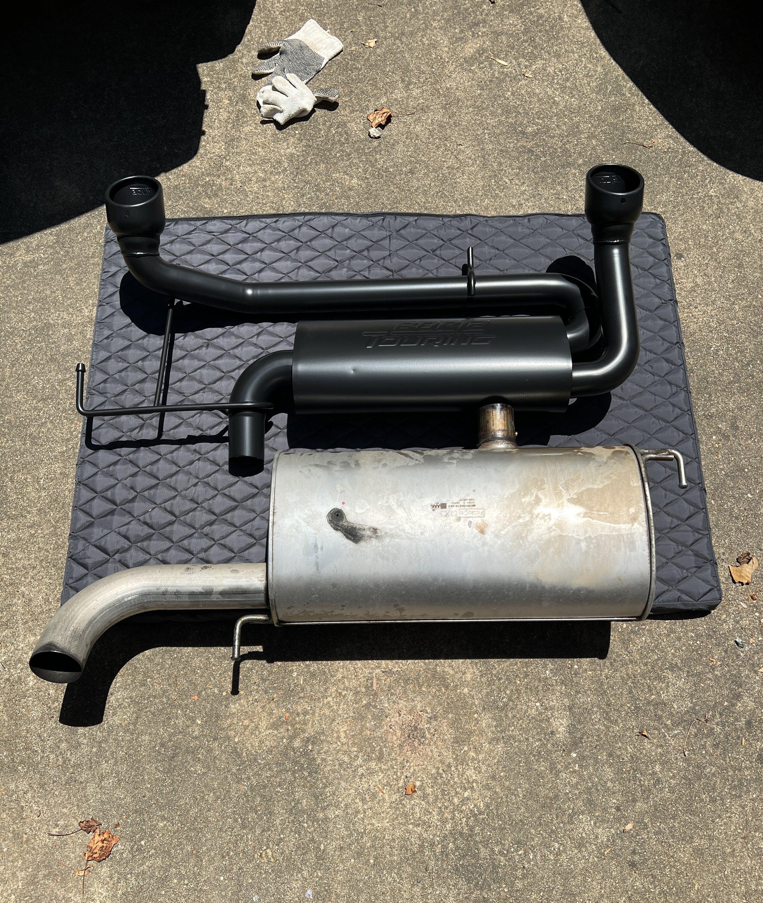

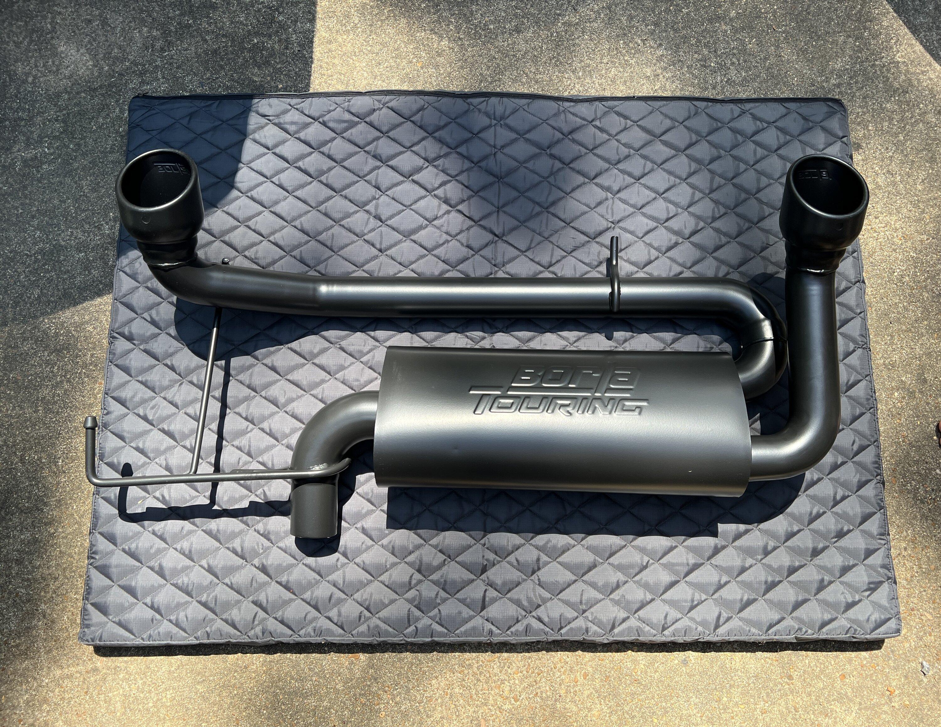

INSTALL:
did it with my pops, and it was tougher than i expected. I did buy an exhaust hanger tool from amazon which is a must. Penetrating lubricant for the bolts is also a must, even in the 2022. I got the black finish for the exhaust and managed to scratch it to shit, but it's mostly hidden anyways. Some issues with getting the two pipes parallel, and I wasn't able to solve this. I'd say they are off by about a quarter inch.
BEFORE:
Ford Bronco Borla Touring Axle-Back Exhaust Install on a 2.3L Manual IMG_0052
DURING:
Ford Bronco Borla Touring Axle-Back Exhaust Install on a 2.3L Manual IMG_0053

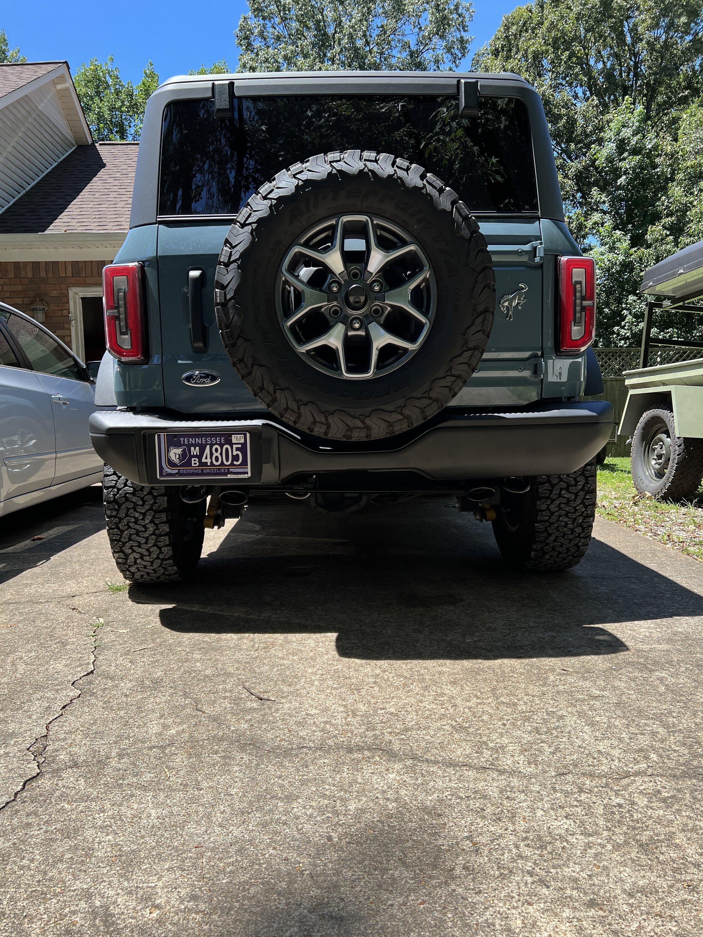

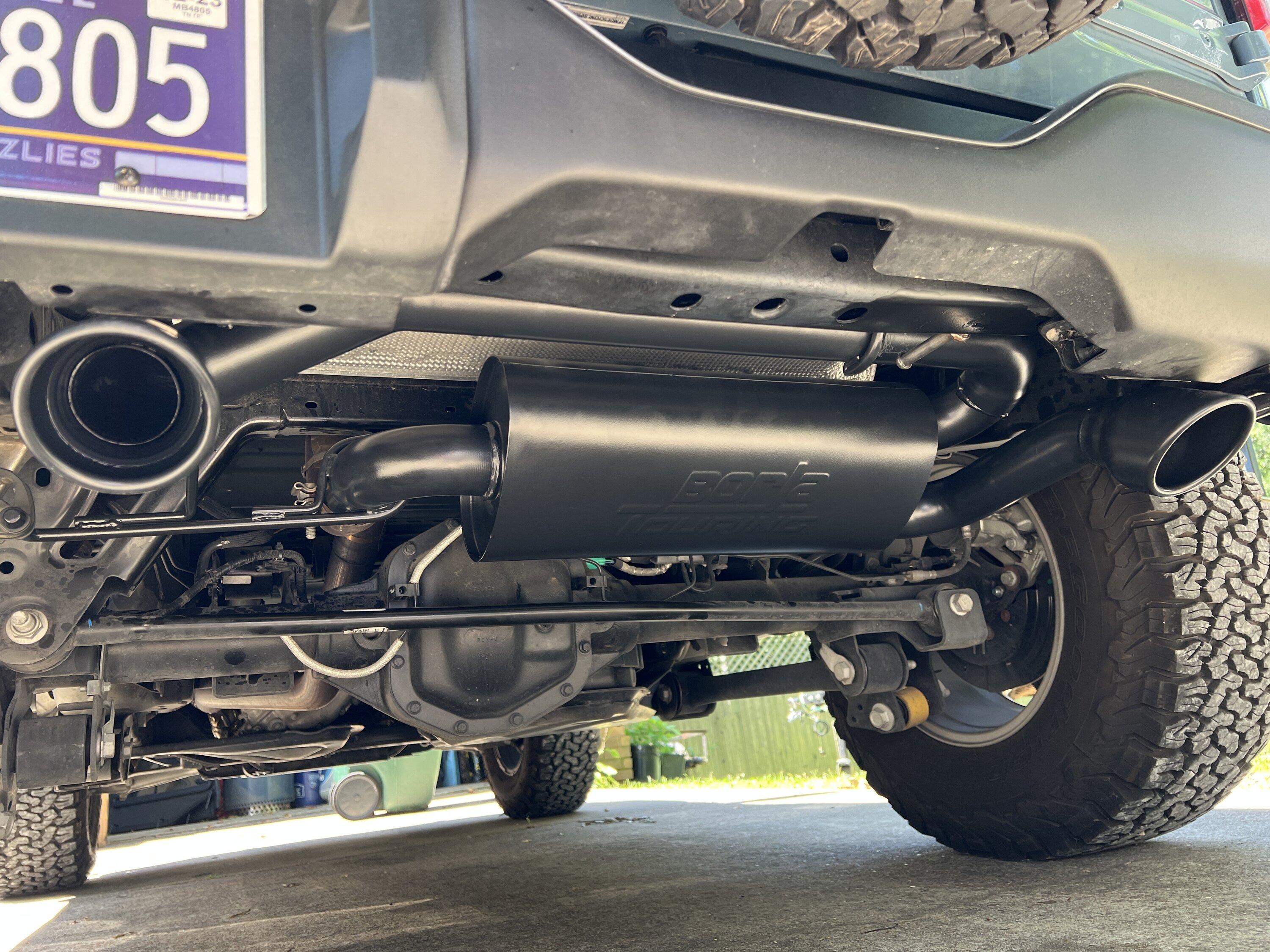

AFTER:
Ford Bronco Borla Touring Axle-Back Exhaust Install on a 2.3L Manual IMG_0055
Ford Bronco Borla Touring Axle-Back Exhaust Install on a 2.3L Manual IMG_0057 (1)

Nice. I have the Borla S-Type axle-back for my 2.7L and love it. I also struggled a bit getting it installed. The rubber hangers were a bitch to get on/off. I didn't have the right tool, but plenty of lube helped.
Also, getting the pipes parallel was a challenge too, but I ultimately got it. Try twisting/turning the entire assembly where it connects at the factory exhaust outlet. You'll have to re-loosen the connecting nut, but worth a try. My two rubber hangers are crooked from underneath intentionally, but it was necessary to get the pipes parallel.
