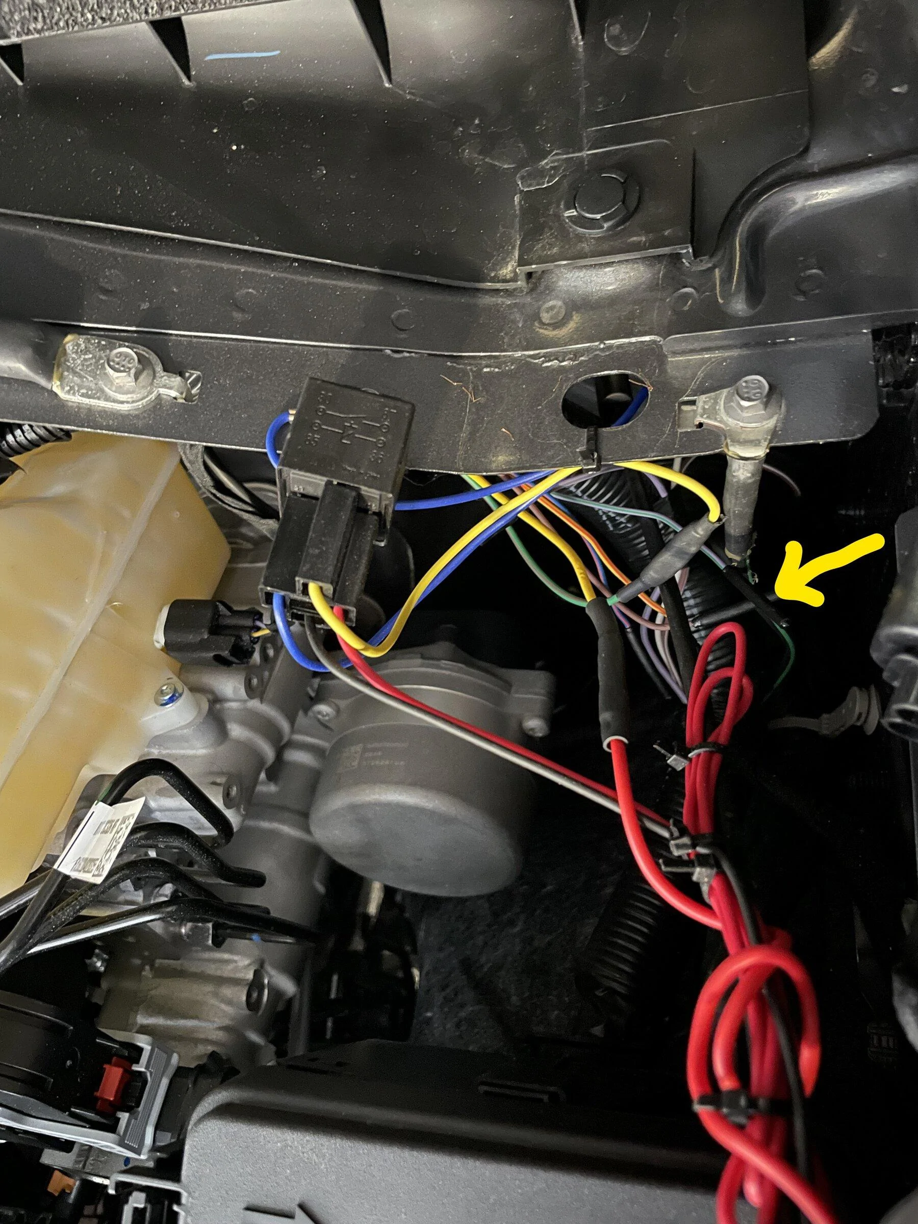

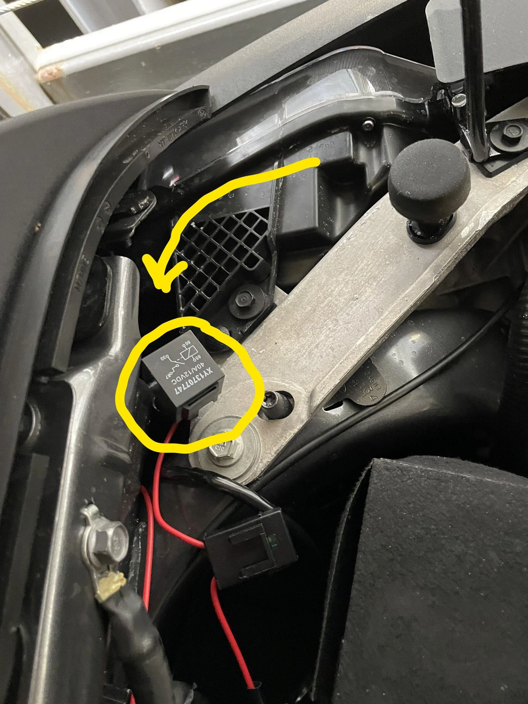

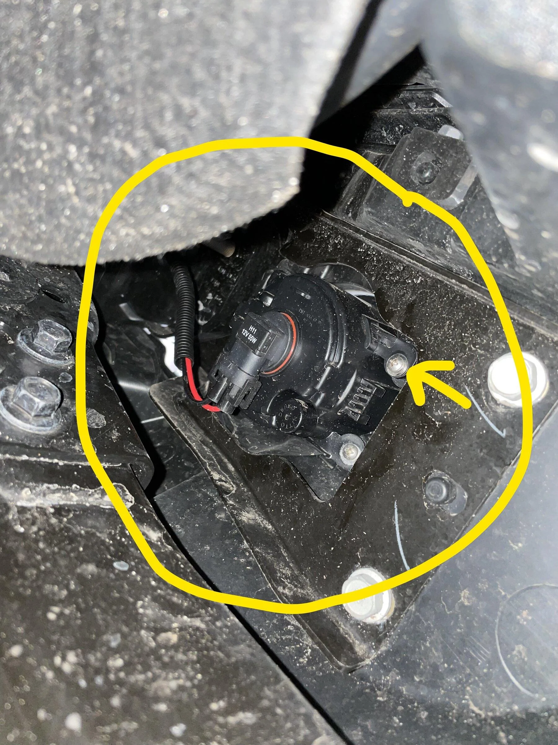

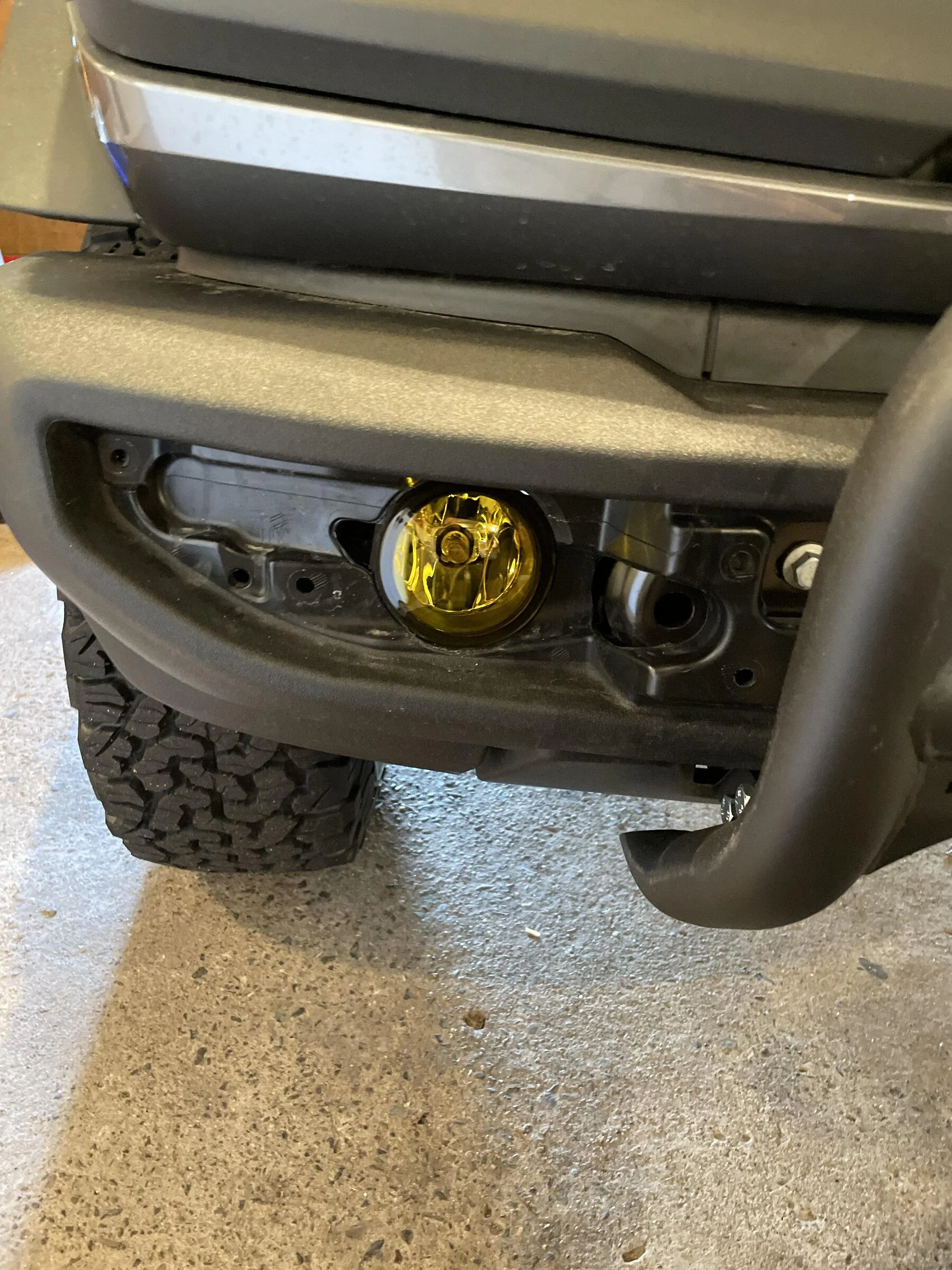

Sorry for delay, here are some photos on fogs...
1st - this is actually the relay for the driving lights, but also where the Fog Positive Trigger gets power from AUX Switches

2 - Fog Relay by Front Drivers headlight with where wiring harness goes down behind fender

3 - There is a rubber strip between grill and bumper - that is how I got harness from driver side to passenger, easy as hell, just pull out, run wire and push back...

4 back of passenger fog - stainless steel #8 screws into back of bumper
