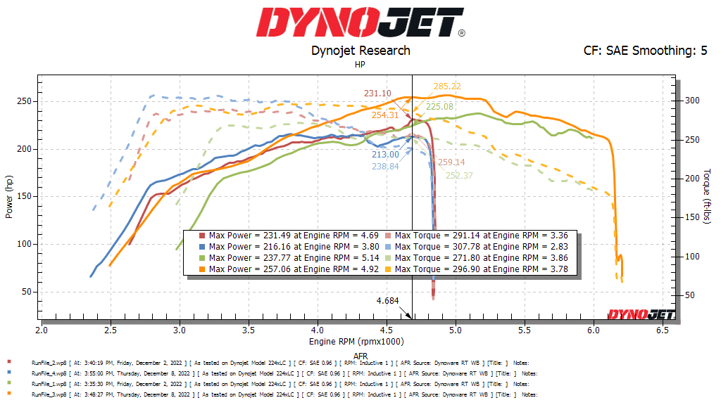

Alrighty, it’s been a loooong day. Good news is that I got the tune installed! The limiter was not cooperating so the graph may be a little weird. Basically my tuner had to work around the limiter to get the numbers. We found that the max HP was obtained using 6th gear and max Torque using 7th gear. Max numbers were 257 WHP and 307 ft lbs of torque at the wheel. This is compared to 237/291 stock. It should be noted I have muffler delete and run 91 Oct. Factoring in the generic 15% power drivetrain power loss, the numbers fall far below what Ford claims at 330 hp/385 tq at the crank. This could be in part due to the 35’s though and lack of 93 Oct… who knows?
i will say however, the whole power band changed and much more power comes on way sooner which is honestly a game changer. The transmission also shifts way snappier and feels like a DCT now. So while the numbers are slacking on the top end. The fact I have access to way more power lower in the range is exactly what I need off-road.

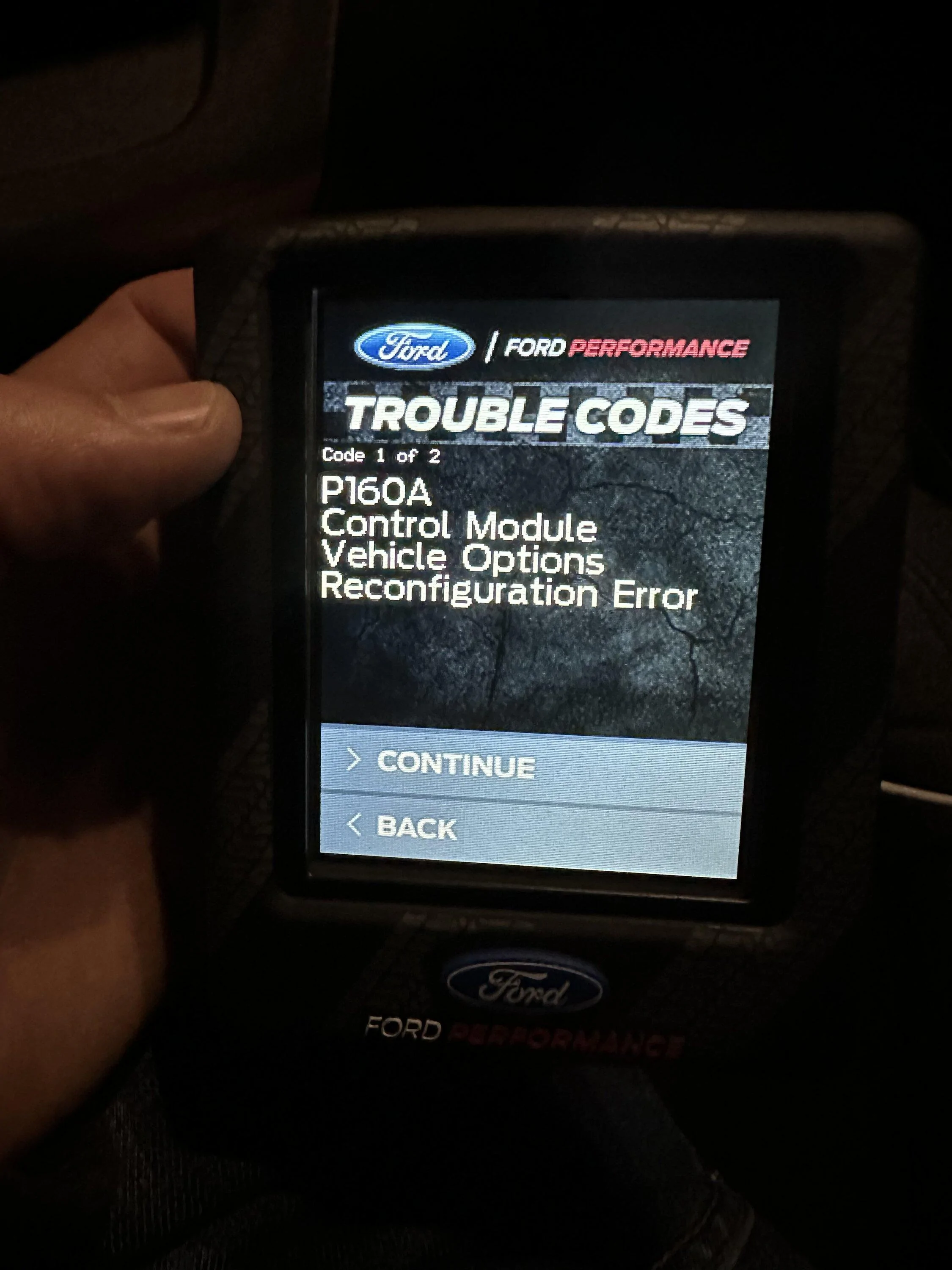

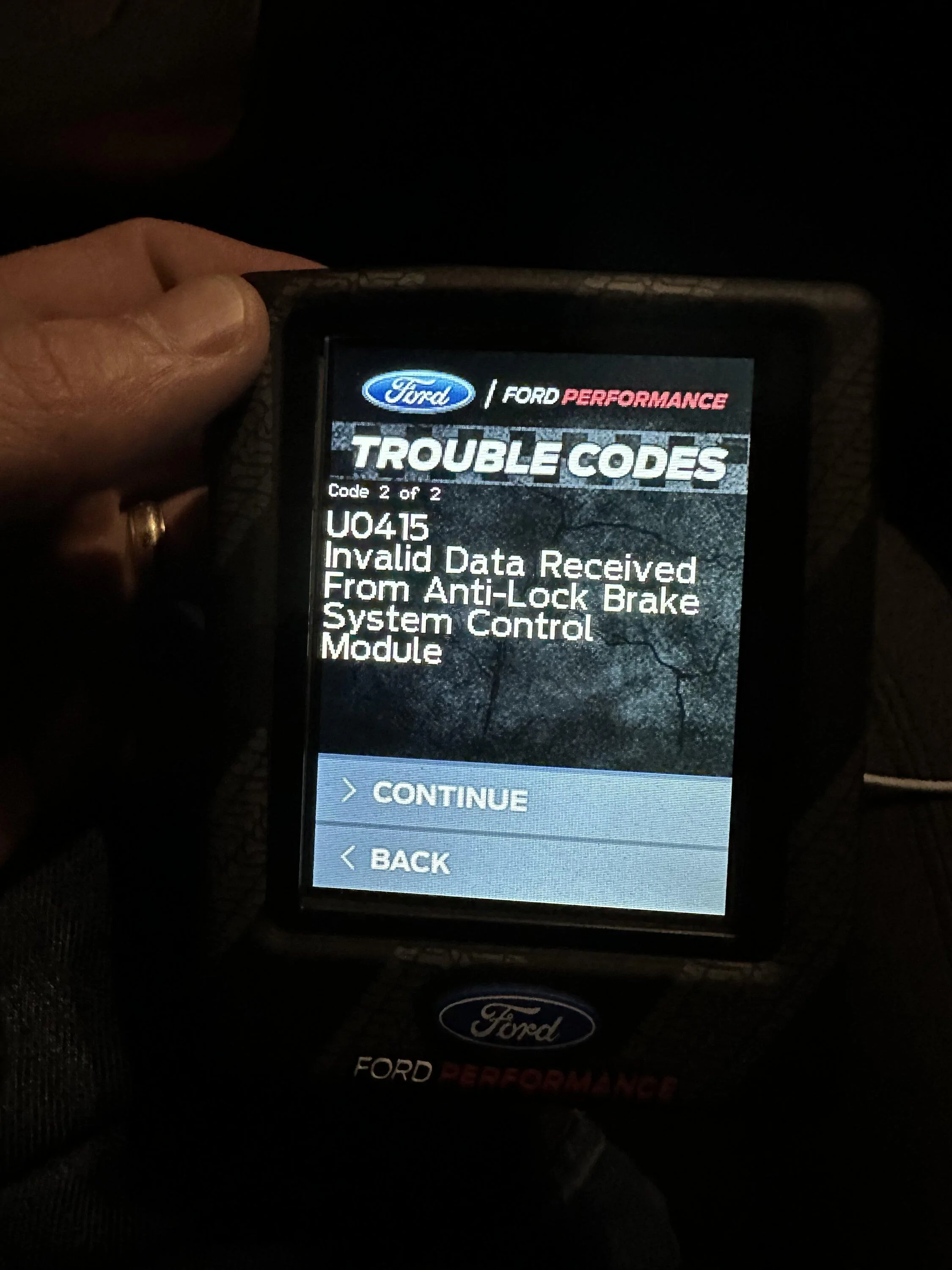

Now for the bad… 8 miles after getting the tune installed I got a service 4x4 light and the following codes pictured… to be fair I’m not sure if it’s the tune causing the issue as I recently went mudding and had spent that entire morning today pressure washing under my Bronco… I’m hoping it’s simple like a wheel speed sensor. In order to rule out the tune I attempted to reload the stock tune but it’s giving me an ECU read error. Not sure if this is because my PCM is throwing a code right now or if there is an issue with my stock tune file… either way I’m bummed. I reloaded the performance tune and still an issue. I reset the battery, I checked cable connections, still bad… I bummed lol. To Ford it is.

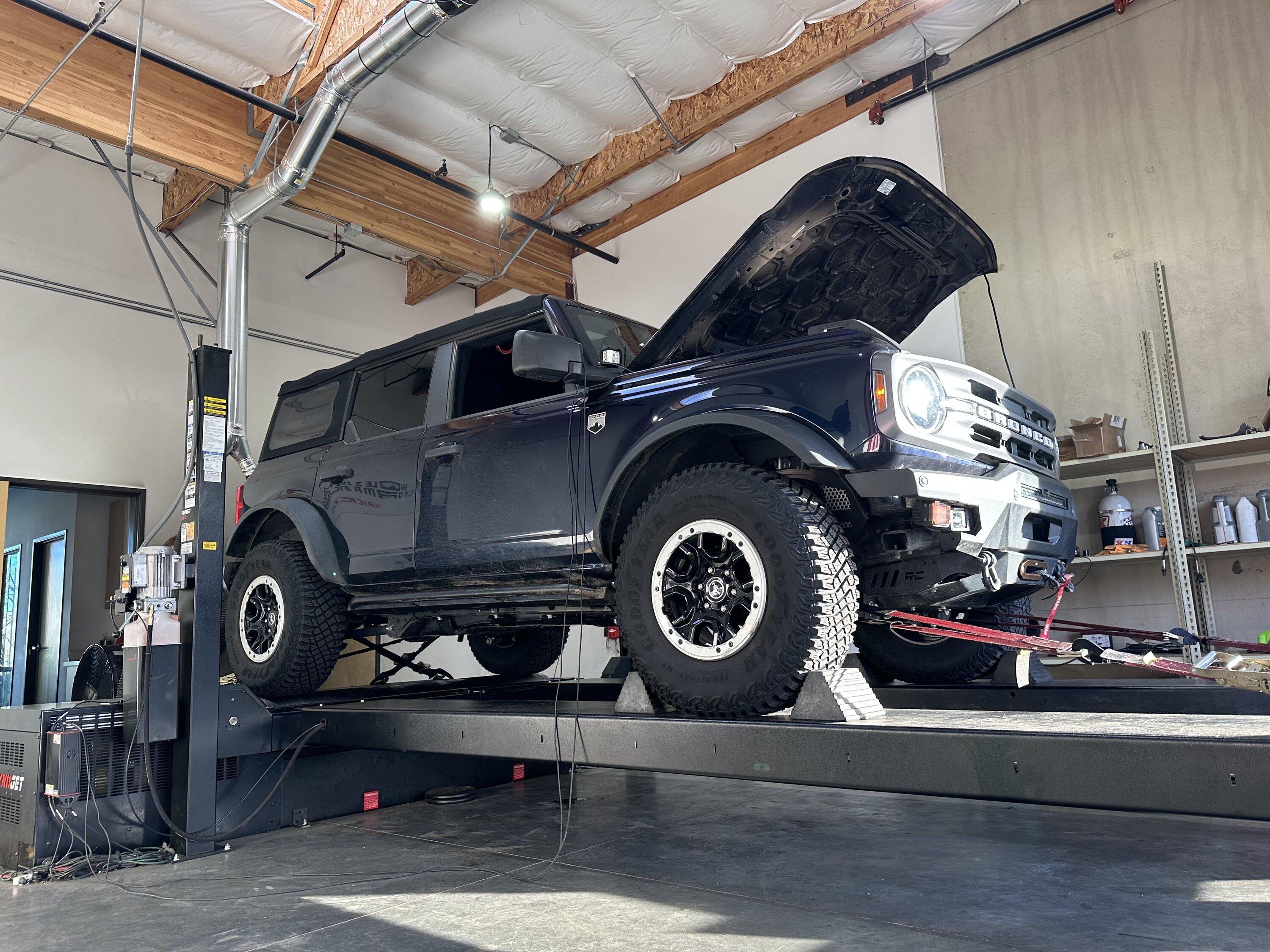

Holeshot Tuning in Rancho Cordova is helping me with dyno runs before and after as well to see the true power gains. Things to note: I run 35's currently on Sasquatch 4 Dr 2.3 automatic. I have a muffler delete as well.
We wrapped up 3 pulls on the dyno in stock power. Bronco pulled 237 hp at the wheels at 5,000 RPM's and 291 ft lbs tq at 3360 RPM's. This was run with 91 Octane which I have used the entire time I have had my Bronco.

In no way am I hating but I wanted to pass on some info. People say the 2.3 is held back by the intake. In this Video the guy made over 20hp off the intake. Look at about 11:30 on the Video you can see his chart and compare it to yours. Now to be clear I'm the guy that says just adding a better filter in your stock will do the same thing but a few are saying I'm wrong on the 2.3 just something to think about a simple filter or cold air intake maybe worth some nice HP gains on your setup with the tune. I say just a better filter but some say you need the full intake. I pointed out on the F150 just a filter is needed no gains off full intake but the claim in just a filter can't give you 20+hp and they could be right on this one I would say regardless a better filter or cold air intake would really help you dyno #s. Nice job and great info thanks
I love it! I’ll look into that for sure. I was more interested in the remapping vs the power gains but I’m always down for cool mods! Thanks for sharing that!

OMG I FIXED IT!!! So apparently the tune was set up with the wrong tire size setting. I went into ProCal and selected “change tire size, ratio). I followed the prompts and BOOM. Check engine light is gone! All is well and the tune is awesome

If its possible run a test on just a filter. You could save others a ton of money if you do a test on just filter vs cold air and see no gain. Besides it will look cooler
