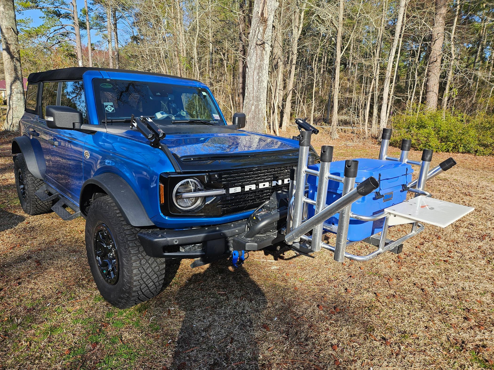

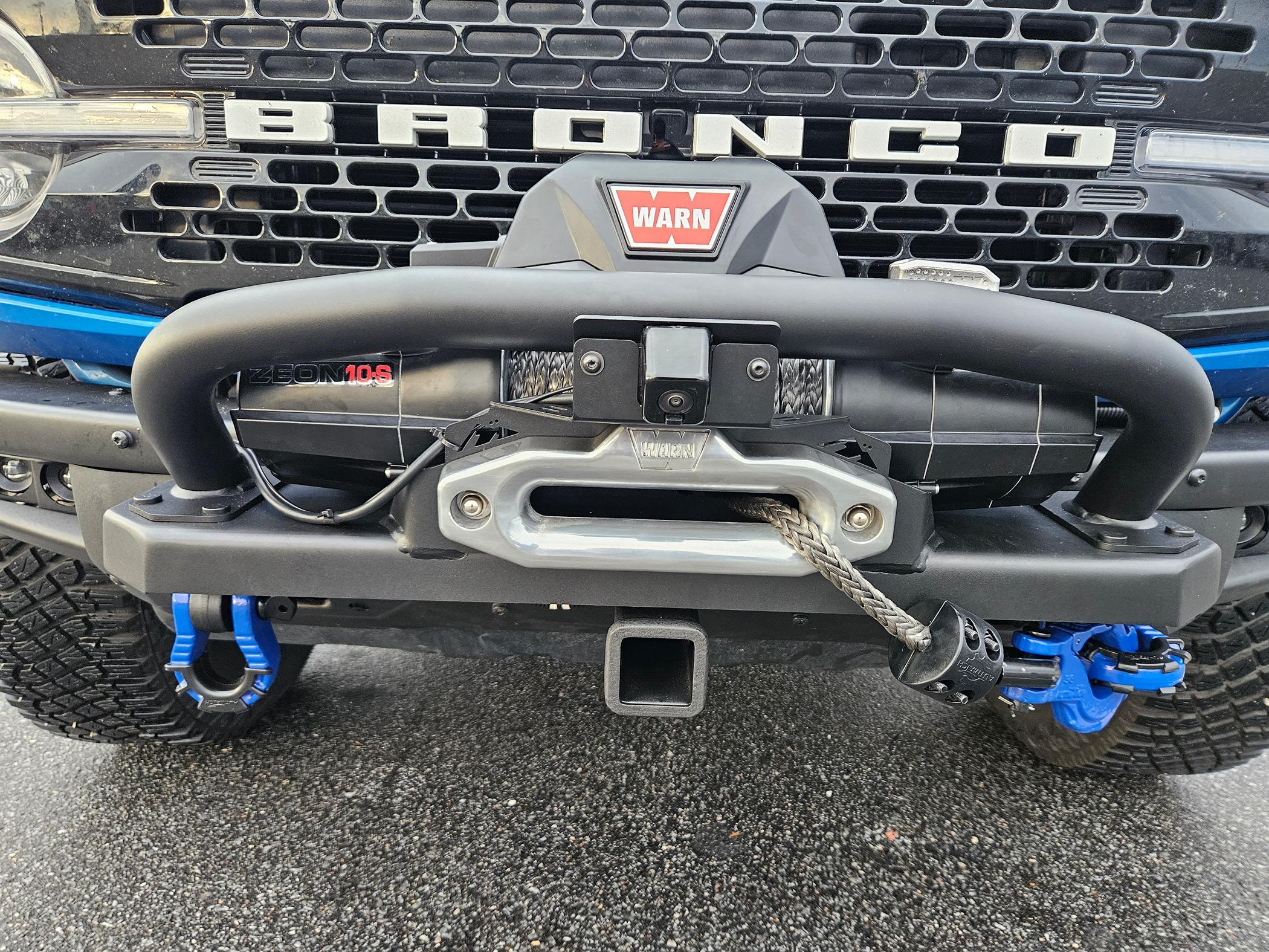

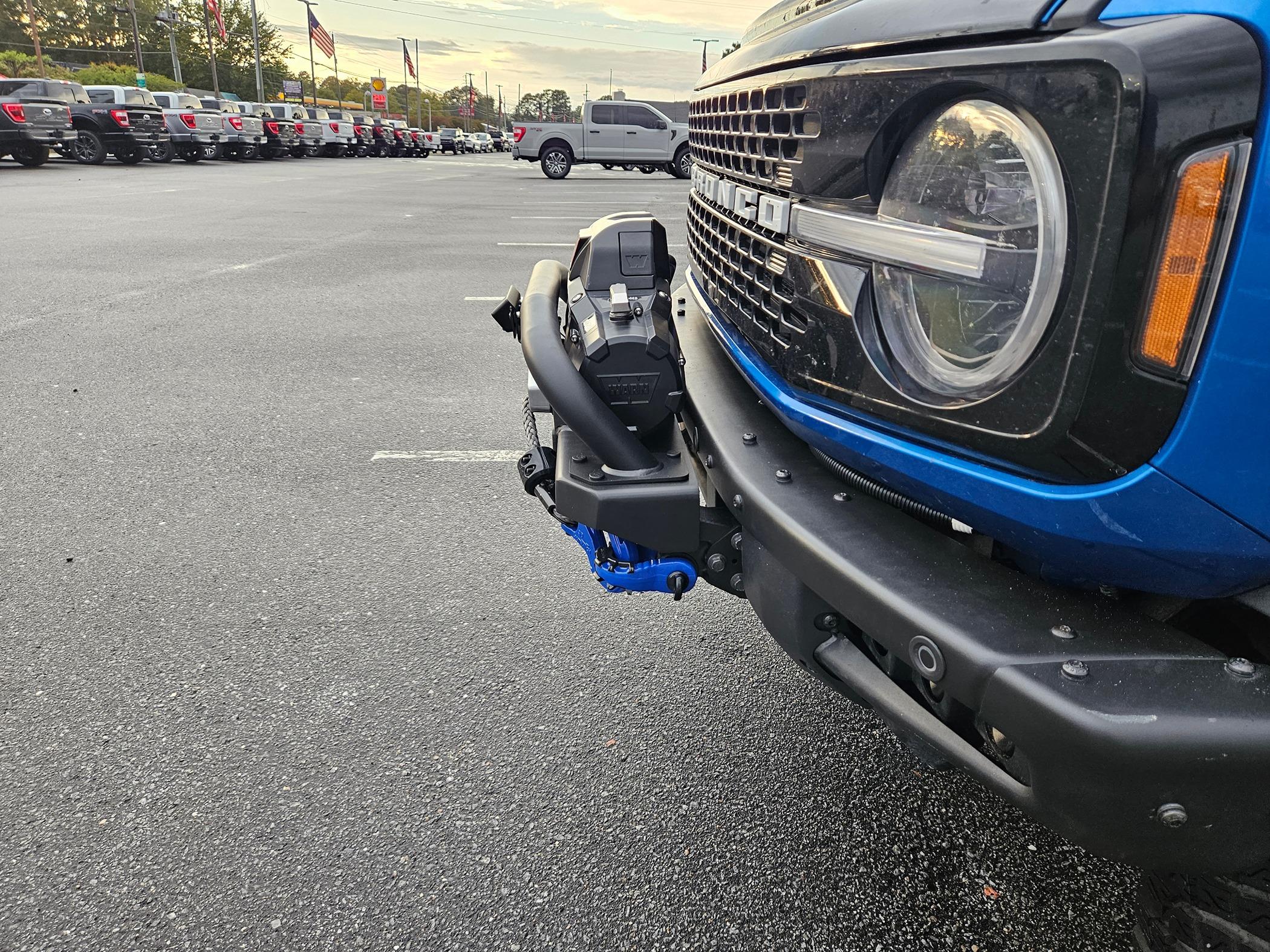

The factory installed modular bumper threw me off for awhile but my guys at my dealership installed a take-off modular and a Ford preformance winch pk on mine with no problems.
Ford Bronco Ford Performance winch mount 1000002983
Ford Bronco Ford Performance winch mount 1000002982
Ford Bronco Ford Performance winch mount 1000003083

1) Prefer my air bag system to deploy correctly.
2) most all mounts would require a front camera relocate.
3) don't have adaptive cruise
4) everything thing I mount on mine front and rear blocks sensors.
5) already had LED lighting
6) Found a steal on the Ford preformance winch package new in the box on market place. 7) X-Rack front reciever hitch mounted to the ford setup.
Ford Bronco Ford Performance winch mount 20240225_090355
Ford Bronco Ford Performance winch mount 20230618_092940
