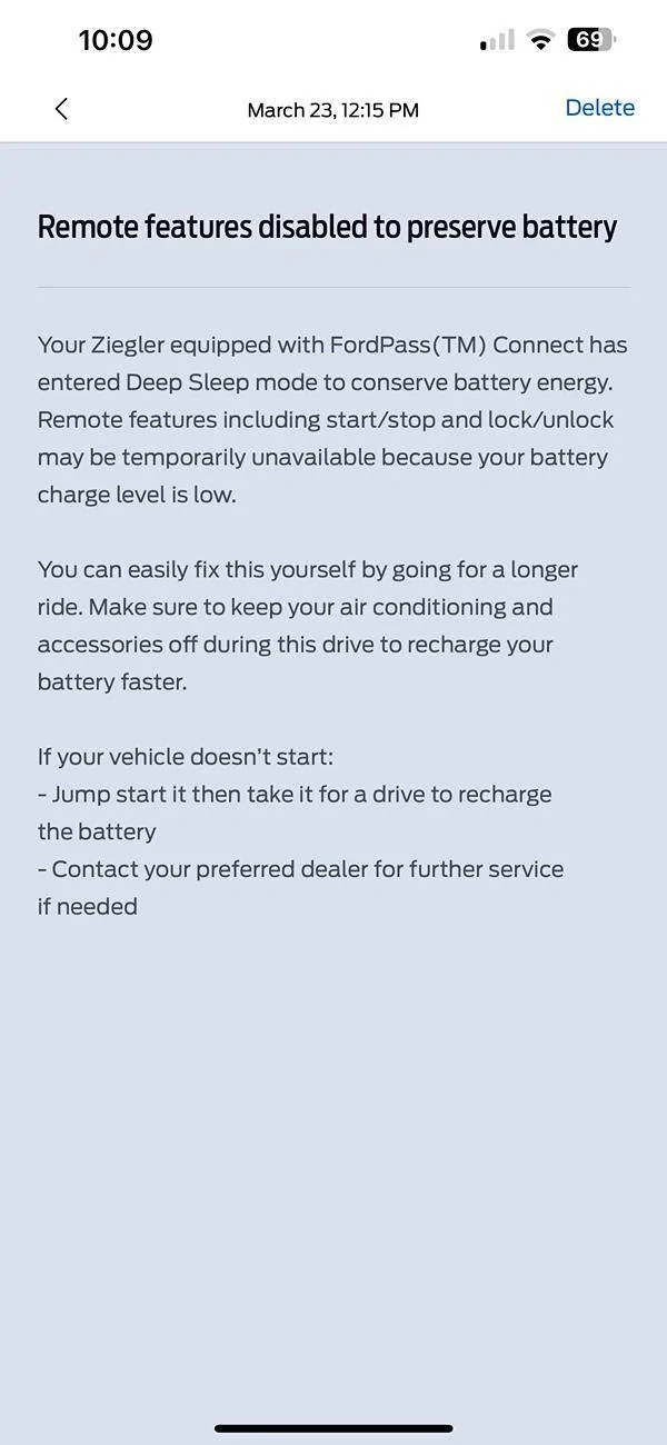

I have now received 2 text messages informing me that remote features of the FordPass app have been disabled to preserve the battery. My Bronco is not quite 3 1/2 yrs old with 29,000 miles, but not withstanding this message, I know the time for battery replacement is getting near. The voltage readings have not changed (14.7 upon startup and lowering to 12.7 after a few minutes of driving (all normal to my knowledge). Attached is the message received and inquiring if anyone has comments to make.

This message occurs when the vehicle detects the voltage from the battery has dropped below a specified threshold (I do not know what that is). It can happen from sitting too long, something drawing on the battery, or the battery itself getting weak.
Given that you're on the original battery after 3.5 years, and with how much power newer vehicles require, I'd say you need to replace your battery. The days of getting 5+ years out of a battery are just about gone.
