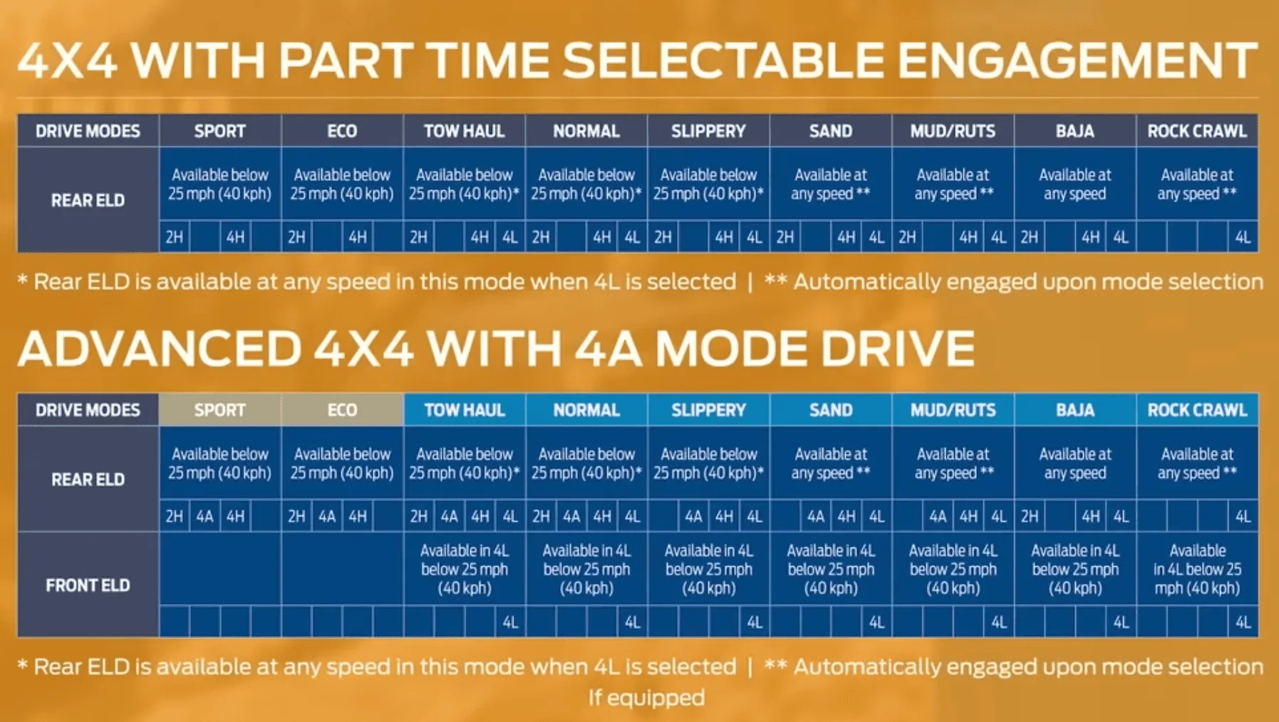

I am guessing you weren’t in 4L. To test it out, skip the goat modes. Find a loose surface and select 4L. Shift into neutral, and make sure that it engaged. Then, try your lockers. If I recall, the front locker only works under 25 mph.
If you do use goat modes, this chart may help. You’ll still need to shift into Neutral though to get into 4L, which is how you use the front locker.
