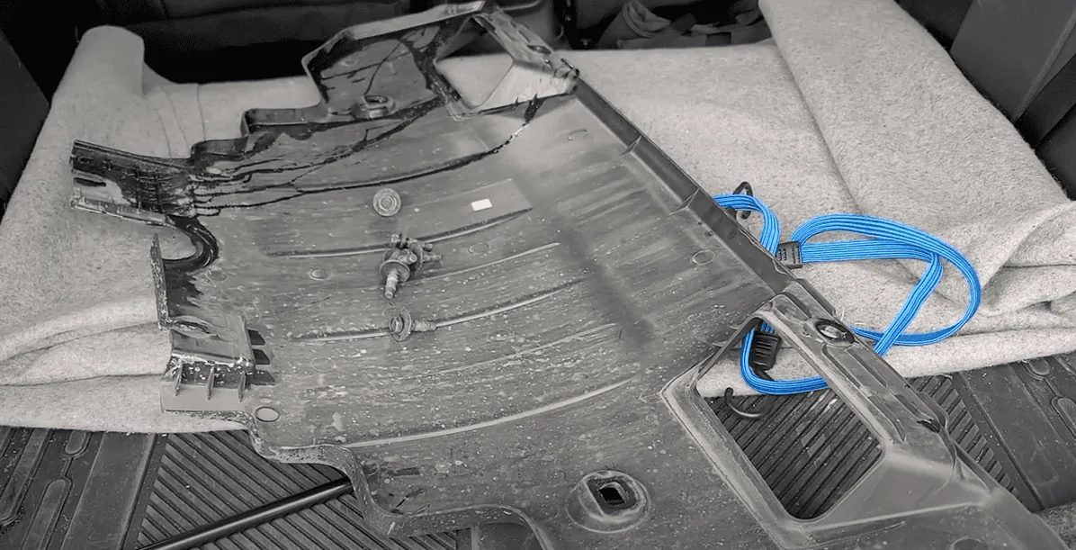

1) Remove the skid plate, 6 bolts, 15mm

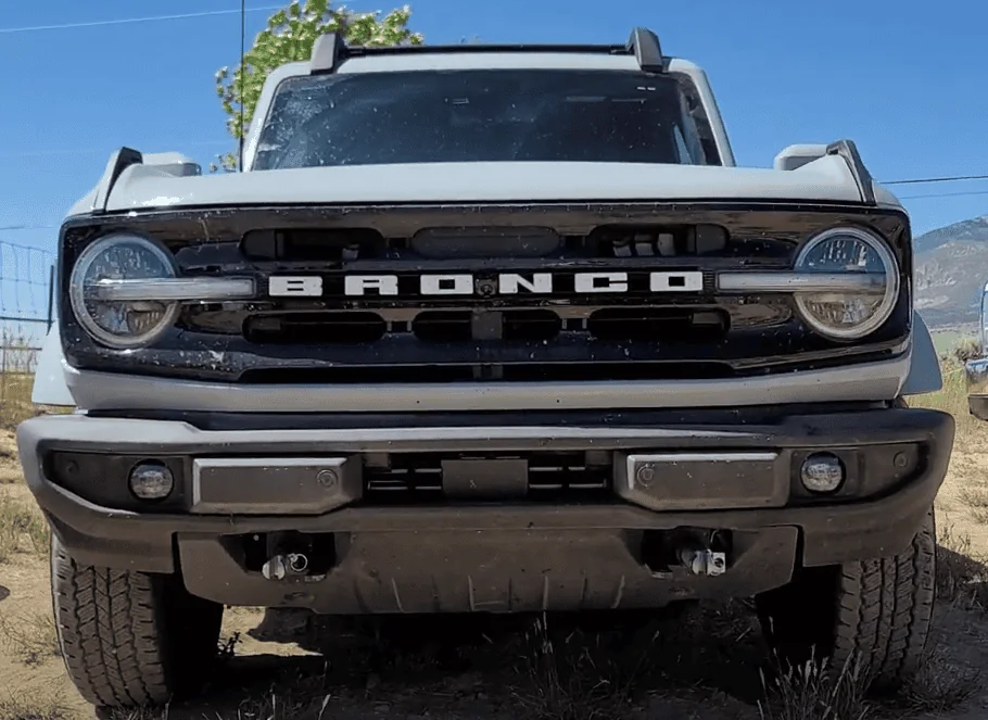

2) Remove tow loops - start with the shrouds, then 2x 15mm bolts. Don't let these fall on you.

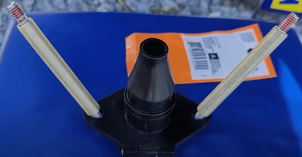

3) Ream these two holes out to 1/2"
Ford Bronco Full Guide: Modifying Bronco 2DR Outer Banks for Flat Towing - Blue Ox adapter plates, braking system, etc 1692050456344

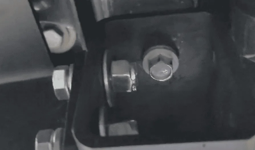

4) Install baseplate using the tow loops' 15 mm bolts & holes. Use red Loctite. Blue Ox rep said "we have no 15mm spec, do between 120-180 ft/lbs". I shot for 120 lbs.
5) Install the mounting brackets using the hardware they provided. This will take the 1/2” diameter and 1 1/2” long bolt. The lockwasher goes right on the bolt, the other side comes out on the inside of the baseplate, and gets secured with a washer and nylon locknut. The instructions say to keep it loose for now.
Ford Bronco Full Guide: Modifying Bronco 2DR Outer Banks for Flat Towing - Blue Ox adapter plates, braking system, etc 1692050827851

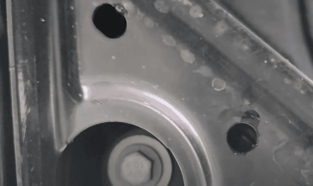

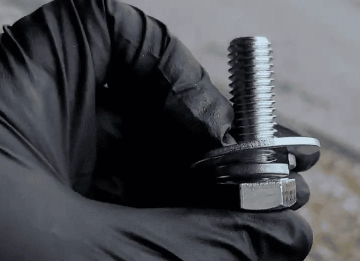

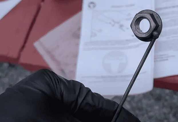

And here's the part that got extremely tricky and frustrating for me. At this time, the instructions say to use the whiz nuts to properly place the nuts above the holes that were reamed out. What happened in actuality though is that the mounting bracket holes didn't line up with the existing holes that I reamed out on the Bronco. The tolerance mismatch was actually pretty bad, off by what seemed like a 1/4”. I also asked Blue Ox about this issue, and they didn't really have much to say, their first assumption was that I ordered the wrong part. I will say that the instructions say this:
“The dimensional variations between otherwise identical vehicles can be considerable. While the baseplate was designed for easy installation, it may be necessary to tailor the baseplate slightly to compensate for vehicle manufacturer’s tolerances.”
In my case that may have been a bit of an understatement, because I wound up having to ream both the mounting bracket AND the Bronco just to make it align. It was not easy, and I didn't really feel good about all this mangling, and I'm sure it voided the warranty. My opinion is that if they are aware of the broad tolerances, then they should have made the holes on the mounting bracket oblong to be more accommodating of this fact.
Ford Bronco Full Guide: Modifying Bronco 2DR Outer Banks for Flat Towing - Blue Ox adapter plates, braking system, etc 1692050875214
I wound up cutting the rods off of the whiz nuts because they were a bigger hindrance to me than a help. I aligned the nuts using the rods and my hands and just eyeballing exactly where the nut was in relation to the mounting hole. These were 1/2” grade 8 bolts, so I torqued them to 119 foot lbs in accordance with the table.

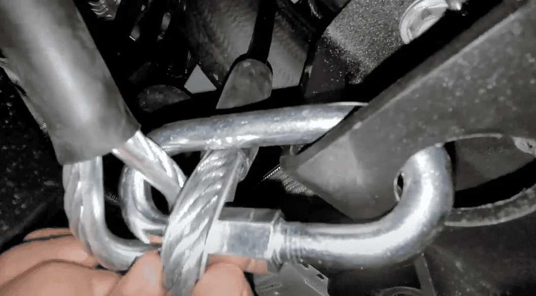

6) Wrap then secure the provided safety cables around the front cross member in such a way as to avoid any rubbing of lines, hoses, and moving parts. Easier said than done.

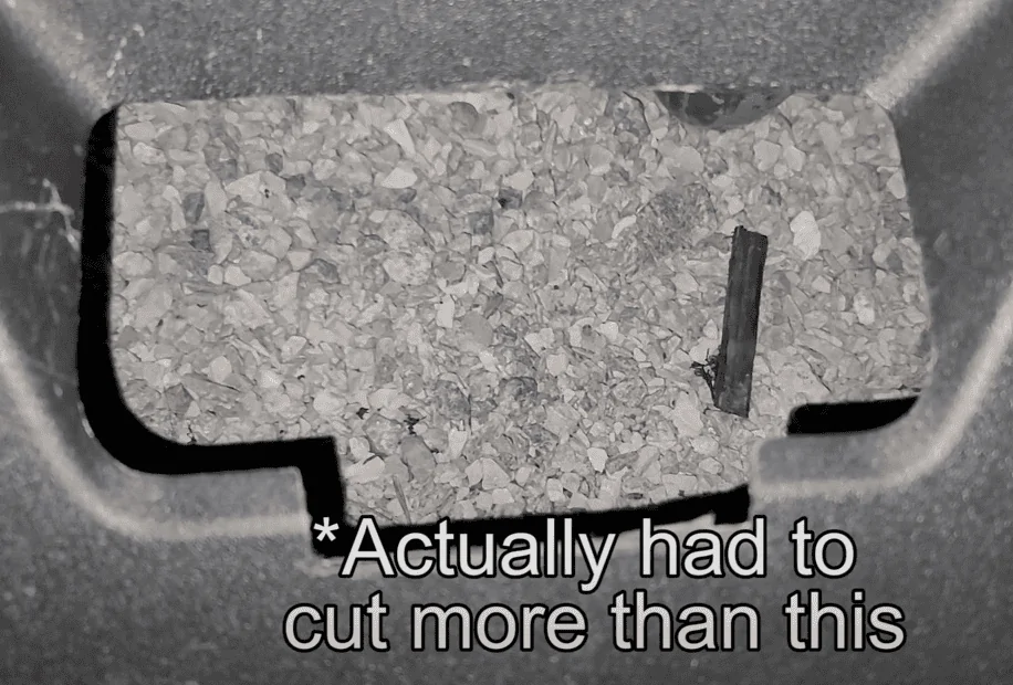

7) Trim your skid plate to accommodate the adapter plates. Then curl up in a ball and cry because Blue Ox is making you mangle an $800 part
Ford Bronco Full Guide: Modifying Bronco 2DR Outer Banks for Flat Towing - Blue Ox adapter plates, braking system, etc 1692051130011
This is what it'll look like now, ignore the breakaway switch:
Ford Bronco Full Guide: Modifying Bronco 2DR Outer Banks for Flat Towing - Blue Ox adapter plates, braking system, etc 1692051195041

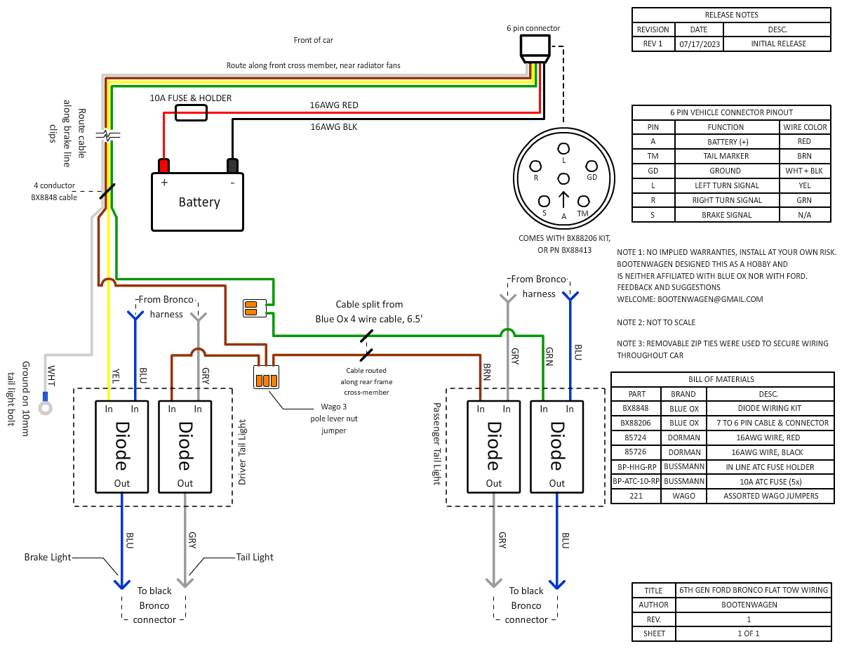

For this, I've drawn up a schematic. There are things of note here that I had to learn the hard way. The first time I towed the Bronco, it nearly killed the battery - both because there is no provided way to charge the battery, but also probably because I forgot to turn the accessory button off. Regardless, I think battery discharge is a real risk. Some on these forums have even mentioned that it may be possible for the transfer case to jump out of neutral and grenade itself if the battery power gets too low. Either way, it's important to give the Bronco an umbilical cord for charging. I accomplished this by tapping the 'A' pin on the 6 pin connector, and wiring it directly to the battery through a 10 amp fuse.
Also of note -- the diodes in the back don't really seem to fit into the tail light housing. I extended the wire lengths so I could tuck them into a crevice behind the tail light.

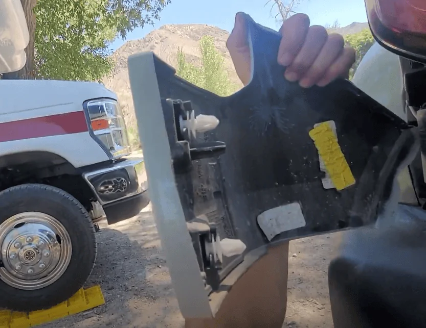

2) Starting with the driver's side. To remove the tail lights, unscrew the 4 plastic push pins. Pop them off with a trim pry bar
3) Pry off the trim pieces beneath the tail light. Be gentle and patient here - it's held on with fairly strong clips. I found it best to undo a few clips of the wheel well, then I pried the trim piece at the wheel well until loose, and finally I pried on the right hand side of the trim piece

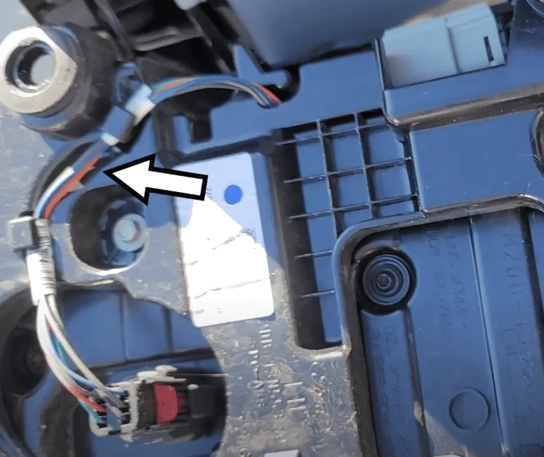

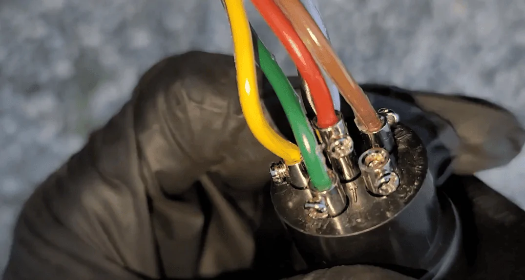

7) Assuming all Broncos are the same, cut the blue and gray wires between the black and grey connectors. Add about 12" of wire to each, so that the diodes can be tucked far away.
8) Collect about 6 feet of green and brown wire from the diode wiring kit, and route that between the passenger and driver's side tail lights. I routed mine along side the rear cross member and tow hitch, liberally using zip ties (see schematic)
9) Route the 4 wire cable through the driver's side tail light opening, and wire per the schematic. I used the 10mm bolt on the side as a grounding bolt. I don't like drilling extra holes into my Bronco.
Ford Bronco Full Guide: Modifying Bronco 2DR Outer Banks for Flat Towing - Blue Ox adapter plates, braking system, etc 1692055457414
10) I routed the other end of the 4 wire cable along side the brake lines, reusing the brake line clips where possible, and using zip ties everywhere else. It then goes up around the front wheel well into the engine bay, and along the front cross member near radiator fans. It's final destination is the passenger side tow adapter plate.
11) Wire the 4 conductor cable to the 6 pin connector per schematic. Simultaneously, using 16awg black and red wire, wire the red to pin A, and the black to the GD ground pin. Slightly janky, but yes, I have now both the white and black wire going into one pin for ground. The red and the black are what is going to be trickle charging the Bronco's battery.

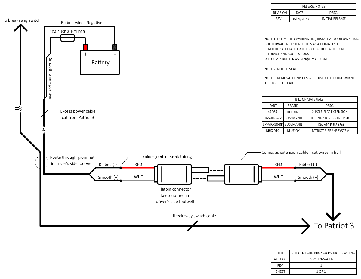

Patriot 3 Braking System Wiring + Neutral Tow mode:
The Patriot 3 comes with a cigarette style plug. Won't work with the Bronco - because the Bronco shuts off accessory power after 45 minutes. I'm pretty sure everything is off altogether as soon as you press the start button. You can either wire an always-on cigarette style outlet and put it somewhere in the footwell, but that is peak janky. I opted to wire a flat pin style connector to the Patriot, and I have the same in the footwell going directly to the battery via grommet and via 10A fuse.

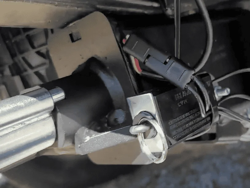

1) I attached the "grenade pin" disconnect switch to the driver's side adapter plate via 1/2" 3/4" length machine bolt, locknut, and blue Loctite. The remainder I secured with a ziptie.
Ford Bronco Full Guide: Modifying Bronco 2DR Outer Banks for Flat Towing - Blue Ox adapter plates, braking system, etc 1692055556968
2) I routed the breakaway switch cable and power cable through a rubber grommet in the driver's side footwell
3) The power cable I connected to the power studs on the battery using a ring terminal. The smooth wire I spliced a fuse holder, and placed a 10A fuse into

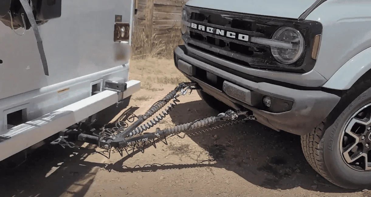

4) With everything wired, the Bronco should be ready to go. At this point you can hook everything up between tow vehicle and the Bronco
-Put the tow bar in (tow bar rating should be 6000 lbs+. I think my 2 door Outer Banks is around 4200-4400 lbs. 4 doors with sasquatch packages are probably north of 5000 lbs.)
-Extend the tow bar on the ground, drive the Bronco over
-Put the pins in on both sides, retain with spring loaded pin
-Attach safety cables
-Attach 7 to 6 pin cable
-Attached breakaway switch cable -- needs to be connected to something sturdy on the tow vehicle

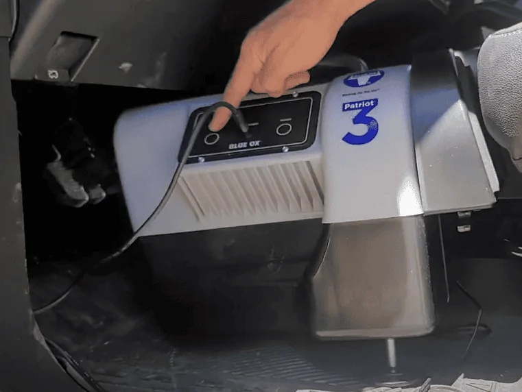

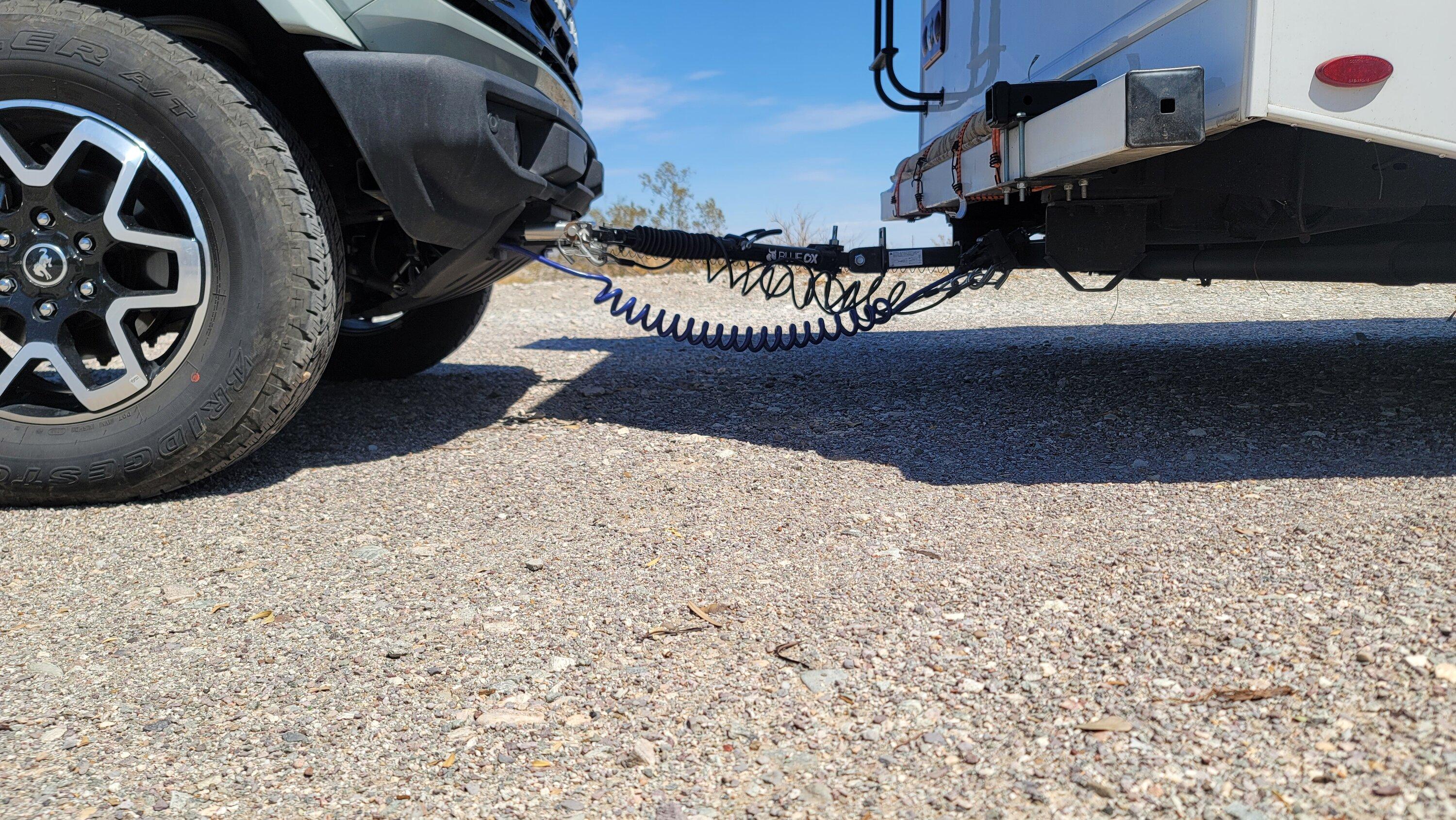

6) Setup the Patriot 3. Make sure the levelling feet clear it of the seat adjustment lever, otherwise it can and will push the seat out of the way when actuating the brake pedal.
Ford Bronco Full Guide: Modifying Bronco 2DR Outer Banks for Flat Towing - Blue Ox adapter plates, braking system, etc 1692055634034
7) I keep the RF controller on my RVs dash, and my settings are at Force: 2 and Sensitivity: 3. This is very low on both ends, because I've had the Patriot fully clamp on the brakes even when I wasn't braking -- I was just going over some rough terrain and that was enough to fool the accelerometer (or whatever) into thinking that I was. Lowering these settings is what Blue Ox recommended to me. Not really ideal - I would prefer it if the Patriot was actuated through the 'S' brake signal, or maybe using an AND gate of 'S' signal and accelerometer, that would probably solve this issue. But since setting it to that, I haven't had any problems, though I do have to manually actuate the brakes using the RF controller more frequently. Best to just drive more defensively.
Patriot 3 braking system wiring:

Here's a link to the diode schematic, and here is a link to the Patriot schematic. Feedback welcome! If anyone finds something that needs correction, let me know and I'll revise!

Nice write up. I too used the Blue Ox base plates but used a RVI 2 Brake and Curt towed wiring. A few notes from mine:
1. Whiz nut deal is a pain. All my holes lined up perfectly and 3 of the whiz nuts worked fine, the fourth, actually the first I tried, took about an hour to get to take.
2. Don't tell anyone but I decided to forego the cables. Each side is held on by four 1/2", more or less, bolts that ultimately depend on one 1/2" bolt on the tow bar.

5) Remove two 8mm bolts, and one 10mm bolt
6) Tail lights should now be loose, dangling by the wiring loom
Ford Bronco Full Guide: Modifying Bronco 2DR Outer Banks for Flat Towing - Blue Ox adapter plates, braking system, etc 1692056202833

14) To mount the 6 pin connector, I used long bolts and Home Depot lighting nipples to create a makeshift standoff. I mounted it to the adapter plate with some drilled holes. This might affect the structural integrity, so it may not be the best option, but it's the one I chose to keep Bronco appearance changes minimal.

13) Route the black and the red to the battery, use the same path as the 4 conductor cable. Wire a 10A fuse and holder to the red wire, a ring terminal to both the red and black, and connect them to the battery. The battery has very handy extra studs just for this sort of thing. Reconnect the battery.
14) At this point, everything should work, so it's a good time to back your RV/tow car to the Bronco and test all the lights via 7 to 6 pin cable. If everything checks out, button the lights back up.

...and forgive me, but you should probably have a riser on that hitch to level out that bar. I'm using a ball type tow bar, partly for that reason. It has a 5000 capacity and I'm just below that. I'm considering an etrailer receiver mount bar that has a rise built in.
1. Yeah lol if I was running a shop, my itemized bill would include a line item for:
-2 HRS LABOR: STRUGGLED WITH WHIZ NUTS ~~~ $160
2. The cables really do seem overkill, there's like 8 points of bolt contact in total, I wonder if those are just there because Blue Ox is worried about our overly litigious society

I think the screenshot I took skewed the angle quite a bit since I was turning. Here's how it sits normally, what do you think?

That photo looks much better. I think most mfgs say no more than 3" rise or drop. Prevents pole vaulting or under riding. Now, is that right front tire low...I can't help myself :unsure:
